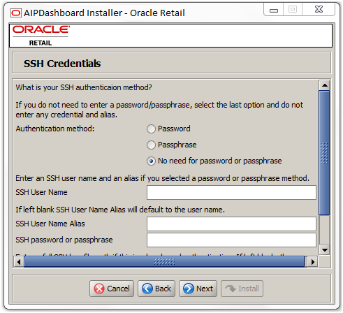

input.ssh.authentication.mode = default
input.ssh.username.alias =
input.ssh.keyfile =

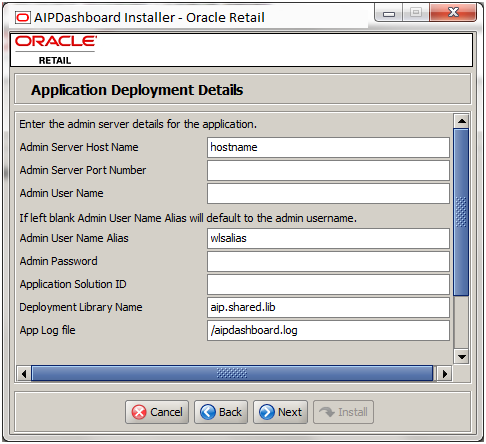

WebLogic Admin Server Information
input.wls.target
Specify the host name where the application server is running.
If the application server is running on the same host as the installer, you may use local host and enter any of the following:

input.admin.port
Specify the port number associated with the administrative server.
input.admin.user
Specify the administrative user name for the application server.

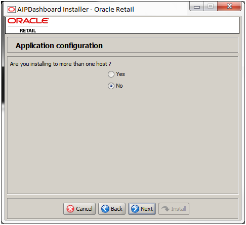

input.is.multiple.hosts
To specify that your domain contains at least one managed server machine that is different from the admin server machine, set the value to yes. If all the managed server machines are on the same machine as the admin server machine, then set the value to no. In other words, even if you have a cluster with multiple managed servers or have multiple standalone managed servers, the value should be no if all of these managed servers are on the same machine as the admin server machine.

input.solution.id
Specify the Solution details for the AIP Dashboard.
This should match the Solution name from the Fusion Client's Foundation.xml file.
For example, input.solution.id = AIP
input.app.name.customlib
Specify the application deployment name. For example: aip.shared.lib.

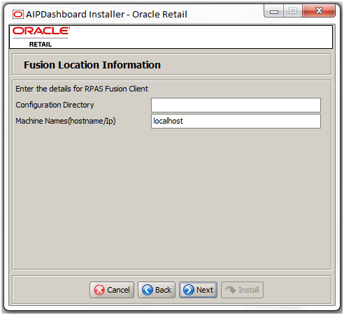

fusion.configpath
Specify the Fusion Client Configuration Directory, where the fusion client configuration files are located.
input.targetMachines
Specify the hostname/IP of the machine where the Fusion Client is installed (comma separated list where the Fusion Client config roots are).

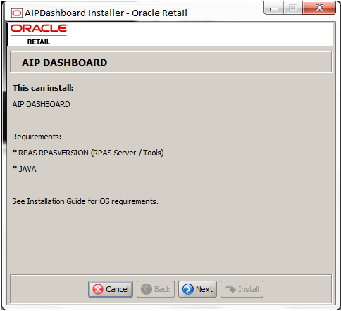

  4. The AIP Dashboard Installer Window opens. Click Next.
    Figure 9-1 AIP Dashboard Installer Window
    Surrounding text describes Figure 9-1 .

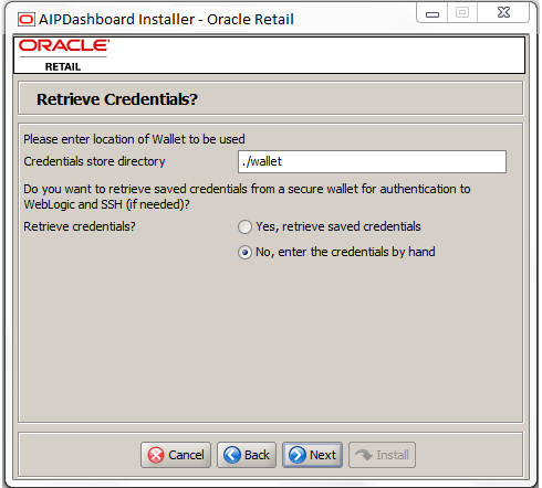

  5. The Retrieve Credentials? Window opens.
    1. In the Credentials store directory text box, specify the location of the Oracle Wallet you want to use to save or retrieve user credentials.
    2. Select whether to retrieve user credentials from the Oracle Wallet:
      Option Description
      Yes, retrieve saved credentials Indicates that the installer will read the user credentials from an Oracle Wallet
      No, enter the credentials by hand Indicates that you will enter the user credentials in the user interface.
    3. Click Next.

    Select No if you want to advance to the next window without testing the connection.
    Application Solution ID Enter the solution ID for AIP that matches the solution name from Fusion Client's Foundation.xml.
    For example: AIP
    Deployment Library Name Enter the deployment library name:
    aip.shared.lib
    App log file Location to create the AIP Dashboard application log.
    Figure 9-3 WebLogic Admin Server Details Window
    Surrounding text describes Figure 9-3 .
  7. The Application Configuration Window opens.
    Specify whether or not you are installing to more than one host:
    Option Description
    Yes This indicates an installation where at least one managed server is running on a remote machine (remote to the admin server machine).
    Go to Step 8.
    No This indicates an installation where all of the managed servers for deploying the Fusion Client are running on the same machine as the admin server machine, or if you are deploying to the admin server only.
    Go to Step 9.
    Figure 9-4 Application Configuration Window
    Surrounding text describes Figure 9-4 .
  8. If you selected Yes on the Application Configuration Window, then the SSH Credentials Window opens, otherwise continue to Step 9
    Enter the relevant information in the following fields and click Next:
    Field Description
    Authentication method Select one of the following authentication methods:
    • Password — Use the specified password (associated with the SSH User Name) to connect to the remote hosts for copying the files.
    • Passphrase — Use the specified passphrase (associated with the SSH User Name) along with the SSH Key to connect to the remote hosts.
    • No need for password or passphrase — Default option; connect to the remote hosts without a user name, password, or passphrase.
    SSH User Name Specify the SSH user name to connect to the remote hosts.
    SSH User Name Alias Specify the alias name associated with the SSH user name. Specifying an alias name enhances the security for the application. When left blank, the alias name will default to the administrative user name.
    SSH password or passphrase Based on the authentication method you selected, enter the relevant SSH password or passphrase.
    SSH Key File Path In case you selected the Passphrase option in the Authentication Method field, enter the location of the SSH key file.
    When left blank, the installer will retrieve the file from ${user.home}/.ssh/id_dsa directory, where user.home is your home directory. To use this default location, ensure that you have the private DSA key stored at this location.
    Figure 9-5 SSH Credentials Window
    Surrounding text describes Figure 9-5 .

  11. The Fusion Location Information Window opens. Enter relevant information for the following fields and click Next:
    Field Description
    Configuration Directory Specify the location where the RPAS Fusion Client is installed.
    Machine Names (hostname/Ip) Enter the hostname/IP of the machine where Fusion Client is installed.
    Figure 9-8 Fusion Location Information Window
    Surrounding text describes Figure 9-8 .

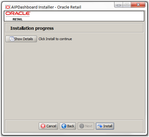

  13. The Installation Progress Window opens. To start the installation, click Install.
    If the AIP Dashboard has already been installed with the Fusion Client and you are reinstalling the AIP Dashboard, you need to stop the Fusion Client application first from the WebLogic console before running the AIP Dashboard installer.
    Figure 9-10 Installation Progress Window
    Surrounding text describes Figure 9-10 .

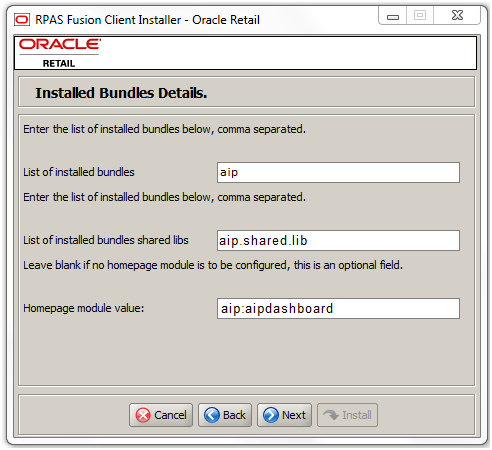

After the AIP Dashboard installation is complete, the RPAS Fusion Client must be re-installed with the same properties used during the initial install, except providing values for the following three properties:
  • List of bundles
  • List of shared libraries
  • Homepage module value
    These properties are found in the RPAS Fusion Client Installer, Installed Bundles Details Window
Edit the ant.install.properties file using any text editor and set
  • input.installed.bundles = aip
  • input.installed.bundles.shared.libs = aip.shared.lib
  • input.homepage.module = aip:aipdashboard
Where aip.shared.lib is the same value as input.app.name.customlib in the AIP Dashboard installer.
Figure 9-11 Installed Bundles Details Window
Surrounding text describes Figure 9-11 .
