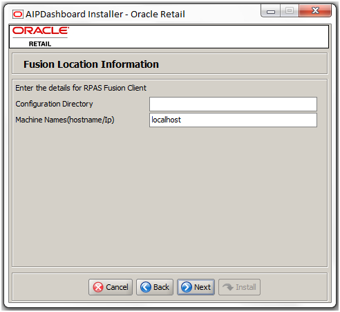

RPAS Fusion Client |
fusion.configpath |
Specify the Fusion Client Configuration Directory, where the fusion client configuration files are located. |
input.targetMachines |
Specify the hostname/IP of the machine where the Fusion Client is installed (comma separated list where the Fusion Client config roots are). |

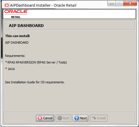

When the installer runs, it attempts to validate the version of WebLogic and the associated Oracle Application Development Framework that are used by the WebLogic domain. If you encounter a validation error, fix the problem and try again.
The AIP Dashboard Installer Window opens. Click Next.

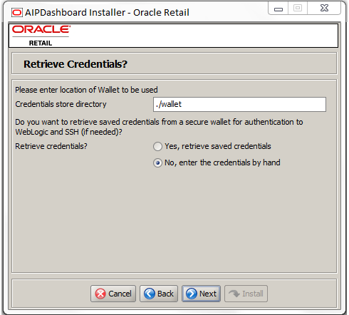

The Retrieve Credentials? Window opens.
In the Credentials store directory text box, specify the location of the Oracle Wallet you want to use to save or retrieve user credentials.
Select whether to retrieve user credentials from the Oracle Wallet:
| Option | Description |
| Yes, retrieve saved credentials | Indicates that the installer will read the user credentials from an Oracle Wallet |
| No, enter the credentials by hand | Indicates that you will enter the user credentials in the user interface. |
Click Next.

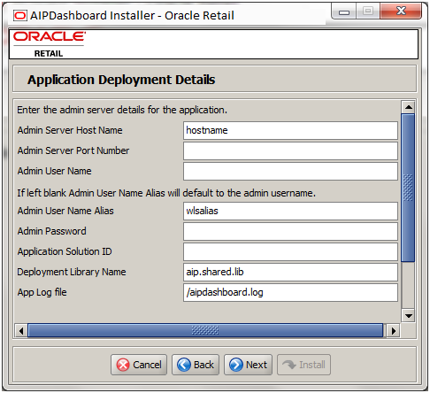

The WebLogic Admin Server Details Window opens. Enter appropriate information for the following fields and click Next:
| Field | Description |
| Admin Server Host Name | Specify the host name of the application server. |
| Admin Server Port Number | Specify the port number associated with the admin server of application server. |
| Admin User Name | Specify the administrative user name for the application server. |
| Admin User Name Alias | Specify an alias name for the administrative user. Specifying this name enhances the security for the application. When left blank, the alias name defaults to the administrative user name. |
| Admin Password | Specify the password associated with administrative user name. |
| Test admin server connection? | Select Yes if you want to test the connection to the admin server.
Select No if you want to advance to the next window without testing the connection. |
| Application Solution ID | Enter the solution ID for AIP that matches the solution name from Fusion Client's Foundation.xml.
For example: |
| Deployment Library Name | Enter the deployment library name:
| App log file | Location to create the AIP Dashboard application log. |

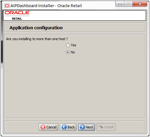

The Application Configuration Window opens.
Specify whether or not you are installing to more than one host:
| Yes | This indicates an installation where at least one managed server is running on a remote machine (remote to the admin server machine).
Go to Step 8. |
| No | This indicates an installation where all of the managed servers for deploying the Fusion Client are running on the same machine as the admin server machine, or if you are deploying to the admin server only.
Go to Step 9. |

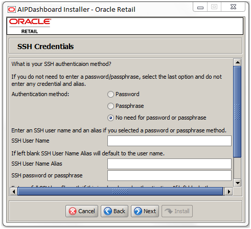

If you selected Yes on the Application Configuration Window, then the SSH Credentials Window opens, otherwise continue to Step 9
Enter the relevant information in the following fields and click Next:
| Authentication method | Select one of the following authentication methods:
| SSH User Name | Specify the SSH user name to connect to the remote hosts. |
| SSH User Name Alias | Specify the alias name associated with the SSH user name. Specifying an alias name enhances the security for the application. When left blank, the alias name will default to the administrative user name. |
| SSH password or passphrase | Based on the authentication method you selected, enter the relevant SSH password or passphrase. |
| SSH Key File Path | In case you selected the Passphrase option in the Authentication Method field, enter the location of the SSH key file.
When left blank, the installer will retrieve the file from ${user.home}/.ssh/id_dsa directory, where user.home is your home directory. To use this default location, ensure that you have the private DSA key stored at this location. |

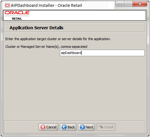

The Application Server Details Window opens. Enter relevant information for the following fields and click Next:
| Cluster or Managed Server Name(s), comma-separated | Enter the cluster or managed server names where you want to deploy the AIP Dashboard. It should be the same managed server as the Fusion Client. |

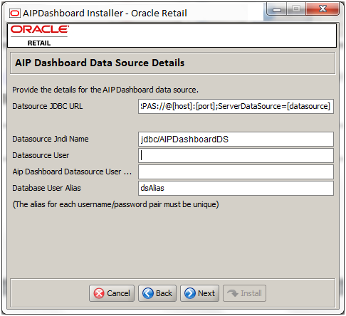

The Application Data Source Details Window opens. Enter relevant information for the following fields and click Next:
| Datasource JDBC URL | Enter the JDBC URL in the format:
| Datasource Jndi Name | Enter the JNDI name.
For example, |
| Datasource Schema user | Enter the datasource user name user name. |
| Dashboard Datasource Password | Enter the password for the datasource user name. |
| Database User Security Alias | Enter the security alias for datasource user. |
The Fusion Location Information Window opens. Enter relevant information for the following fields and click Next:
| Configuration Directory | Specify the location where the RPAS Fusion Client is installed. |
| Machine Names (hostname/Ip) | Enter the hostname/IP of the machine where Fusion Client is installed. |

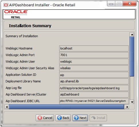

The Installation Summary Window opens. Review the installation summary and click Next.

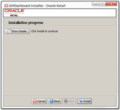

The Installation Progress Window opens. To start the installation, click Install.
Note: If the AIP Dashboard has already been installed with the Fusion Client and you are reinstalling the AIP Dashboard, you need to stop the Fusion Client application first from the WebLogic console before running the AIP Dashboard installer. |

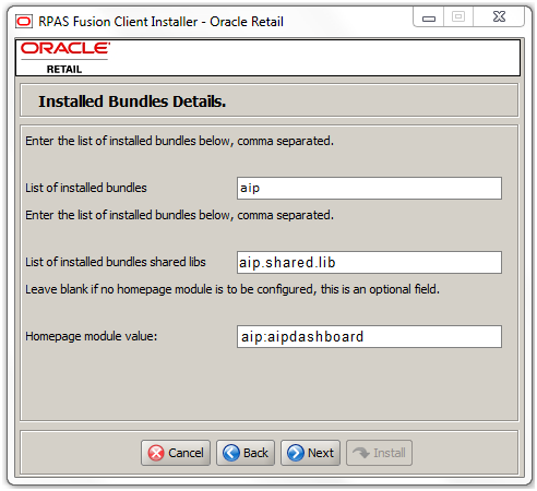

After the AIP Dashboard installation is complete, the RPAS Fusion Client must be re-installed with the same properties used during the initial install, except providing values for the following three properties:
List of bundles
List of shared libraries
Homepage module value
Note: These properties are found in the RPAS Fusion Client Installer, Installed Bundles Details Window |
