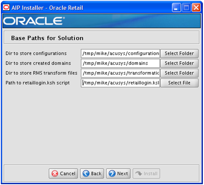

  7. The Base Paths for Solution Window opens.
    Enter the path information as listed in Table 8-1 and then click Next to continue to the Domain Installation Paths Window.
    Figure 8-4 Base Paths for Solution Window
    Surrounding text describes Figure 8-4 .
    Ensure that the installation paths are located outside of the installer directory [AIP_Installer].
    Table 8-1 Path Information for the Base Paths for Solution Window
    Path Information Description
    Dir to store configurations
    Enter the target directory for your configurations, or click Select Folder to navigate to the appropriate location. This is the path that will be assigned to the environment variable $AIP_INSTALL.
    Dir to store created domains
    Enter the target directory for the domains that will be created by the AIP Installer, or click Select Folder to navigate to the appropriate location.
    Dir to store RMS transform files
    Enter the target directory for the RMS transformation files used by AIP, or click Select Folder to navigate to the appropriate location.
    Path to retaillogin.ksh script
    Enter the target path where the retaillogin.ksh file resides on your system, or click Select File to navigate to and select the retaillogin.ksh file. The retaillogin.ksh script was created during RPAS installation. The path must include the filename retaillogin.ksh.

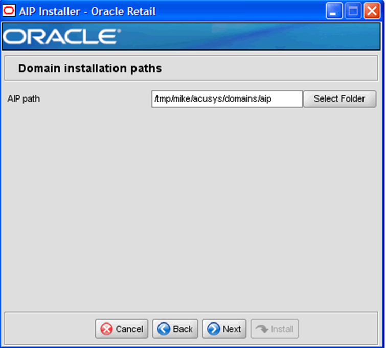

  8. The Domain Installation Paths Window opens.
    Enter the path where your AIP domain will be installed, or click Select Folder to navigate to the appropriate location. Click Next to continue to the Install Tasks Window.
    Figure 8-5 Domain Installation Paths Window
    Surrounding text describes Figure 8-5 .

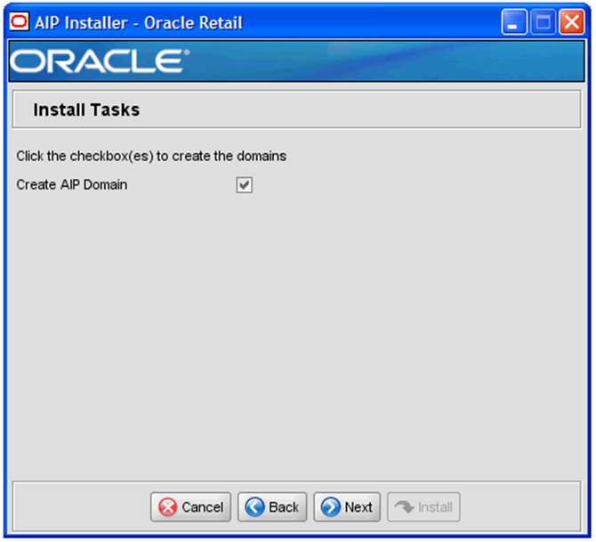

  9. The Install Tasks Window opens. Perform the steps following Figure 8-6 to continue.
    Figure 8-6 Install Tasks Window
    Surrounding text describes Figure 8-6 .
    To Create the... Then... And...
    AIP domain now choose the Create AIP Domain option click Next to continue to the Installation Progress Window.
    AIP domain later clear the Create AIP Domain option click Next to continue to the Installation Progress Window.
    The domain build created during this installation will contain sample hierarchy positions. If you want your AIP RPAS domain to be created with your production hierarchy data, then clear the Create AIP Domain option and continue withl the installation. Refer to the Oracle Retail Advanced Inventory Planning Implementation Guide, chapter ”Building a Production AIP RPAS Domain.”
    Created as part of this process is the make_domain.aip file located in the [Configurations Install Dir] entered during the install. This file contains all of the required parameters needed to support the domain install. If necessary this file may be modified if the default parameters are not appropriate for your particular environment.
    This release of the AIP RPAS configuration is enabled for multi-language capability as a default. This means that the domain build will set up positions in the database arrays into which translated strings may be optionally loaded by the domain administrator at a later time. See the Oracle Retail Application Server Administration Guide for details.

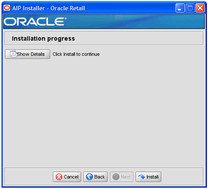

  12. The Installation Progress Window opens.
    To display the progress of the components and tasks being performed by the AIP Installer, select Show Details. Click Install to start the installation process.
    Figure 8-9 Installation Progress Window
    Surrounding text describes Figure 8-9 .
