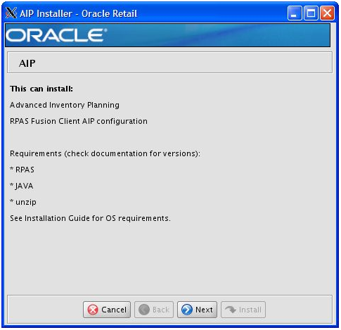

  3. The AIP Installer Window opens and displays the AIP requirements, which you should already have installed. If you have not installed these items, perform the necessary installations before continuing.
    Click Next to continue.

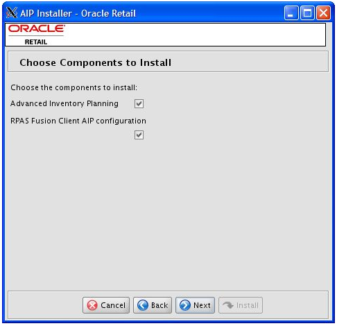

  4. The Choose Components to Install Window opens.
    Select one or both of the following options:
    • Advanced Inventory Planning– Select this option to install the Advanced Inventory Planning solution with the domain.
    • RPAS Fusion Client AIP configuration – Select this option to install the RPAS Fusion Client AIP configuration.
    If You Are... Then...
    Not installing the RPAS Fusion Client AIP configuration. Clear the RPAS Fusion Client AIP configuration check box and skip Steps 8 and 9.
    Not installing the AIP solution, but are installing the RPAS Fusion Client AIP configuration.
    1. Clear the Advance Inventory Planning check box and select the RPAS Fusion Client AIP configuration check box.
    2. After installation, you must update the domain-path entry in the ProfileList.xml on the RPAS Fusion Client server.
    3. In the ProfileList.xml, change ${input.aip.dir} to your AIP domain path.

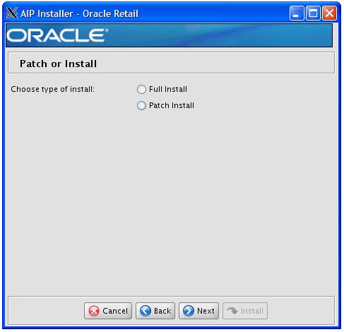

  5. The Patch or Install Window opens.
    Select Patch Install to install AIP when you have a pre-existing environment. Click Next to continue to the Patching Details Window.
    Figure 7-3 Patch or Install Window
    Surrounding text describes Figure 7-3 .

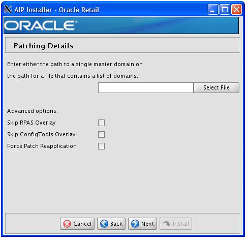

  6. The Patching Details Window opens and allows you to set the path to your domains and select installation options which performs a patch installation over an existing AIP installation and any existing AIP domains.
    Enter the path in the Select File box, select any options as shown in Table 7-1 and click Next to continue to the Installation Progress Window.
    Figure 7-4 Patching Details Window
    Surrounding text describes Figure 7-4 .
    Table 7-1 Patching Details Fields
    Patching Details Fields Description
    Select File box
    Enter the absolute path to a master domain or an absolute path to a file that contains a domain list.
    Skip RPAS Overlay
    When checked, patching skips the RPAS_HOME overlay application.
    Skip ConfigTools Overlay
    When checked, patching skips the RIDE_HOME overlay application.
    Force Patch Reapplication
    Select this check box when you are reapplying this patch.

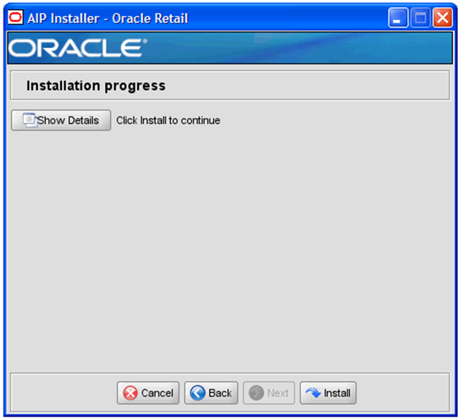

  7. The Installation Progress Window opens.
    To display the progress of the components and tasks being performed by the AIP Installer, click Show Details. Click Install to start the installation process.
    Figure 7-5 Installation Progress Window
    Surrounding text describes Figure 7-5 .

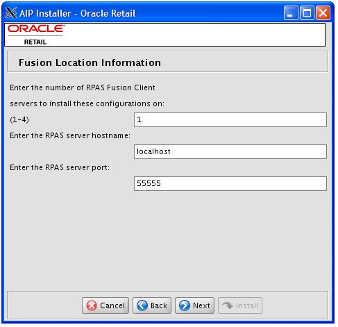

  8. The Fusion Location Information Window opens.
    • Enter the number of servers running the RPAS Fusion Client where you want to install the RPAS Fusion Client AIP configuration. If the RPAS Fusion Client is running on a single server, enter 1. If you have a clustered installation, you can enter up to four servers.
    • Enter the host name and port number of the RPAS server.
    The Fusion Location Information screens open when you select the RPAS Fusion Client configuration check box on the Choose Components to Install Window.
    If you are not installing the RPAS Fusion Client configuration, proceed to step 10.
    Figure 7-6 Fusion Location Information Window
    Surrounding text describes Figure 7-6 .

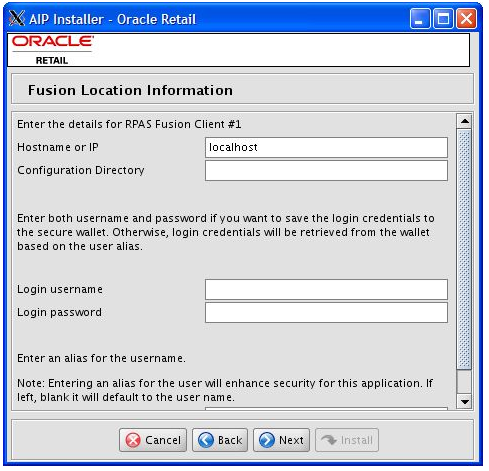

  9. Based on the number of servers you entered, the Fusion Location Information Window opens with the following set of fields for each server configuration:
    • Hostname or IP – enter the host name or IP address of the server where the RPAS Fusion Client is installed.
    • Configuration Directory – enter the location of the config directory available at the location where the RPAS Fusion Client is installed.
    • Login username – enter the user name to log on to the server where the RPAS Fusion Client is installed.
    • Login password – enter the password associated with the user name.
    • Login username alias – specify an alias name for the administrative user. Specifying an alias name for the administrative user enhances the security for the application. When left blank, the alias name defaults to the administrative user name.
    Figure 7-7 Fusion Location Information Window
    Surrounding text describes Figure 7-7 .
    Information such as user credentials for the RPAS Fusion Client is encrypted and stored in a secure location in the application installation directory. This location is called the Oracle Wallet.

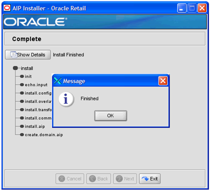

  10. When the installation process is complete, the Complete Window opens with a Message dialog box.
    The installation process can vary depending on your environment. Installation time might take 30 to 60 or more minutes, depending on your server.
    Figure 7-8 Complete Window
    Surrounding text describes Figure 7-8 .
  11. Click OK to close the dialog box.
  12. Review the installation details.
    To view the installation details, select Show Details. The window displays two tabs:
    • Output
    • Error
    It is recommended that you review these tabs for any issues that may have occurred during the installation process.
    If you wish to view the log again at a later date, a text copy was saved in the directory[AIP_Installer]. The log file will be named based on the product, aip, and a timestamp, followed by the .log extension.
  13. Click Exit to close the AIP Installer window.
