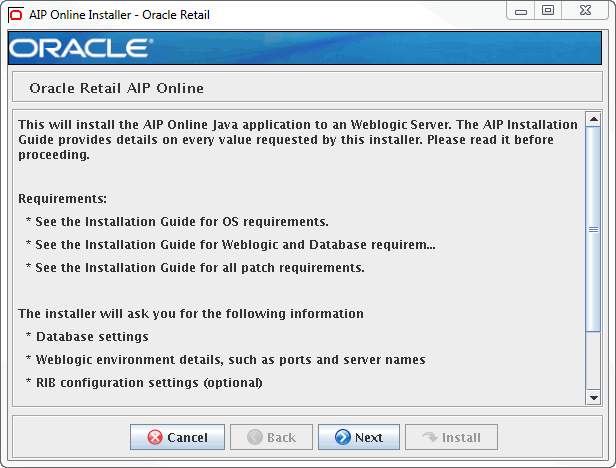

The AIP Oracle Installer Window opens and displays the components that will be installed during installation process, as well as the required components. Click Next to continue to the Data Source Details Window.

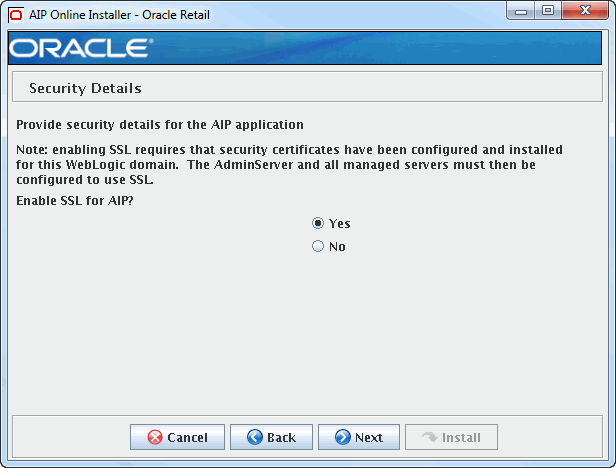

The Security Details Window opens. Indicate whether or not you would like to enable SSL for AIP and then click Next to continue to the JDBC Security Details Window.

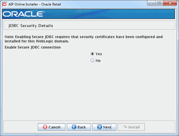

The JDBC Security Details Window opens. Indicate whether or not you would like to enable a secure JDBC connection for AIP and then click Next to continue to the Data Source Details Window.

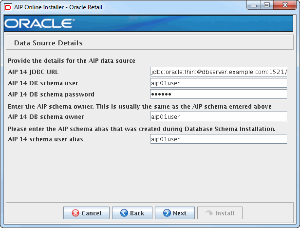

The Data Source Details Window opens. Enter the information as shown in the following table and then click Next.
If you selected Yes in the JDBC Security Details Window, continue to the Secure Data Source Details WindowIf you selected No, continue to the WebLogic Administration Window.
| Field | Description |
| AIP JDBC URL | Enter the path for the JDBC connection, |
| AIP DB schema user | Enter the AIP database schema user name. |
| AIP DB schema password | Enter the AIP database schema password. |
| Enter the AIP schema owner | Enter the AIP database schema owner which is typically the same as the AIP DB schema user. |
| Enter the AIP schema alias | Enter the AIP database schema alias. This is used to securely store the username/password in a wallet file. |

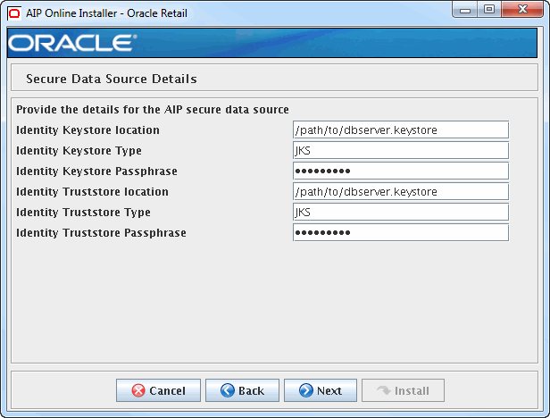

The Secure Data Source Details Window opens. Enter the information as shown in the following table and then click Next to continue to the WebLogic Administration Window.
| Identity Keystore location | Location or path where identity keystore file is stored. |
| Identity Keystore type | The type of the keystore used. For example, JKS |
| Identity Keystore Passphrase | The password for the Identity Keystore. |
| Identity Truststore location | The path of the keystore which contains the SSL root and optionally intermediate certificates as obtained from the certificate authority |
| Identity Truststore type | The type of the truststore used. For example, JKS |
| Identity Truststore Passphrase | The password for the Identity Truststore. |

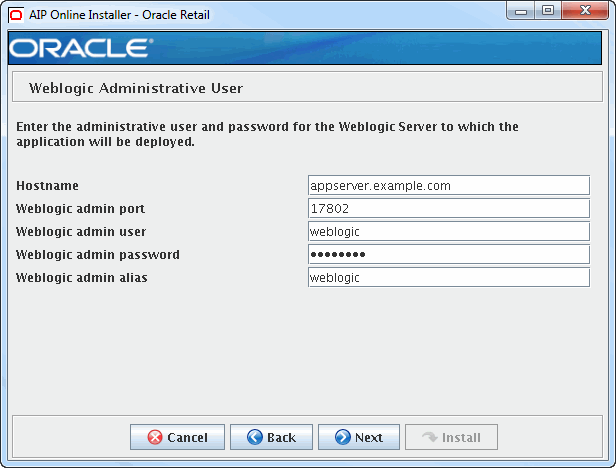

The WebLogic Administration Window opens. Enter the information as described in Table 5-1 and click Next to continue to the Application Deployment Details Window.
Table 5-1 WebLogic Administration Fields
Hostname |
Hostname of the server where the AIP weblogic admin server is running. |
WebLogic admin port |
Enter the WebLogic admin port found in $WEBLOGIC_DOMAIN_HOME/config/config.xml file. Example of Port Definitions in config.xml File:
WebLogic admin user |
Enter the WebLogic admin user name. |
WebLogic admin password |
Enter the WebLogic admin user password. |
WebLogic admin alias |
This is the alias for the WebLogic username/password to store in the wallet file during installation. |

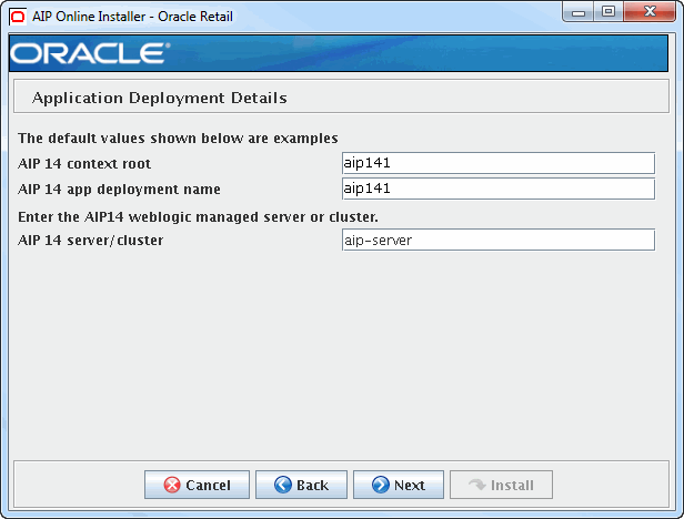

The Application Deployment Details Window opens.
Enter the information as described in Table 5-2 and click Next to continue to the AIP Oracle Installation Directory Window.
Table 5-2 Application Deployment Details Window Fields
AIP 14 context Root |
Enter the context root that the application will use. Example:
where aip141 represents the context root required for this field. |
AIP 14 app deployment name |
Enter the name to be used by the application server to identify the AIP Oracle application. |
AIP 14 server/cluster |
The managed server or cluster to which AIP deploys. |

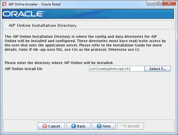

The AIP Oracle Installation Directory Window opens.
Enter the directory where AIP Oracle will be installed and click Next to continue to the AIP Oracle Integration Window.

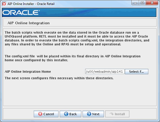

The AIP Oracle Integration Window opens.
Enter the directory where AIP Oracle Integration components are to be installed and click Next to continue to the AIP Online Integration Install Window.
The AIP Oracle Integration Home field defaults to the value of the AIP Online Install Dir field from the AIP Oracle Installation Directory Window.
You may choose to install the integration components to another location on the same server at this point, or you may choose to move the installed files once the installation process is complete.

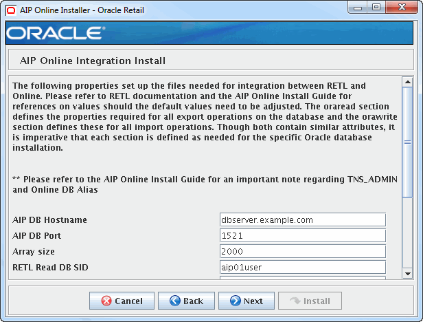

The AIP Online Integration Install Window opens. Complete all the AIP Integration Install fields and click Next to continue to AIP Online RIB Enable Window.
Note: Refer to the Oracle Retail Advanced Inventory Planning Online Implementation Guide as well as the Oracle Retail Extract, Transform, and Load (RETL) Installation Guide for further details on the AIP Integration Install fields. |

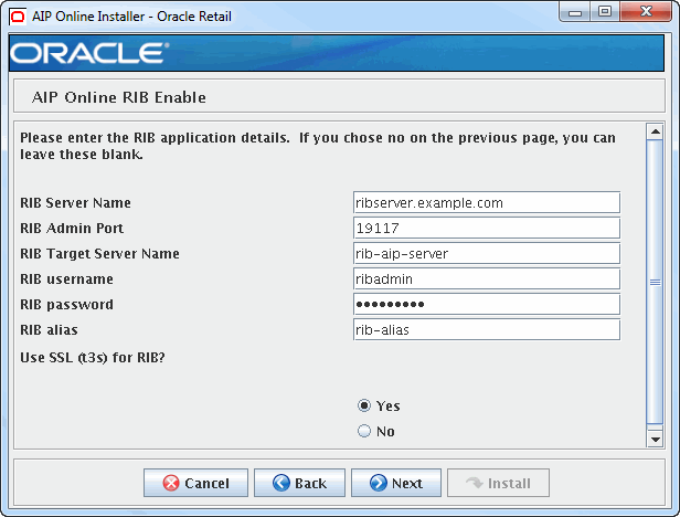

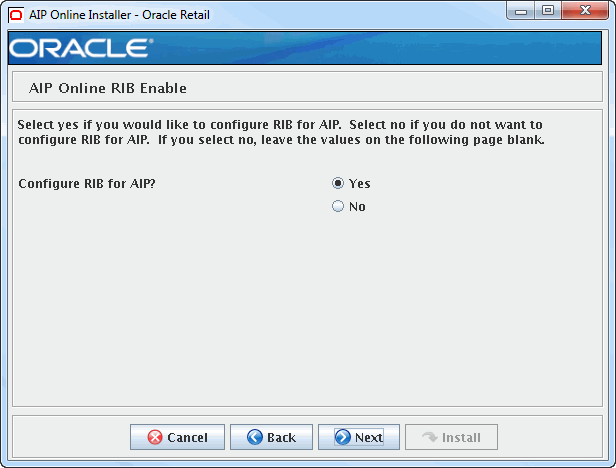

The AIP Online RIB Enable Window opens.
Indicate whether or not you would like to configure RIB for AIP at this point in time. If you do not, refer to the Oracle Retail Advanced Inventory Planning Operations Guide in manually configuring RIB for AIP.
If you select Yes, click Next to continue to the AIP Online RIB Enable Details Window. If you select No, click Next to continue to the Installation Summary Window.
Note: Disregard the screen directions to leave the values blank on the following page if you select No. If you select No and click Next, you continue to the Installation Summary Window. |
The AIP Online RIB Enable Details Window opens. If you selected No on the previous AIP Online RIB Enable Window, leave these values blank. If you selected Yes, then enter the RIB application details and then click Next to continue to the Installation Summary Window.

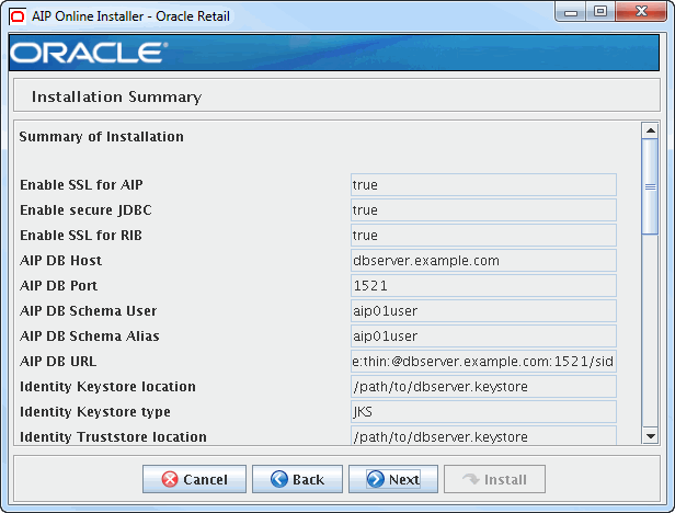

The Installation Summary Window opens. Verify the values and then click Next to continue to Installation Progress Window.

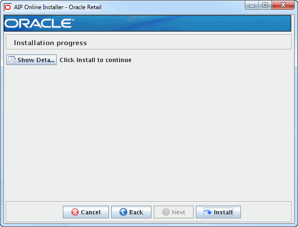

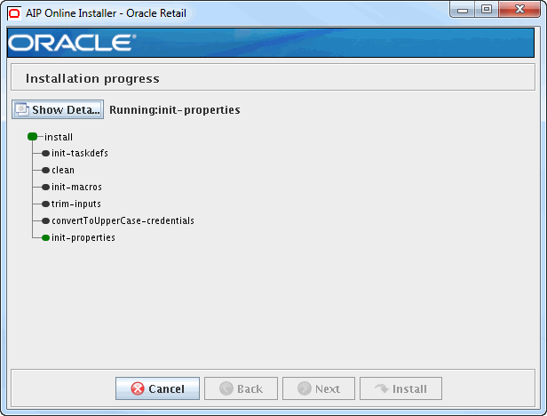

The Installation Progress Window opens.
Once you are ready to begin installation, click Install to continue to the Installation Progress Details Window.
The Installation Progress Details Window opens.
This window displays the progress of the installation routine. Click Show Details to view the log output as the installation is performed. If you do not select to view the details, a graphical representation of the installation steps appears.
You can toggle between detailed mode at any time during or after the installation.
When the installation has finished, the Finished Pop-up Window opens. Click OK to close the pop-up and open the Complete Window.

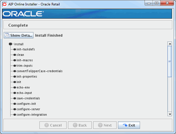

The Complete Window opens. To view the installation details, click Show Details. The window displays two tabs:
Output
Errors
It is recommended that you review these tabs for any issues that may have occurred during the installation process.
