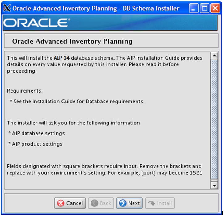

The Oracle Advanced Inventory Planning - DB Schema Installer Window opens and displays the components that are installed during installation process, as well as the required components. Click Next to continue.

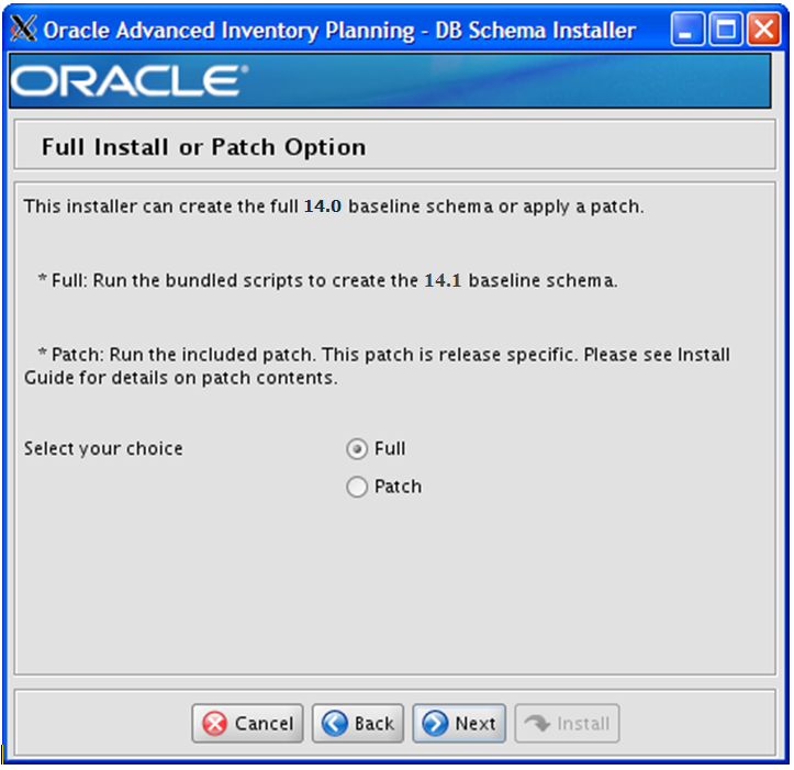

The Full Install or Patch Option Window opens. Choose either the Full or Patch option. Click Next to continue.
Note: The patch install option should only be chosen when upgrading from AIP release 13.2.3 or later to the 14.1.1 release. The full install option should be chosen when there is no previous AIP release already installed. |

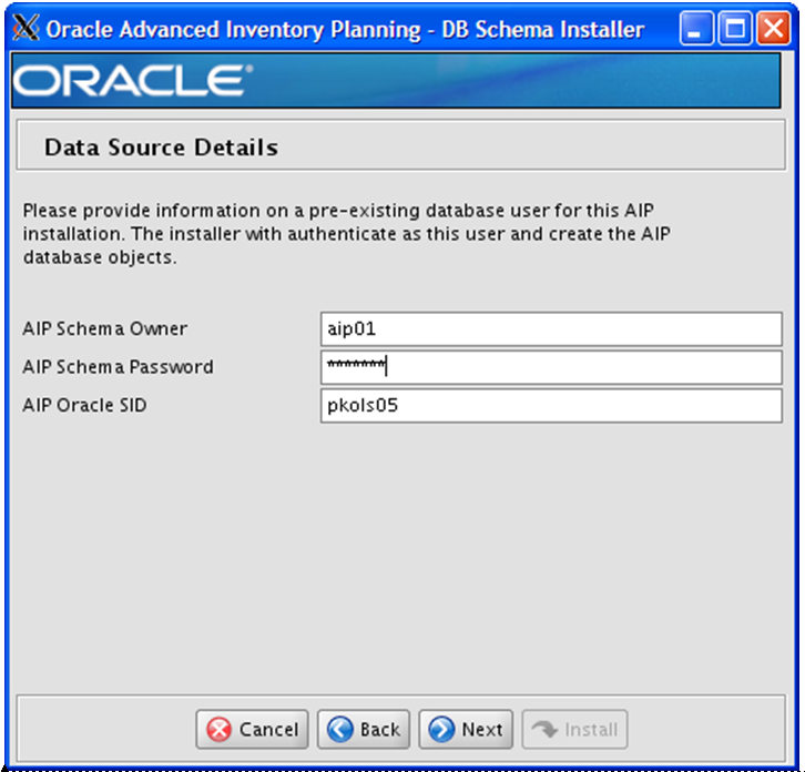

The Data Source Details Window opens. Enter the information described in Table 4-1 and click Next.

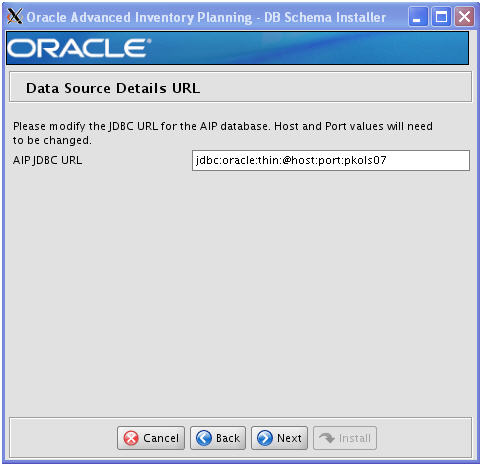

If running the Full Install, the Data Source Details URL Window opens. Enter the AIP JDBC URL and click Next.
This is the URL that is used by AIP to access the database. The expected format for the field is shown.

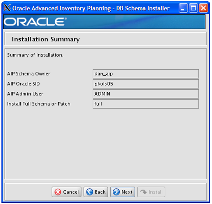

The Installation Summary Window opens. Click Next to continue.

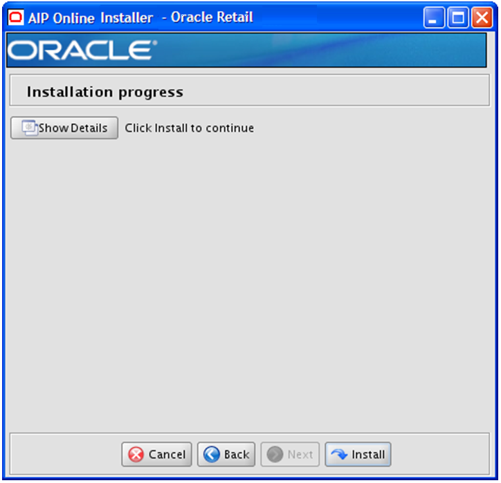

The Installation Progress Window opens. Once you are ready to begin the installation, click Install. This window displays the progress of the installation routine.
Note: The installation log may include PL/SQL compilation warnings where dependencies have not yet been installed. These warnings are expected and all PL/SQL is automatically recompiled at the end of the installation process. |
Click Show Details to view the log output as the installation is performed. If you do not choose to view the details, a graphical representation of the installation steps appears. You can toggle between detailed mode at any time during or after the installation.

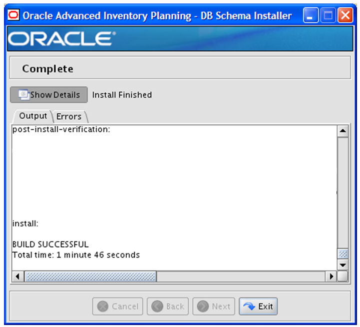

When the installation has finished, the Complete Window opens.
To view the installation details, select Show Details. The window displays two tabs, Output and Errors.
It is recommended that you review these tabs for any issues that may have occurred during the installation process.
