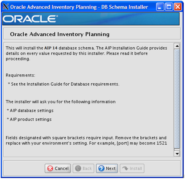

  3. The Oracle Advanced Inventory Planning - DB Schema Installer Window opens and displays the components that are installed during installation process, as well as the required components. Click Next to continue.
    Figure 4-1 Oracle Advanced Inventory Planning - DB Schema Installer Window

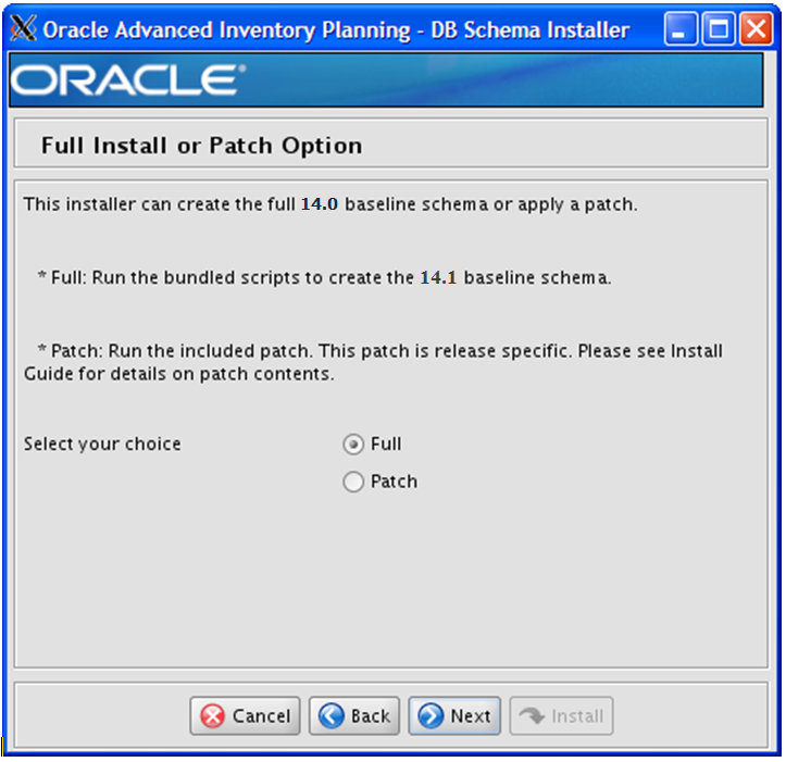

  4. The Full Install or Patch Option Window opens. Choose either the Full or Patch option. Click Next to continue.
    The patch install option should only be chosen when upgrading from AIP release 13.2.3 or later to the 14.1.2 release. The full install option should be chosen when there is no previous AIP release already installed.

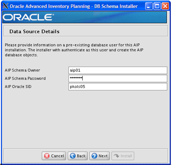

  5. The Data Source Details Window opens. Enter the information described in Table 4-1 and click Next.
    Table 4-1 Data Source Details Window Fields
    Field Description
    AIP Schema Owner
    Enter the AIP Schema owner's name.
    AIP Schema Password
    Enter the AIP Schema Owner's password.
    AIP Oracle SID
    Enter the name of the database where the AIP schema will be installed.

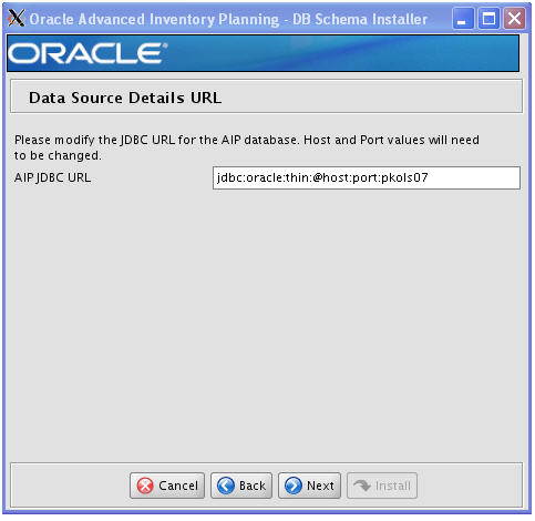

  6. If running the Full Install, the Data Source Details URL Window opens. Enter the AIP JDBC URL and click Next.
    This is the URL that is used by AIP to access the database. The expected format for the field is shown.
    If you are using an HP 64-bit or a Sun 64-bit server, you must specify the AIP JDBC URL to use the thin driver.
    If the Oracle DB 12c is configured as plugable database where the service name is used instead of the SID, then the connection string should be like this example:
    jdbc:oracle:thin:host:port/POLSP02APP

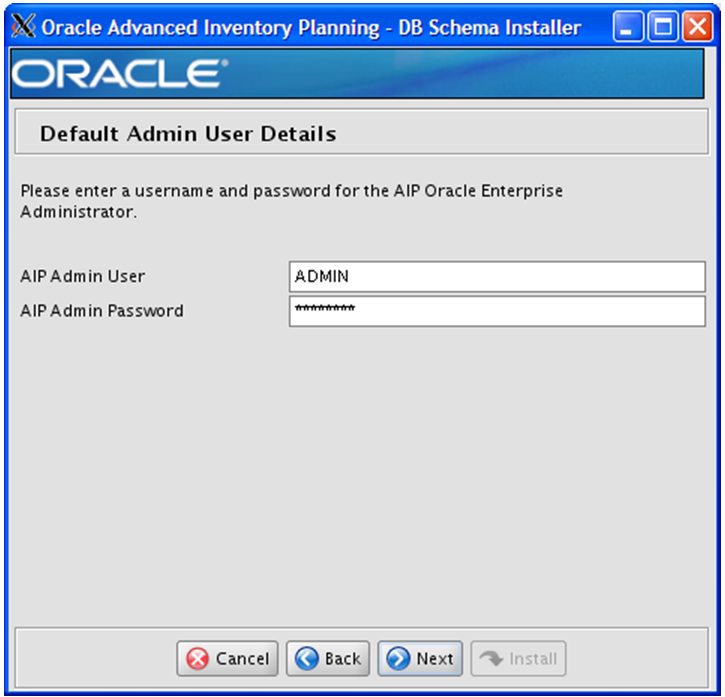

  7. If running the Full Install, the Default Admin User Details opens. Enter the User ID and password for the AIP Oracle Enterprise Administrator and click Next.
    Figure 4-5 Default Admin User Details
    Surrounding text describes Figure 4-5 .

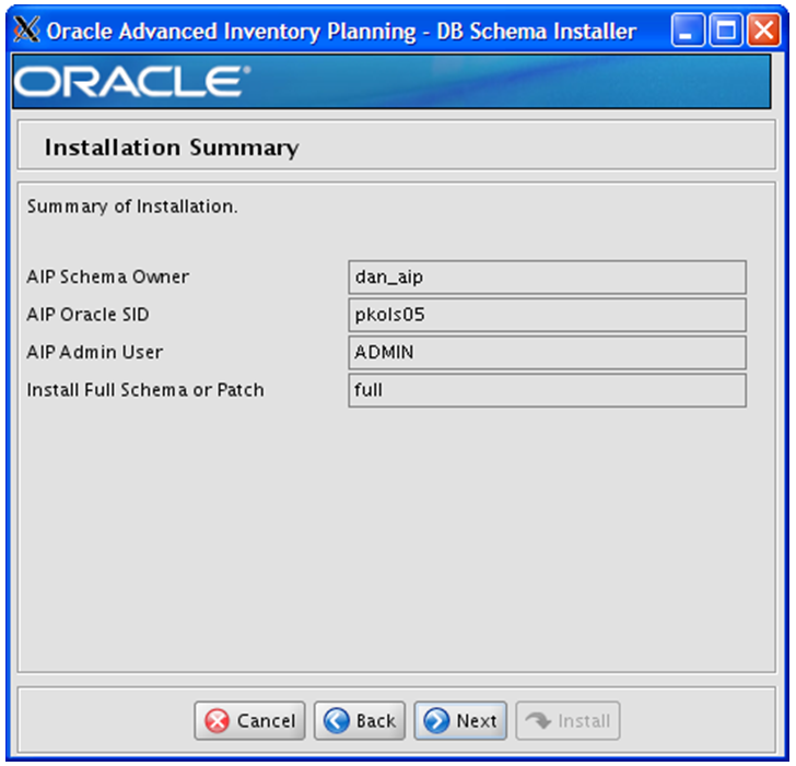

  8. The Installation Summary Window opens. Click Next to continue.
    Figure 4-6 Installation Summary Window
    Surrounding text describes Figure 4-6 .

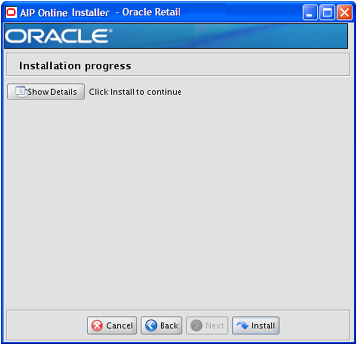

  9. The Installation Progress Window opens. Once you are ready to begin the installation, click Install. This window displays the progress of the installation routine.
    The installation log may include PL/SQL compilation warnings where dependencies have not yet been installed. These warnings are expected and all PL/SQL is automatically recompiled at the end of the installation process.
    Click Show Details to view the log output as the installation is performed. If you do not choose to view the details, a graphical representation of the installation steps appears. You can toggle between detailed mode at any time during or after the installation.

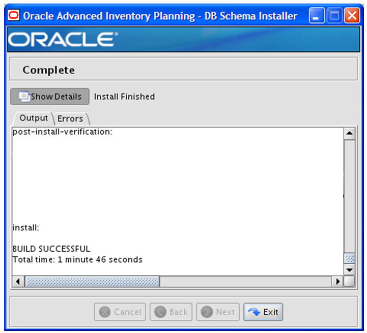

  10. When the installation has finished, the Complete Window opens.
    To view the installation details, select Show Details. The window displays two tabs, Output and Errors.
    It is recommended that you review these tabs for any issues that may have occurred during the installation process.
    When performing a full install and the Installer is complete, a log file and a .dbhistory file appear in the installation directory. The log file is named aip-install-dbschema.<timestamp>.log, where <timestamp> is the date and time you ran the Installer. A .dbhistory file is also created, which contains a list of all the SQL scripts that were run by the installer. A .dberrors file is created if any errors were encountered during full install.
    The Installer also generates an ant.install.properties file for future reference and repeat installations. This file contains all inputs you provided in the Installer windows, including passwords. As a security precaution, make sure that the file has restrictive permissions as shown in this example:
    Example: chmod 600 ant.install.properties
    The installer compares the actual database object count with expected object count for several different object types and displays a warning when there is a mismatch.
    You should review the logs and compare the logs from the actual and expected folders to see if there are schema differences listed in the install.log located under <Db install >AIPOnlineDBServer/aip/db_verification/.
    It is okay if the actual count is greater than the expected count. This could happen due to temporary internal objects being created by database during installation or if there were non-AIP objects present in the schema.
