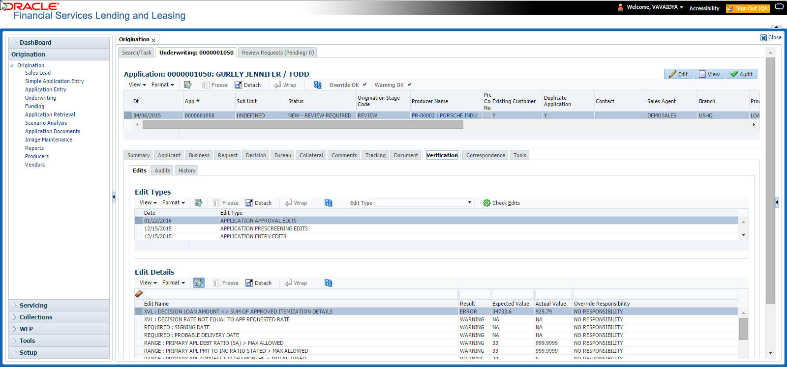

  1. Click the Verification link and begin verifying edits on the Edits screen (For more information, see the Verification link section in this chapter.)
During status change:
During status change, if there is a warning in the edit, the system displays an error message as ‘Warning Exists. Do you want to continue?’.

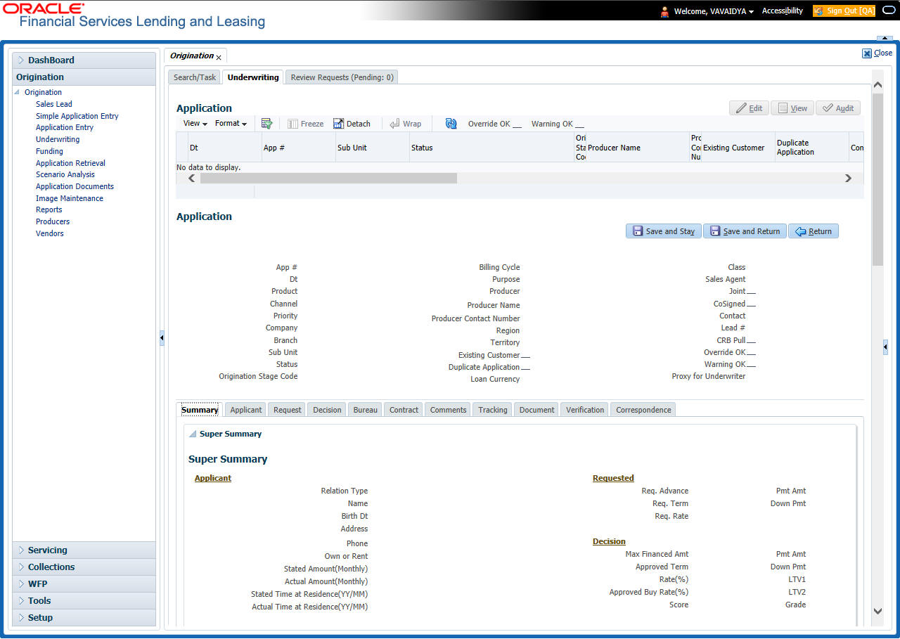

7.4 Summary Tab

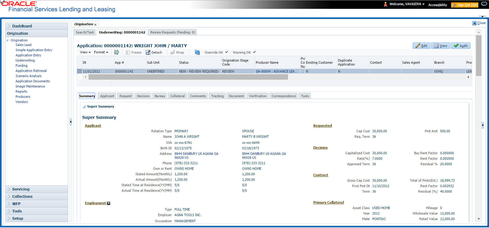

The summary screen provides a unified view of the application details without navigating to the respective screens/ sub-tabs.
Using this screen, you can view the following details in their respective sections:
To view the Super Summary
  1. Open the Underwriting screen and load the application you want to work with.
  2. Click Summary tab. By default the system opens the summary tab. Expand the Super Summary section.
The Super Summary tab provides a snapshot of all relevant details in a single screen and contains details of Applicant, Employment, Ratios, Bureau, Requested financials, Decision updates, Contract updates and Primary Collateral details. You need not have to navigate to each of these tabs for specific information on the application. Also clicking on the hyperlinks of Address, Employment, Ratios, and Trade-In helps you to directly navigate to respective tab(s),

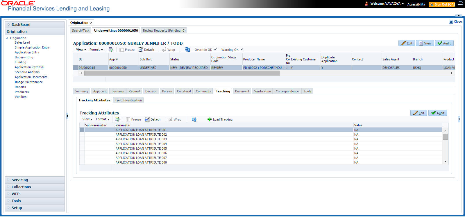

7.5.8 Tracking Attributes Sub Tab
You can add tracking attribute information to an application at any time in the underwriting process by using the Tracking Attribute tab.
The Tracking tab enables you to record further information associated with the application. What items you choose to track are setup during implementation.
To track attributes
  1. Click Tracking Attributes sub tab.
  2. Select the item you want to track.
  3. Click Edit to edit the following information:
    Field
    Do this
    Sub-Parameter
    View the sub-parameter
    Parameter
    View the parameter.
    Value
    Specify the information about the corresponding Value field.
  4. Save changes you made to the account.
7.5.8.1 Create Tracking
  1. Click Create Tracking, the system loads the tracking parameters.
  1. Specify the requested parameter in the Value field and click Save.

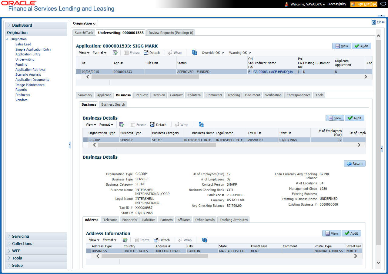

7.6 Business Tab
Oracle Financial Services Lending and Leasing can record SME business related financial information and business partners on the Business section to assist in approving the Lease application during underwriting. The Business Applicant screen is available and contains the following sub screens:
If there are no business information associated with the application, the Business Applicant tab is unavailable.
To complete the Business tab
  1. If SME business information is included on the application, select small business in the Class field on the Applications section and click Save.
The Business tab appears on the Underwriting screen.
  1. Click BusinessTab .
  2. Perform any of the Basic Operations mentioned in Navigation chapter.
A brief description of the fields is given below:
Field:
Do this:
Organization Type
Select the organization type.
Business Type
Select the type of the business.
Business Name
Specify the name of the business.
Legal Name
Specify the legal name of the business.
Tax ID
Specify the tax identification.
Start Date
Specify the business start date.
# of Employees (Cur)
Specify the current number of employees at the business.
# of Employees
Specify the number of employees at the business after financing.
Contact Person
Specify the contact person at the business.
Business Checking Bank
Specify the bank name of the business’s checking account.
Bank Acc #
Specify the bank account number.
Avg Checking Balance
Specify the average checking balance.
# of Locations
Specify the number of locations of the business.
Management Since
Specify the year the current management was established.
  1. Perform any of the Basic Actions mentioned in Navigation chapter

7.6.7 Other Details Sub Tab
The Other Details sub screen records information regarding monetary amounts associated with the business such as profits, sales, and expenses.
To complete the Other Details sub tab
  1. Click Other Details sub tab.
  2. Click Edit.
  3. Verify financial details as well as assets and liabilities linked to the business.
Field:
Do this:
Other Details section
Currency
Select the currency.
Business Type
Select the type of business.
Analysis Frequency
Select the analysis frequency.
Lease Currency Gross Margin Factor
The system displays the Lease currency business’s gross margin factor
Gross Margin Factor
Specify the business’s gross margin.
Organization Type
Select the type of organization.
Lease Currency Income
The system displays the Lease currency business income amount.
Income
Specify the business’s income amount.
Lease Currency Collec­tion Average
Specify the Lease currency collection average.
Collection Average
Specify the collection average.
Lease Currency Proj Coll Avg Annual
Specify the Lease currency annual projected collection aver­age.
Proj. Coll.Avg.Annual
Specify the annual projected collection average.
Lease Currency Book List
Specify the Lease currency business booklist.
Book List
Specify the business booklist.
Lease Currency Turn Over
Specify the Lease currency turnover amount.
Turn Over
Specify the turnover amount.
Lease Currency Capital Amount
Specify the Lease currency capital amount.
Capital Amt
Specify the capital amount.
Lease Currency Earned Surplus
Specify the Lease currency earned surplus amount.
Earned Surplus
Specify the earned surplus amount.
Lease Currency Gross Profit
Specify the Lease currency gross profit amount.
Gross Profit
Specify the gross profit amount.
Lease Currency Net Profit
Specify the Lease currency net profit amount.
Net Profit
Specify the net profit amount.
Lease Currency Work­ing Capital
Specify the Lease currency working capital amount.
Working Capital
Specify the working capital amount.
Lease Currency Annual Sales
Specify the Lease currency annual sales amount.
Annual Sales
Specify the annual sales amount.
Lease Currency Pro­jected Sales
Specify the Lease currency projected sales amount.
Projected Sales
Specify the projected sales amount.
Lease Currency Equity
Specify the Lease currency equity amount.
Equity
Specify the equity amount.
Open Delq
Specify the open delinquency amount.
Lease Currency Busi­ness Expenses
Specify the Lease currency business expenses amount.
Business Expenses
Specify the business expenses amount.
Lease Currency Per­sonal Expenses
Specify the Lease currency personal expenses amount.
Personal Expenses
Specify the personal expenses amount.
Lease Currency Total Expenses
View the Lease currency total expenses amount.
Total Expenses
View the total expenses amount.
Lease Currency Annual Proj Sales Amt
View the Lease currency annual projected collection amount.
View the annual projected collection amount.
Lease Currency Annual Proj Exp Amt
View the Lease currency annual projected expenses amount.
Annual Proj Exp Amt
View the annual projected expenses amount.
Lease Currency Current Assets
Lease currency current assets.
Current Assets/Liability ratio
View the current asset to liability ratio.
Lease Currency Fixed Assets
View the Lease currency fixed assets.
Fixed Assets
View the fixed assets.
Lease Currency Intangi­ble Assets
View the Lease currency intangible assets.
Intangible Assets
View the intangible assets.
Lease Currency Current Liabilities
View the Lease currency current liabilities
Current Liabilities
View the current liabilities.
Lease Currency Long Term Liabilities
View the Lease currency long term liabilities.
View the long term liabilities.
Lease Currency Total Assets
View the Lease currency total assets
Total Assets
View the total asset amount.
Lease Currency Total Networth
View the Lease currency total net worth amount.
Total Net worth
View the total net worth amount.
Lease Currency Total Liability
Lease currency total liability amount.
Total Liability
View the total liability amount.
Debt Net worth Ratio
View the debt to net worth ratio.
Title 1-4
Specify the title.
Signature1-4
Specify the signature.

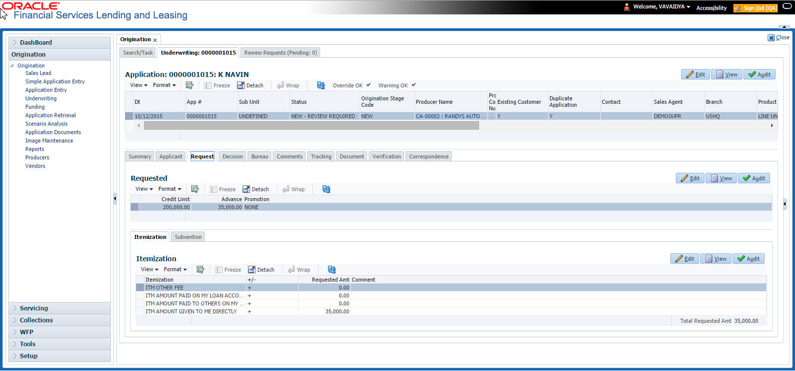

7.7 Request Tab
You can calculate Payment, Interest Rate, Term and Lease Amount using Request tab’s Calculate button. By default, system calculates for monthly repayment term basis. The payment frequency can be changed only in the Underwriting tab during decisioning.
To complete Request section:
  1. On the Application Entry tab, click Request tab.
A brief description of the fields are given below:
Field
Do this
Requested Advance Amt
Specify the requested advance amount
Pmt Amt
Specify the requested payment amount.
Term
Specify the requested term (number of payments).
Requested Rate
Specify the requested rate of interest.
Down Pmt%
Specify the down payment percentage
Down Pmt
Specify the down payment amount
Approx Prc
Specify the approximate cash price
Promotion
Select the promotion type from the drop-down list.
Balloon Amt
Specify the balloon amount.
Signing Dt
Specify the signing date
Probable Delivery Dt
Specify the probable delivery date.
  1. Perform any of the Basic Actions mentioned in Navigation chapter.
If you want system to calculate,
  1. Select the record you want to work with and from the drop-down option, select the option you want system to calculate:
  1. Click Calculate. The system displays the requested calculation in the respective field.
7.7.1 Itemization Sub Tab
The Itemizations sub tab enables you to add or verify any itemized amounts associated with the application. The list of itemizations is determined by the product you select in the master screen during the application entry process. The Itemizations sub screen displays an itemization record of the amount financed, such as the cash price, cash down payment, trade-in, unpaid cash price balance and so on. Information that was entered on the Itemization sub screen during the application entry process will appear in the Requested Amt column. Information that you enter as an underwriter in the Approved Amt column will appear in the Itemizations sub tab on the Underwriting screen.
Application request details need to be essentially entered in the itemization sub tab for pre-screening to be successful. Else, the system displays error and application would not proceed to the next level in work flow. The details of down payment, trade-in, insurance, fees etc. and the total sale price are recorded under itemization.
To add or view itemizations
  1. Open the Underwriting screen and load the underwriting application you want to work with.
  2. Click Request > Itemizations sub tab.
  3. Perform any of the Basic Operations mentioned in Navigation chapter.
Field:
Do this:
Itemization
View the itemization.
View whether the itemized amount is added or subtracted from the Lease amount.
Requested Amt
Specify the requested amount.
Comment
Specify a comment.

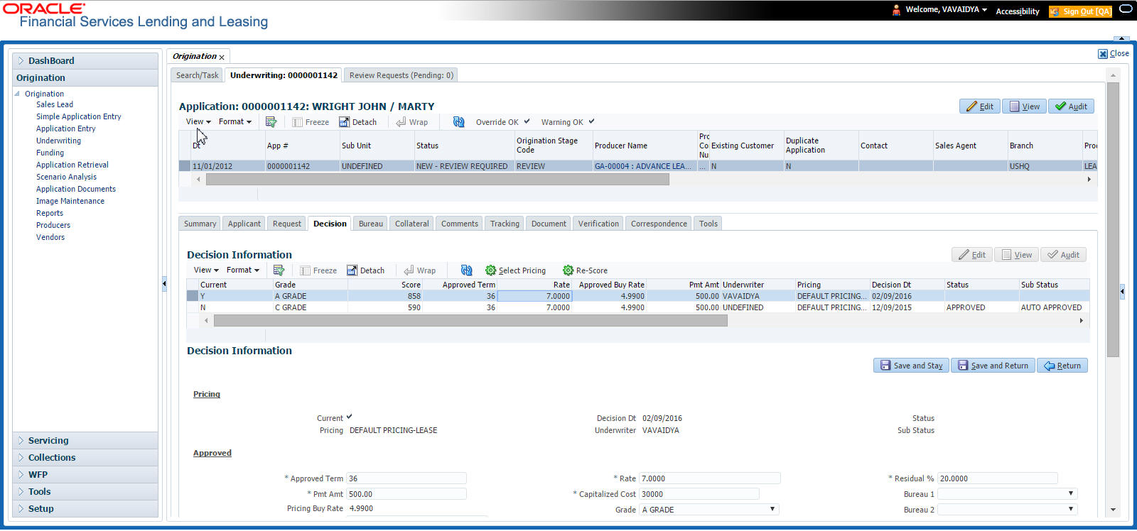

7.8 Decision Tab
If the application was initially approved automatically, the system displays its recommendations on the Decision tab’s Approved section.
If the application was initially rejected automatically, the system displays its reasons on the Decision link’s Stipulation sub tab.
If you choose to approve or reject the Lease manually, you must manually select the pricing (rule) set by the portfolio company for a specific product. The system validates this pricing against the information in the System Recommendation sections. The information in the Requested section comes from the application entry process and can be edited.
On clicking Calculate, you can calculate the Lease amount, rate, term, and payment. You can use the calculator available in Tools section for completing this step. For detailed information on using the Calculator tools, refer “Tools” chapter in the document.
To verify the application decision data
  2. Click Decision tab.
    • A brief description of the fields is given below:
      Field:
      Do this:
      Pricing section
      Current
      Check this box to indicate that this is the current deci­sion.
      Pricing
      View the pricing.
      Decision Dt
      View the decision date.
      Underwriter
      View the underwriter id.
      Status
      View the application status.
      Sub Status
      View the application sub-status.
      Approved section
      ApprovedTerm
      Specify the approved decision term.
      Pmt Amt
      Specify the approved payment amount.
      Note: If the system parameter ‘Auto Calculate PMT’ is set to ‘Y’ in Setup > Administration > System > System Parameter screen, the system auto calculates the pay­ment amount whenever there is a change in Decision Term or Decision Rate or Max Financed Amount fields.
      Note: Once the payment amount is approved, it will be copied on to the What if Payment field in the Summary sub screen of the Applicants Details screen.
      Pricing Buy Rate
      View the pricing buy rate.
      Approved Buy Rate
      View the approved buy rate which is by default the Pric­ing Buy Rate displayed above. You can also specify the required approved buy rate.
      Buy Rent Factor
      View the buy rent factor.
      Rate
      Specify the rate.
      Note: For Islamic products this field is displayed as ‘Profit Rate’.
      Capitalized Cost
      Specify the capitalized cost.
      Grade
      Select the credit grade.
      Score
      Specify the credit score.
      Rent Factor
      Specify the rent factor.
      Residual %
      Specify the residual percentage.
      Bureau 1
      Specify the Bureau 1.
      Bureau 2
      Specify the Bureau 2.
      Bureau 3
      Specify the Bureau 3.
      Comments
      Specify comments, if any.

If you are underwriting a Lease, record the following information on the Decision tab:
  1. If you are approving the application, complete the Approved section with the values you want to approve as an underwriter. You can update the default values that appeared when you selected the pricing string in step 3. (The system calculator may be of use when completing this section. For more information, refer the Tools chapter.)
  2. Click Calculate. The system displays the decision calculation in the respective field.

7.8.3 Itemization Sub Tab
The Itemizations sub screen enables you to add or verify any itemized amounts associated with the application. The list of itemizations is determined by the product you selected in the master screen during the application entry process. The Itemizations sub screen displays an itemization record of the amount financed, such as the cash price, cash down payment, trade-in, unpaid cash price balance and so on. Information that was entered on the Itemization sub screen during the application entry process will appear in the Requested Amt column. Information that you enter as an underwriter in the Approved Amt column will appear in the Itemizations sub screen on the Underwriting screen.
  2. Click Decision > Itemizations sub tab.
Field:
Do this:
Itemization
Requested Amt
Approved Amt
Specify the approved amount.
Discount Rate
Specify the discount rate.
Comment
Specify a comment.

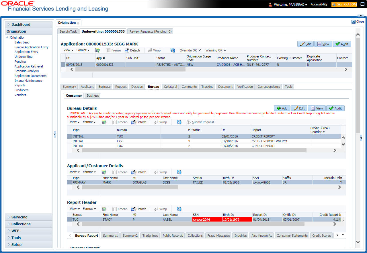

7.9 Bureau Tab
The Bureau tab displays the credit report (if pulled) for an applicant. If there is a need for another pull for any applicant, it can be done here manually using the New Request section.
If there are any adverse comments received from the Bureau, system displays them under 'Exceptions/ Comments' section against the specific Bureau record to alert the User. Following are some of the reasons:
  1. Application Indicates Potential Fraud
  2. Bureau Indicates Social Security Number Variance
  3. Duplicate Application Exists
  4. Bureau Indicates a Possible Current Delinquency
  5. Bureau Indicates Bankruptcy
  6. Bureau Indicates Consumer Statement
  7. Bureau Indicates a Possible Repossession
  8. Bureau Reports OFAC hit
  9. Bureau Reports Applicant as Deceased
  10. Potential Delinquencies for Auto Loans in Past 12 Months
  11. Customer Rate (APR) Exceeds the State Usury Rate
  12. Open Consumer Credit Counselling
The reasons will also be displayed in the Summary tab in 'Bureau' details under 'Exceptions /Comments' section.
To verify the credit bureau data using the Bureau tab
  2. Click Bureau.
  3. In the Bureau Details section, view the following information:
    Field:
    View:
    Type
    The credit bureau request type.
    Bureau
    The credit bureau.
    The credit bureau request number.
    Status
    The status of credit bureau request.
    Dt
    The credit bureau request date.
    Report
    The credit bureau report type.
    Credit Bureau Reorder#
    The credit bureau reorder number.
    App Ind
    If selected, indicates that a bureau was pulled for an application.
  4. In the Applicant/Customer Detail section, view the following information:
    Field:
    Do this:
    Type
    View the relation type.
    First Name
    Specify the first name.
    MI
    Specify the middle name.
    Last Name
    Specify the last name.

7.9.2 Requesting a Credit Bureau Report Manually
The Credit Bureau Summary screen enables you to manually request a credit pull. Information from a manual credit pull can be used to validate an application.
To manually request a credit bureau report
  2. Click Bureau tab.
  3. In the Bureau Details section click Add.
  4. Specify the following information:
    Field:
    Do this:
    Applicant
    Select the applicant.
    Spouse
    Select the applicant’s spouse (if applicable).
    Bureau
    Select the credit bureau.
    Report
    Select the credit bureau report type.
  5. Click Create Request.
The system displays this information in the Bureau Details section.
Note
If you are requesting a report from Experian Credit Bureau for Premier Attribute Consumer report, you can do so without impacting the consumer FICO score. To facilitate the same, the ‘Soft Pull’ check box is to be selected in Bureau Details section. This option is available only when the system parameter ‘EXP_PA_SOFT_PULL_IND’ is enabled in the System Parameters screen and Bureau is selected as ‘EXP’ with Report as ‘PREMIER ATTRIB­UTE’ in the Bureau Details section.
  1. Select Include Debt and Populate Debt in the Applicant/Customer Detail section to populate the Liability section on the Applicants link’s Summary sub screen with data from the credit bureau pull.
  2. If you want to receive a copy of a previously pulled credit bureau report, enter the credit bureau reorder number in the Credit Bureau Reorder # field on the Bureau Details section. This enables you to receive a previously pulled credit report.
  3. In the New Request section, click Submit Request.
The system displays the latest status of the currently requested bureau report in the Bureau Details section. When the report pull process is complete, the Status field in the Bureau Details section changes from pending to Completed.

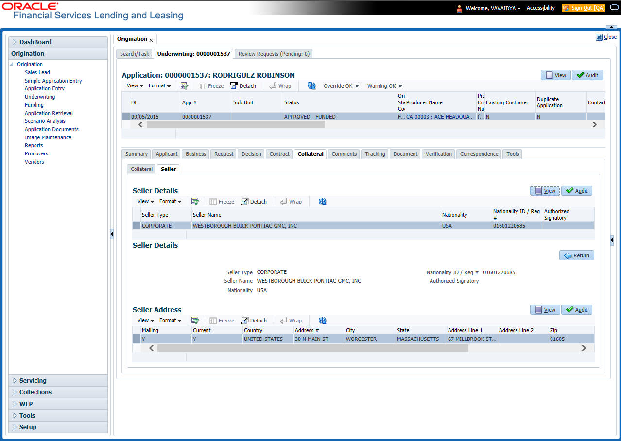

If the collateral is any other, the Collateral link displays information about that collateral.

7.10.3 Seller Tab
The Collateral link’s Seller Details tab enables you to enter the seller details of the collateral of the Lease.
To enter the Seller details
  1. Click the Seller Details tab.
Field:
Do this
Seller Information section
Seller Type
Select the seller type.
Seller Name
Specify the seller name
Nationality
Select the seller’s nationality.
National ID/Reg #
Specify the national identification number or registration number.
Authorized Signatory
Specify the authorized signatory of the seller.
Seller Address section
Mailing
Select if this is the mailing address. Only one address entry can be marked as the mailing address.
Current
Select if this is a current address. The mailing address must be marked as current.
Country
Select the country code.
Address #
Specify the address number.
Address Line 1
Specify the first address line.
Address Line 2
Specify the second address line.
State
Select the state.
Zip
Select the zip code.
For non US country, you have to enter zip code.
Zip Extn
Select the zip extension.
City
Specify the city.
Phone
Specify the telephone number.
Extn
Select the telephone extension.

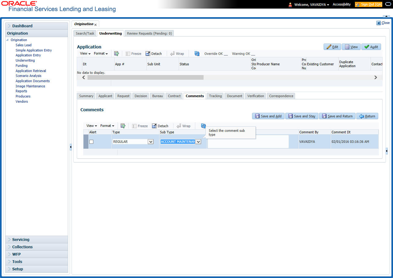

7.11 Comments Tab
When using the Underwriting screen, you can add/delete comments to an application at any time in the underwriting process by using the Comments screen.
Whenever an application is decisioned by a proxy user, a system generated comment with timestamp is inserted in the comments tab in the format ‘<User 1> actioned as proxy for Underwriter <User2>’. Here, User 1 refers to the logged in user who has acted on behalf of User2, who is the concerned Underwriter. The concerned Underwriter’s name will also be selected in Application section > 'Proxy for Underwriter' field.
To add comments
  1. Click Comments tab.
Field:
Do this:
Alert
Check this box to make the comment appear on the Customer Service screen Alert section
Type
Select the type of comment you are adding.
Sub Type
Select the sub type of comment you are adding.
Comment
Specify your comment.
Comment By
The system displays your user ID.
Comment Dt
The system displays commented date and time stamp.

7.12 Tracking Tab
When using the Underwriting screen, you can add tracking attribute information to an application at any time in the underwriting process by using the Tracking Attributes screen.
To enter the tracking attributes
  1. Click Tracking tab.
  2. On the Tracking Attributes screen, click Load Tracking to load the tracking attributes.
  3. Select the item you want to track.
  4. Click Edit to edit the following information:
    Field
    Do this
    Sub-Parameter
    Parameter
    View the parameter.
    Value
  5. Save changes you made to the account.

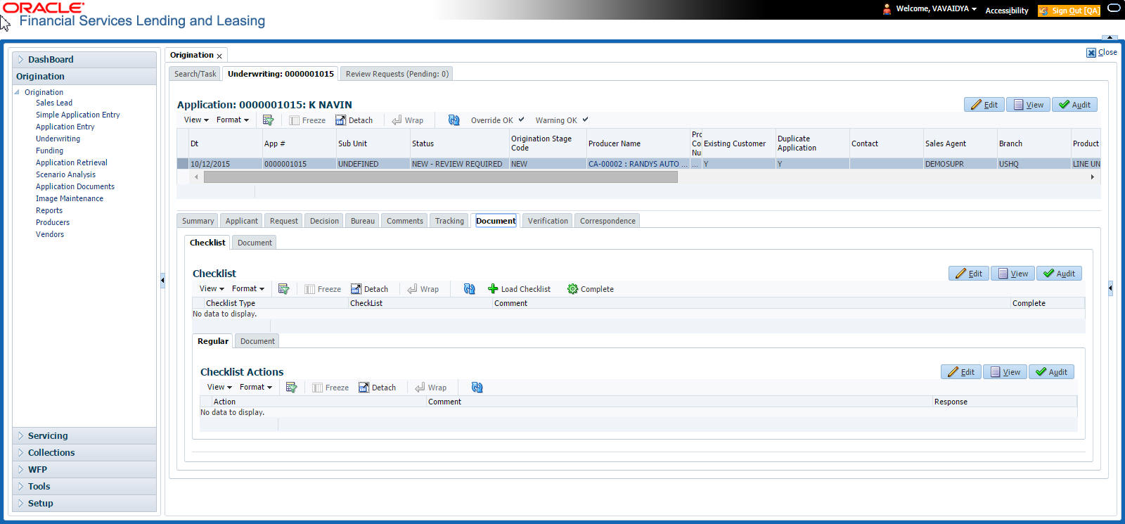

7.13.1 Checklist Sub Tab
The Checklist sub tab enables you to view tasks performed during the underwriting process.
To view the underwriting Checklist screen
  1. Click Document > Checklist.
  2. If the Checklist section is empty, click Load Checklist in the Checklist section.
  3. In the Checklist Actions section, click Regular sub tab.
  4. In Checklist Actions section, complete the tasks listed in the Checklist Action column.
  5. Use the Yes/No/NA buttons in the Yes No NA column to indicate whether you completed the task or not.
  6. Use the Comment field to add remarks regarding any of the tasks, if you choose.
  7. When you are finished completing the tasks, choose Complete in the Checklist section.
  8. Click Save.
  9. In the Checklist Actions section, click the Documents sub tab
  10. In the Documents section, select the record you want to work with and click View in the Details column.
  11. In the Documents section, view the following information:
    Field:
    Do this:
    Action
    View the action to be performed.
    Document Type
    View the document type.
    Document Sub Type
    View the document sub type.
    Status
    Select the status of the action.
    Response
    Use the Yes/No/NA buttons to indicate whether or not you completed the task.
    Comment
    Specify comment.

7.14.1 Edit Sub Tab
To complete the Edits section
  2. Click Verification > Edits.
  3. In the Edits screen’s Edit Type section, select the type of edit you want to verify.
  4. Click Check Edits.
The system checks the data for the verification process selected in the Edit Type section and displays the results in the Edit Details section.
The Edit Details section contains the following display only information:
Field:
View this:
Edit Name
The edit.
Result
The result.
Expected Value
The expected value.
Actual Value
The actual value.
Override Responsibility

7.14.2 Audits Sub Tab
The Audits screen is a display only screen that enables you track changes to the contents of predetermined fields (which fields are determined during set up). For example, the Audits screen can be configured to monitor when the contents of the Status and Sub Status is changed. The Audits screen lists the field that was changed, who made the change, when the change was made, and the old and new values in the field.
To view the Audits
  2. Click Verification > Audits.
  3. In the Audit Details section, view the following display only information:
    Field:
    View:
    Record Id
    The record identifier for the record changed.
    Field
    The field which was changed.
    Old Value
    The old value of the column which was changed.
    New Value
    The new value of the column which was changed.
    Changed By
    The user code who made the change.
    Changed Date
    The date and time when the change was made.
7.14.3 History Sub Tab
You can track the time it took a user to complete each stage of the application process with the History section. It displays:
  1. To view the History Open the Underwriting screen and load the application you want to work with.
  2. Click Verification > HistoryIn the Application Status History section, view the following display only information:
    Field:
    View this:
    Status
    The application status.
    Sub Status
    The application sub status.
    User
    The user name.
    Start Dt
    The date and time when the application moved to that status.
    End Dt
    The date and time when the application moved from that sta­tus.
    Elapsed Time
    The elapsed time between the status change.

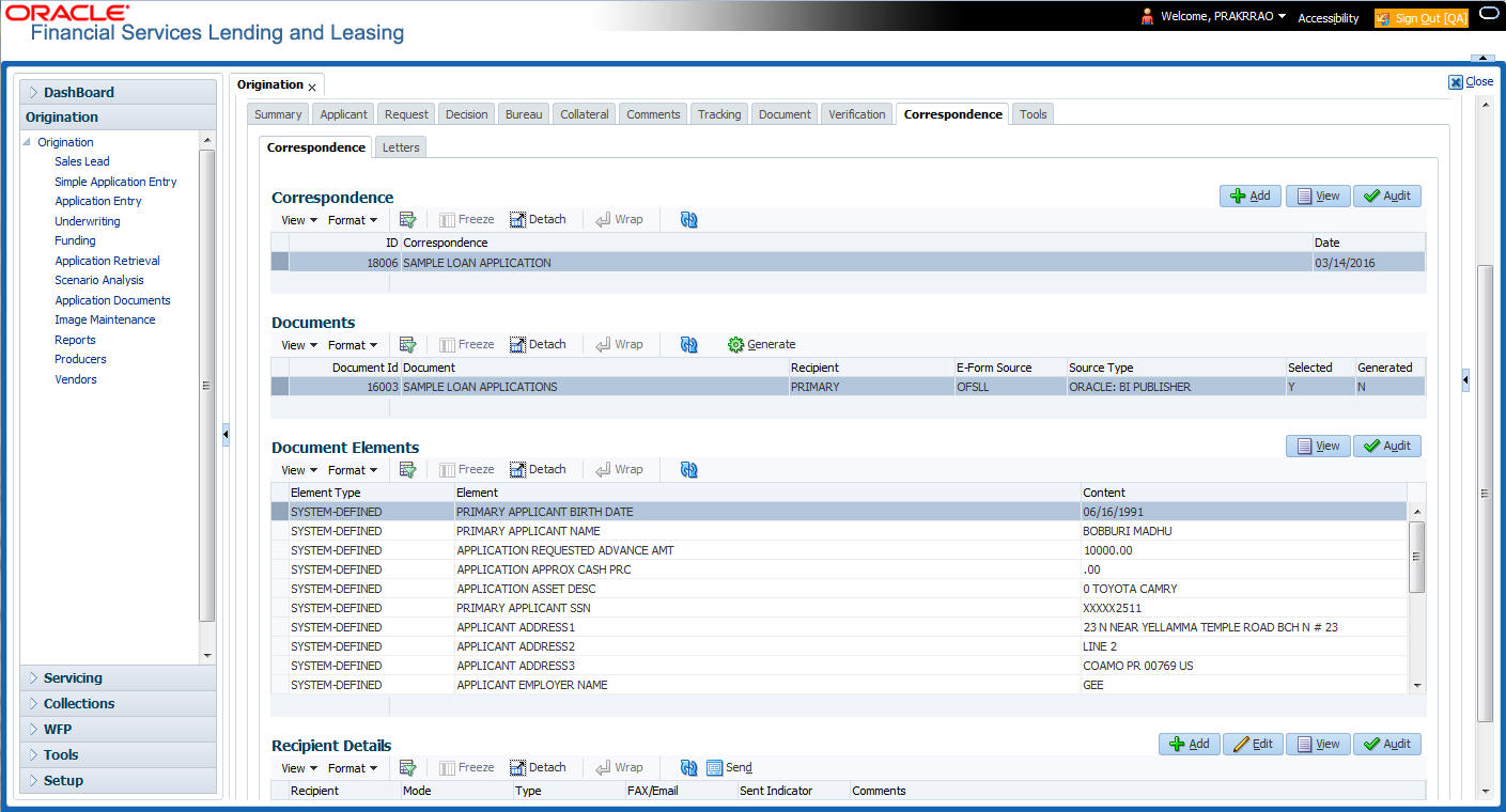

7.15 Correspondence Tab
Ad-hoc correspondence enables you to include information from applications in document templates you create yourself without manually transferring the data. Ad-hoc documents can be generated as either Microsoft Word or PDF files.
Ad-hoc correspondence can be viewed on the Correspondence link’s Correspondence screen when you have opened an account. The screen enables you to generate a new letter or view a previously generated letter.
7.15.1 Correspondence Sub Tab
To generate an ad hoc correspondence
  2. Click Correspondence > Correspondence.
Field:
Do this:
Correspondence
Select the correspondence you want to generated.
ID
System displays the correspondence ID.
Date
System displays the correspondence generation date.
The Documents section displays all the types of documents available for the type of correspondence you selected.
  1. In the Documents section, view the following information for each document:
    Field:
    View this:
    Document ID
    The document ID.
    Document
    The document description.
    Recipient
    The recipient description.
    E-Form Source
    The e-form source.
    Source Type
    The source type.
    Selected
    If selected, indicates that this document is selected to be included in the correspondence.
    Generated
    If selected, indicates that the system generated the document.
  2. In the Documents section, select the correspondence you want to view.
  3. The Document Elements section displays the elements the system used to generate the correspondence. You view the following information:
    Field:
    Do this:
    Element Type
    View the element type.
    Element
    View the element description.
    Content
    Specify/view the value of the element.
- or -
  1. In the Document Elements section, click User Defined and complete the Content fields for the Document Element fields you want to include in the correspondence.
  2. In the Document Elements section, click Save.
  3. In the Documents section, click Generate.
The system ‘locks’ the information included in the correspondence and prevents it from being changed.
  1. In the Document Elements section, click View.
The system displays a PDF of the ad hoc correspondence.
7.15.1.1 Recipient Details Sub Tab
The recipient details sub tab facilitates you to send ad-hoc correspondence to Applicants, Customers, Producers, and Others as either Fax or Email.
To add recipient details
  2. Click Correspondence > Recipient Details.
Field:
Do this:
Recipient
Select the recipient from the drop-down list. The list displays the following options:
- Applicant
- Customer
- Producer
- Others
Note: Based on the type of recipient selected the other corre­spondence options are displayed for selection.
Mode
Select the mode of correspondence from the drop-down list. The list displays the following options:
- Fax
- Email
Note: When the recipient is selected as ‘Applicant’, the Mode is defaulted to Email.
Type
Based on the recipient selected, the following type of correspond­ence is listed for selection:
- When the recipient is selected as Applicant, you can select the ‘Applicant Type’ from the drop-down list and ‘Type’ as either EMAIL/ADHOC. The ‘Mode’ is defaulted as ‘Email’.
- When the recipient is selected as Customer / Producer, you can select the ‘Mode’ as either FAX/EMAIL and ‘Type’ as FAX/ADHOC or EMAIL/ADHOC respectively.
- When the recipient is selected as Others, you can select the ‘Mode’ as either FAX/EMAIL and ‘Type’ as ADHOC only.
FAX/Email
Specify the FAX/Email details for correspondence.
Comments
Specify additional information as comments.
  1. In the Recipient Details section, click Save.
  2. Click Send to FAX/Email the correspondence details to the specified recipients.
System validates the correspondence details and generates a PDF document through BI Publisher with the Correspondence details. The same is emailed to the specified recipient as an attachment and a system generated comment is updated in ‘Comments’ Tab. The correspondence consists of following header details::
Alert
Type & Subtype
Comment
Comment By
Comment Date
N
System Generated
<Type> <Correspondence type> sent to <Recipient Type> through < Mode> to <'Email' id>
Logged in user
Current System date with time stamp
