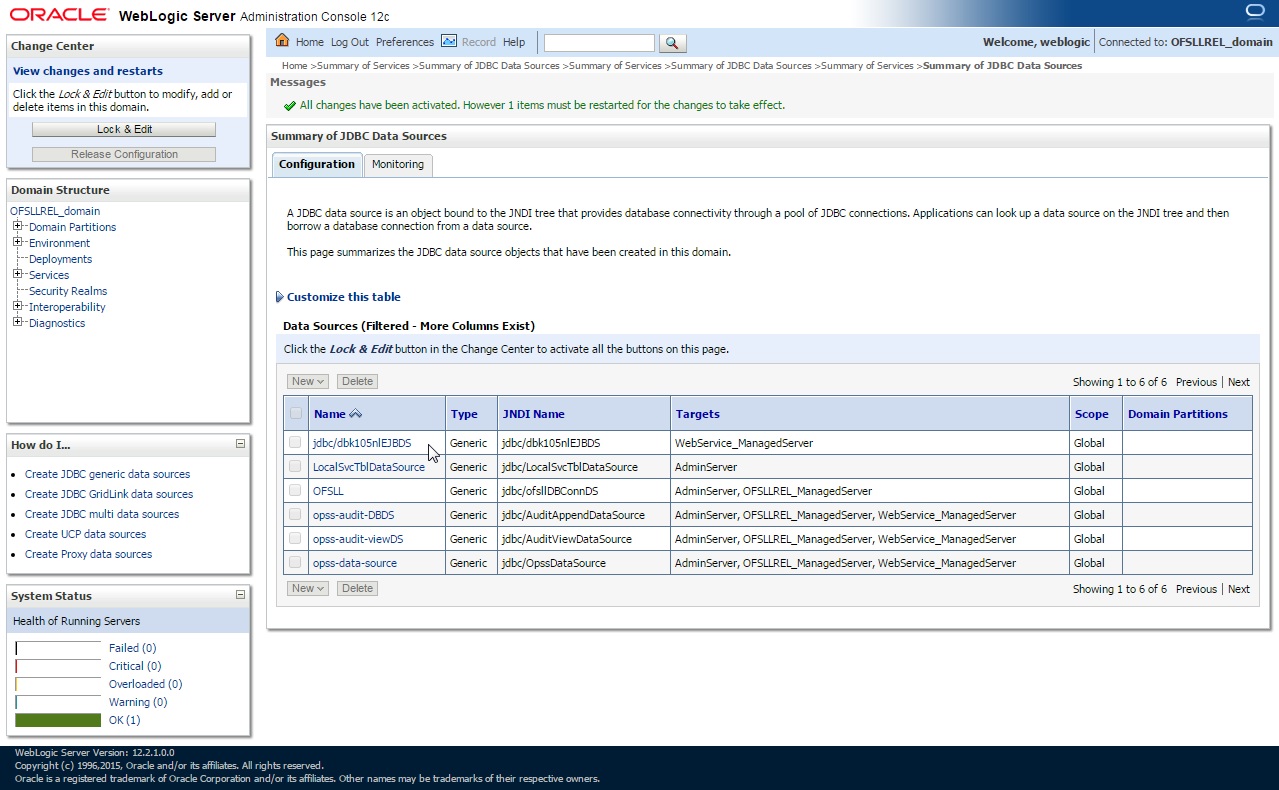

3.1 Creating Data Sources for WebServices
Create a new server on the console which will be specifically for
WebServices.
- Login to WebLogic Server 12c console (http://hostname:port/console).
- The
following window is displayed.

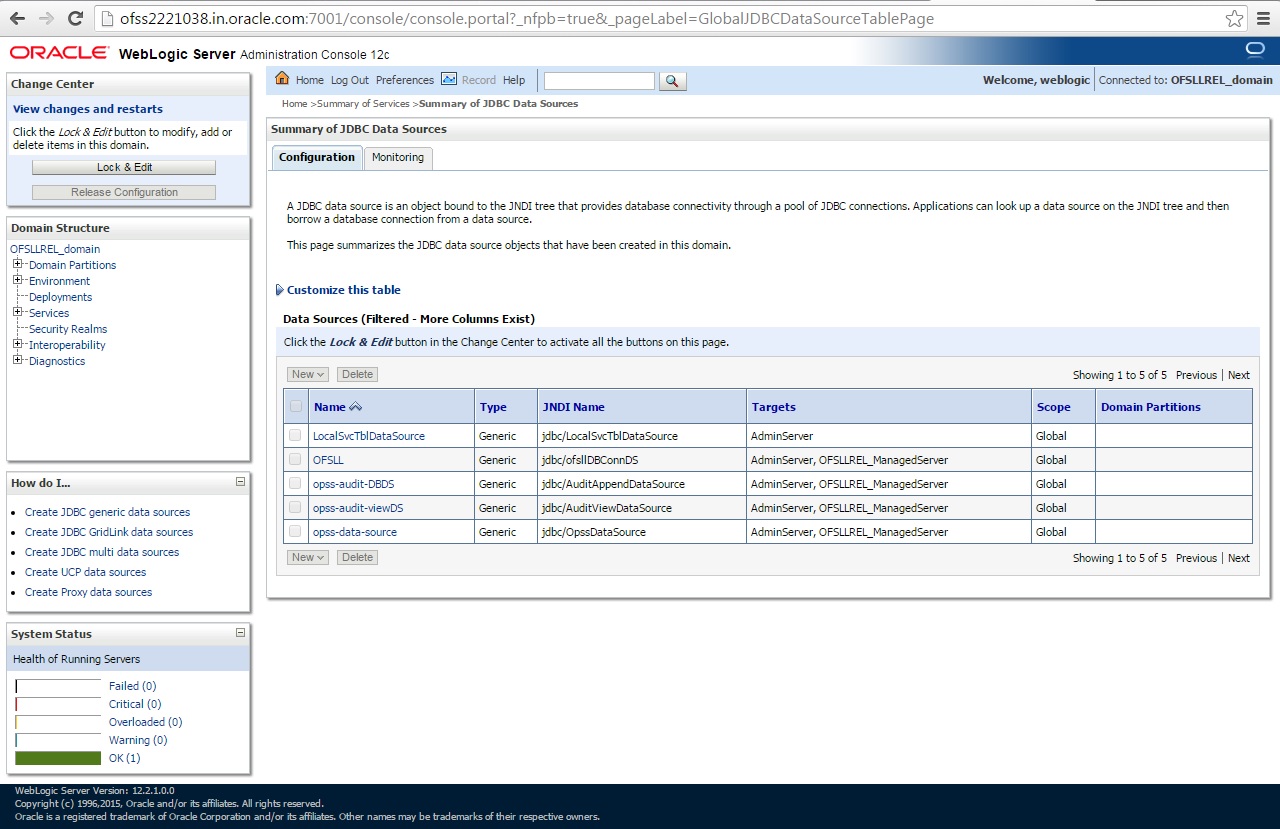

- Click
Domain Name > Services > Data Sources. The following window is
displayed.
- Click
‘Lock & Edit’ button on the left panel. Click ‘New’
on right panel and select ‘Generic Data Source’.

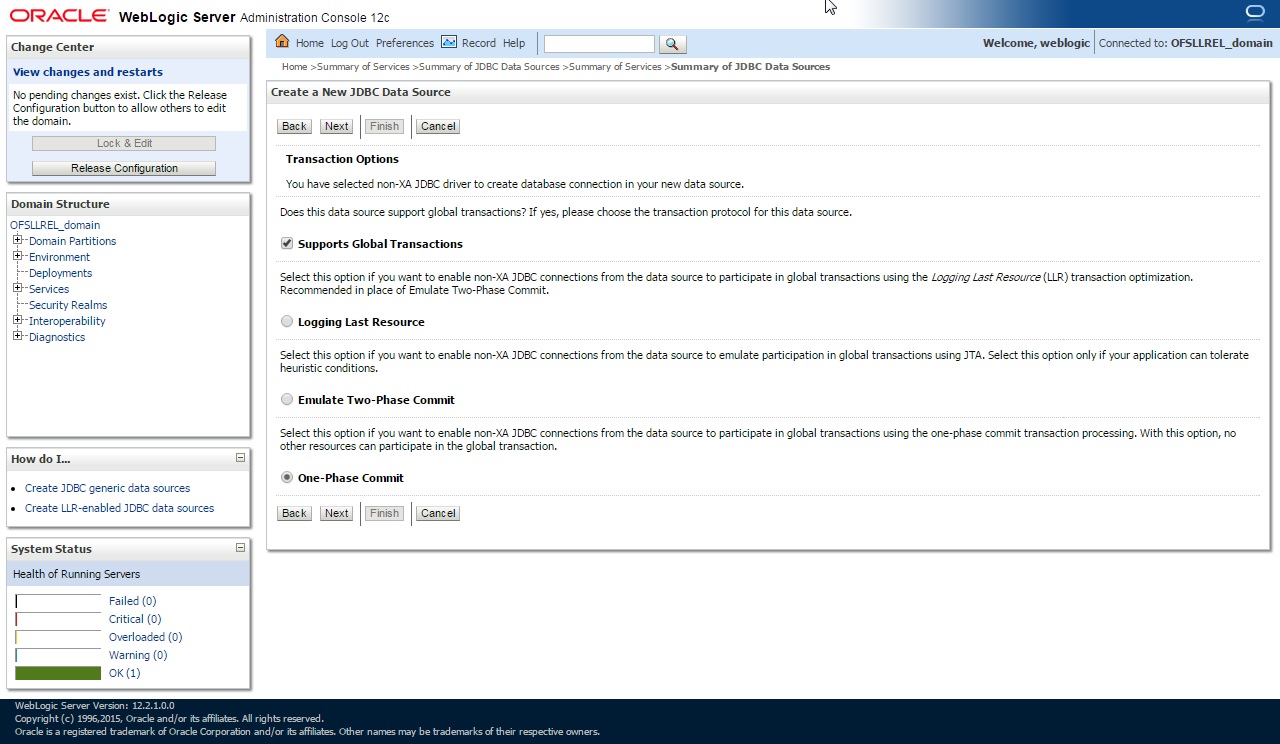

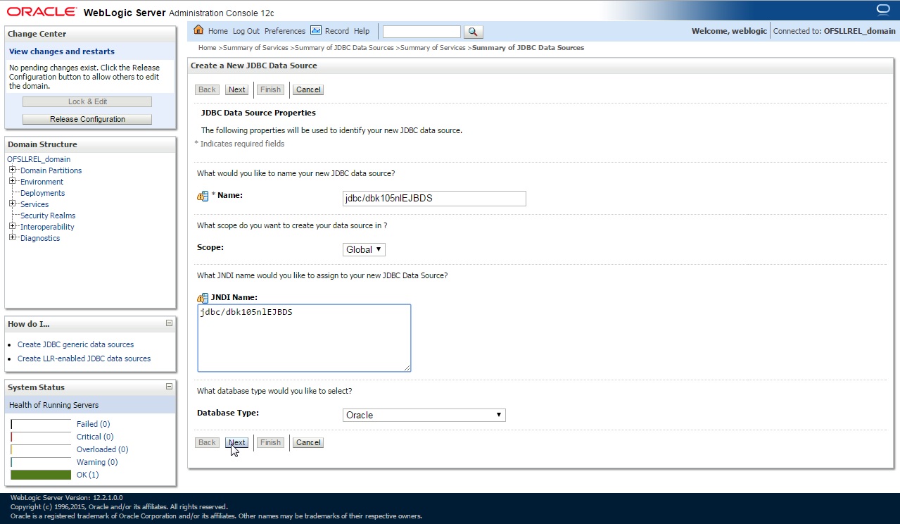

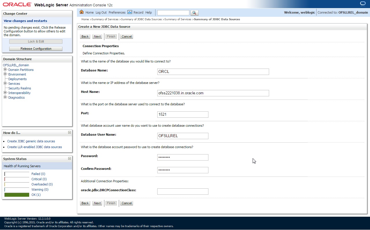

- Specify
the following details:
- Enter Data source Name.
- Enter JNDI Name as ‘jdbc/dbk105nlEJBDS’.
- Select ‘Oracle’ as Database Type.
- Click ‘Next’. The following window is displayed.

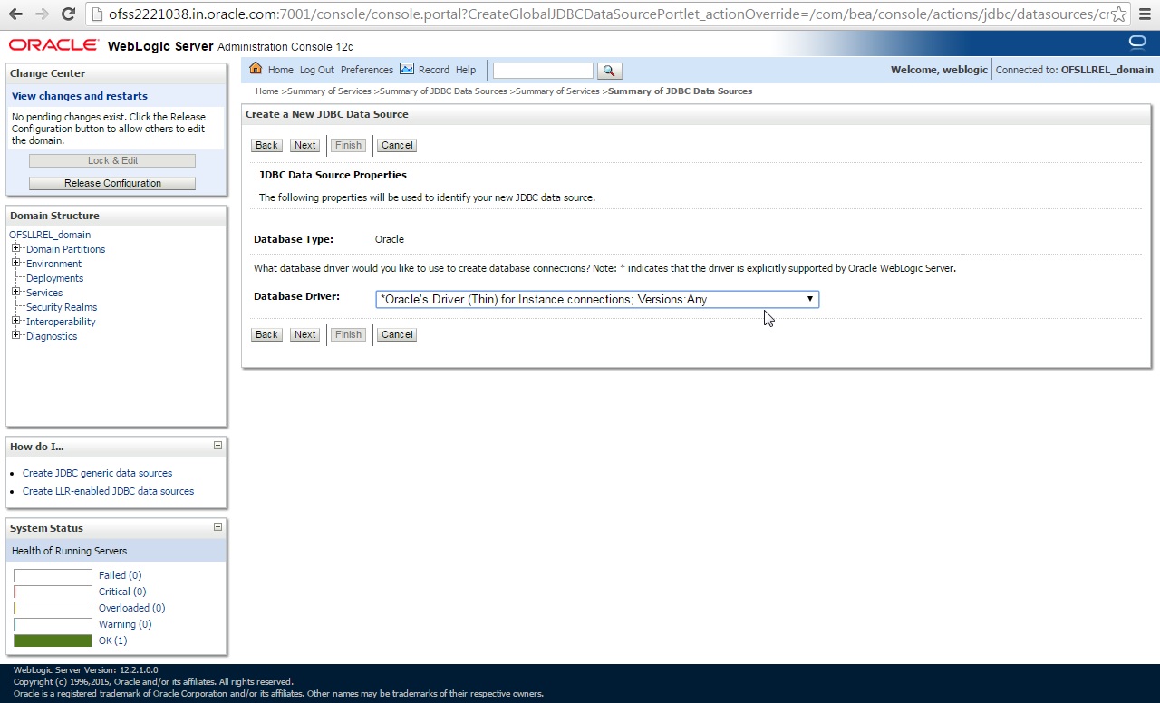

- Select the Database Driver ‘Oracle's Driver(Thin)
for Instance connections;Versions:Any’ as shown.
- Click
- Click
- Enter
the Database details.
- Click
‘Test Configuration’. The following window is displayed indicating
a confirmation message as ‘Connection test succeeded’.
- Select target WebServices Server and click ‘Finish’.
- Click ‘Activate Changes’.
Similarly follow the above steps to create the following data sources:
- jdbc/dbkwsDS
- jdbc/IN1HukWznG0b4esj

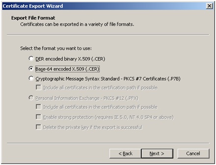

- Save all the certificates from the vendor website. Note
to save the certificates in "Base-64 encoded X.509(.CER)" and with extn

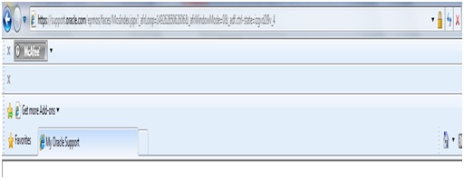

.cer. Steps for saving certificates from the vendor website:
- Click on the padlock and choose ‘View Certificates’.

- Click
on the ‘Copy to File’ button, and click ‘Next’.
Select ‘Base-64 encoding’ and save the file somewhere on
your local computer.

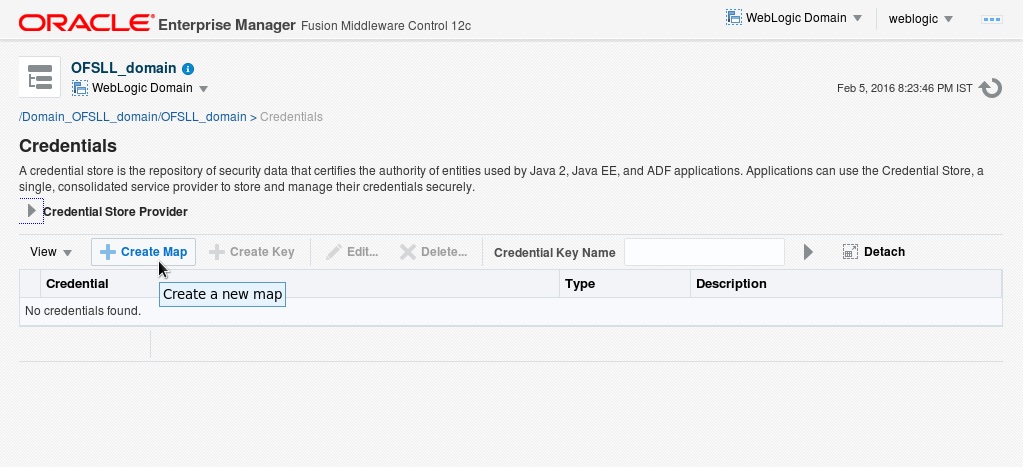

- Login to Oracle Enterprise Manager 12c (http://hostname:port/em).
- On the left panel, right click on OFSLL_domain and select
Security > System Policies > Credentials. The following window
is displayed.

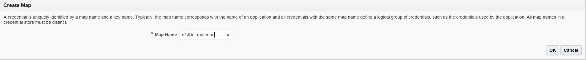

- Click ‘Create
Map’. The following window is displayed.

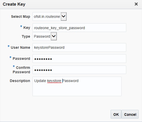

- Enter Map Name as
‘ofsll.int.routeone’ and click ‘OK’.
- Click ‘Create Key’. The following window is
displayed.
- Click ‘OK’.
Similarly you need to create the following Maps and corresponding
keys as indicated in following table.
Maps
Key Name
Username
Password
Description
ofsll.int.routeone
routeone_key_store_password
keystorePassword
changeit
The keystore password

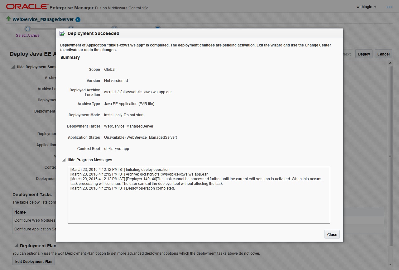

3.4 Deploying Webservices
3.4.1 Deployment of WebServices in Enterprise Manager

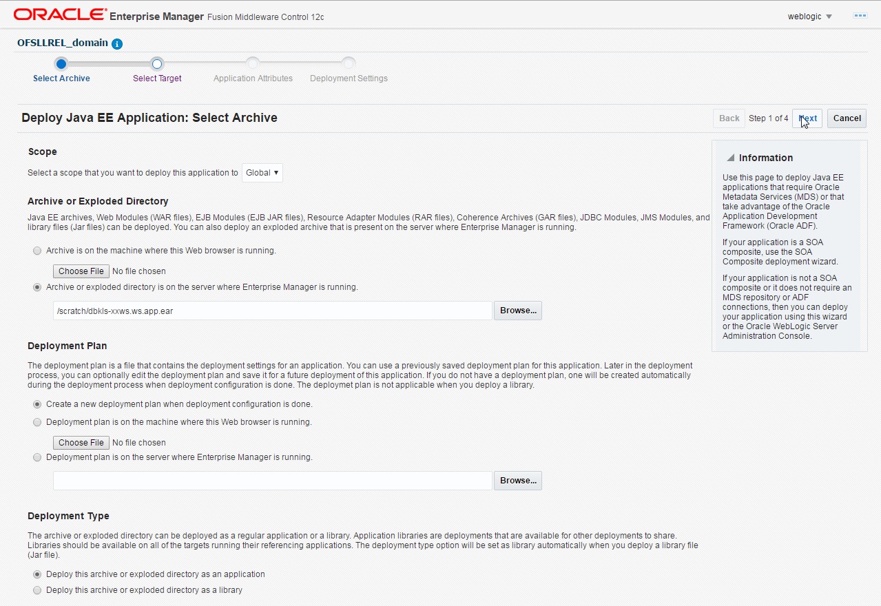

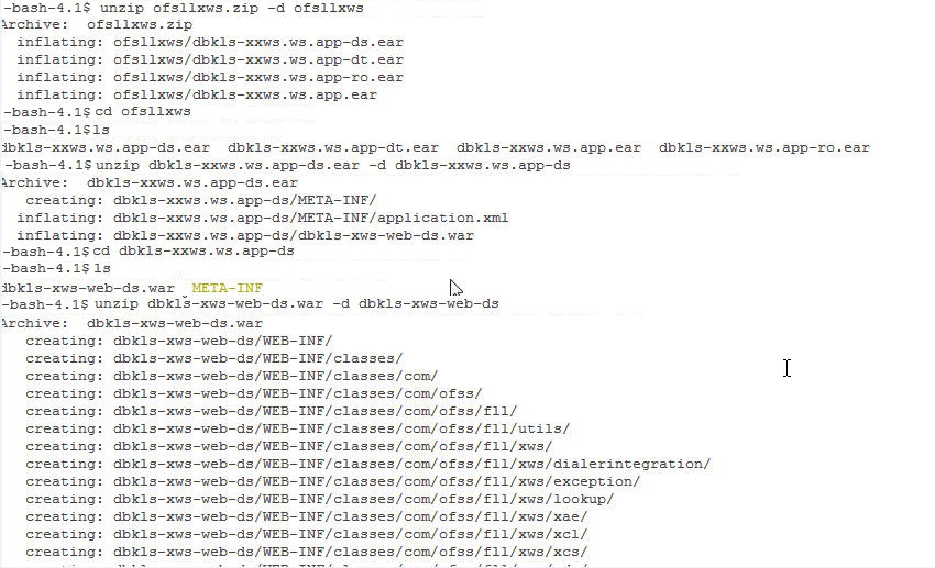

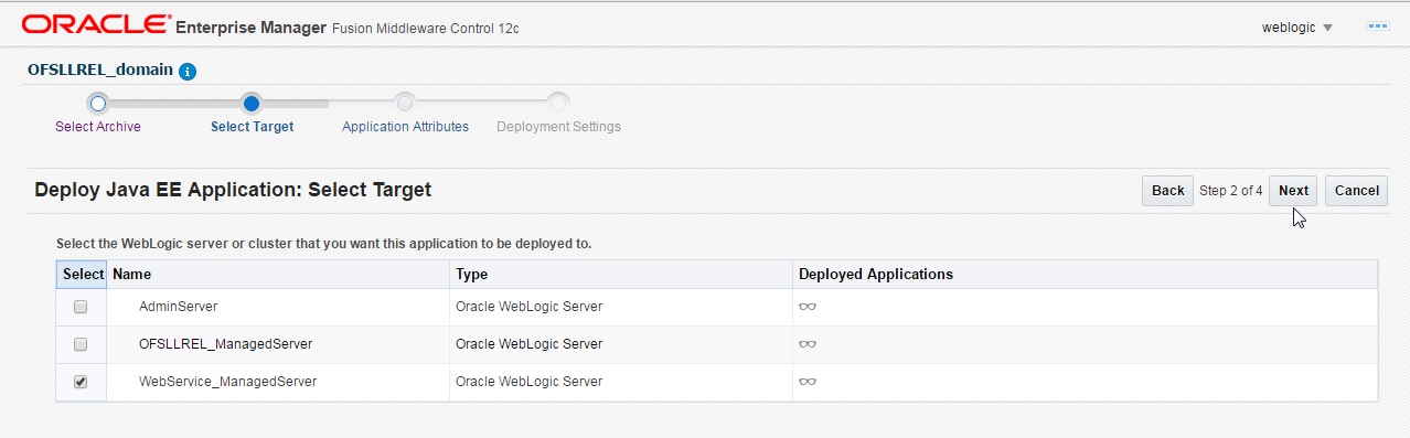

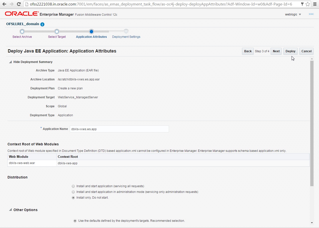

- Download and unzip the WebServices - ofsllxws.zip.
- Following is a mapping of which EAR is needed for which

- Unzip all the ear files present:
- dbkls-xxws.ws.app.ear
- dbkls-xxws.ws.app-dt.ear
- dbkls-xxws.ws.app-ro.ear
- dbkls-xxws.ws.app-ds.ear

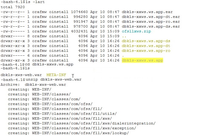

- Open each of the unzipped files and unzip the war file.
- It creates a WEB-INF file
After unzipping the war file to directory, the directory will have
the following structure
- dbkls-xxws.ws.app / dbkls-xxws.ws.app-ds / dbkls-xxws.ws.app-dt /
dbklsxxws.ws.app-ro
- /dbkls-xxws.ws.app/dbkls-xws-web
WEB-INF (directory)
---->classes (directory)
- config
- class files (in package folders)
-----> lib (directory)
- jdom-2.0.6.jar
- OfsllCommonCSF.jar
- soap-2.3.1.jar
------> wsdl (directory)
- *.wsdl
-----> *-java-wsdl-mapping.xml
-----> web.xml
-----> weblogic.xml
-----> weblogic-webservices.xml
-----> weblogic-webservices-policy.xml
-----> webservices.xml

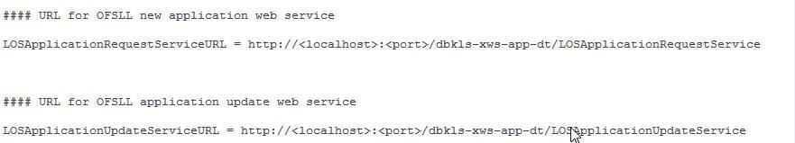

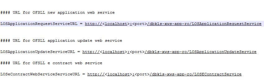

- To edit the web interface config files, navigate to the
above WEB-INF > classes > config. Edit the following configuration
files with the application url and port.
For complete details on configuration parameters, refer to “Appendix - Configuration parameters”
section in Appendix chapter.
- ds_servlet_init.conf-This is the configuration file only for edocs
servlet interface
- dt_servlet_init.conf-
This is the configuration file only for dealer track servlet interface
- ro_servlet_init.conf-
This is the configuration file only for route one servlet interface

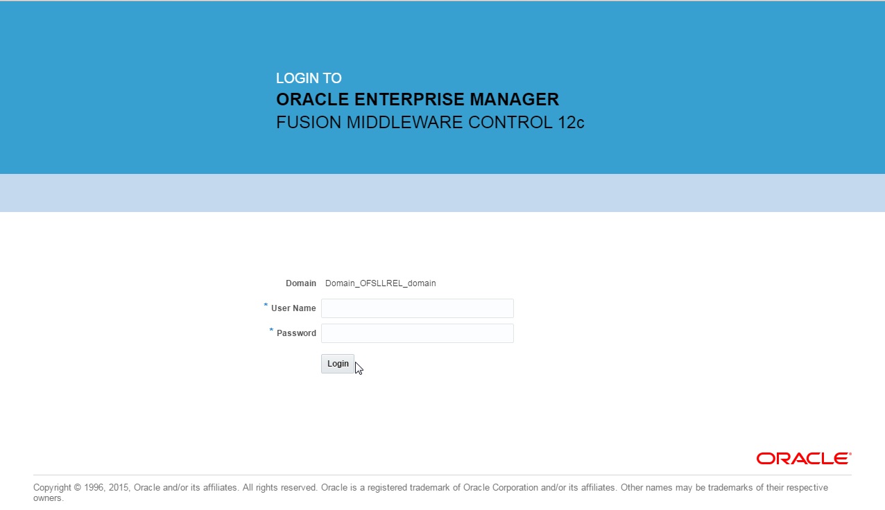

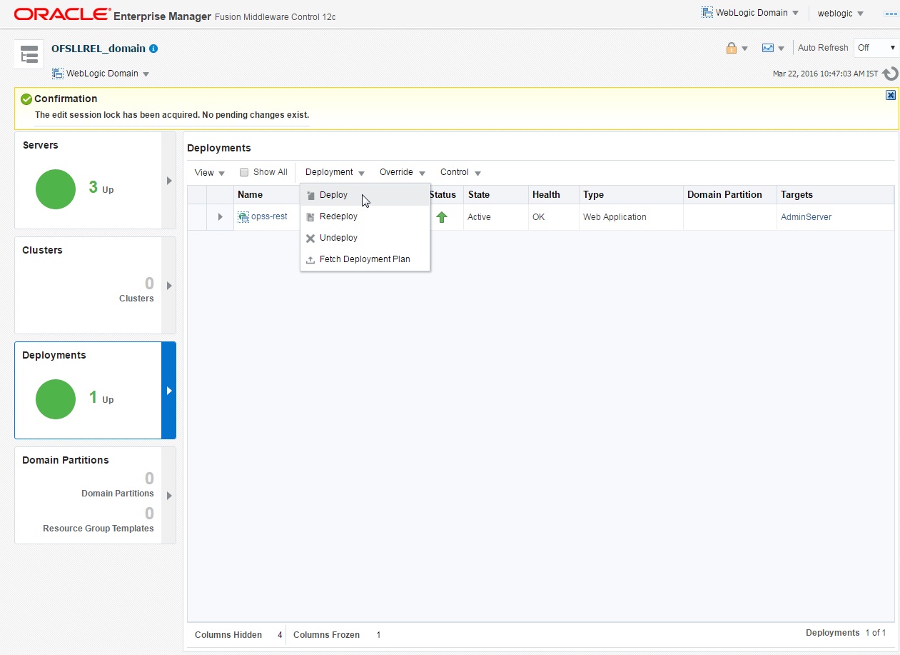

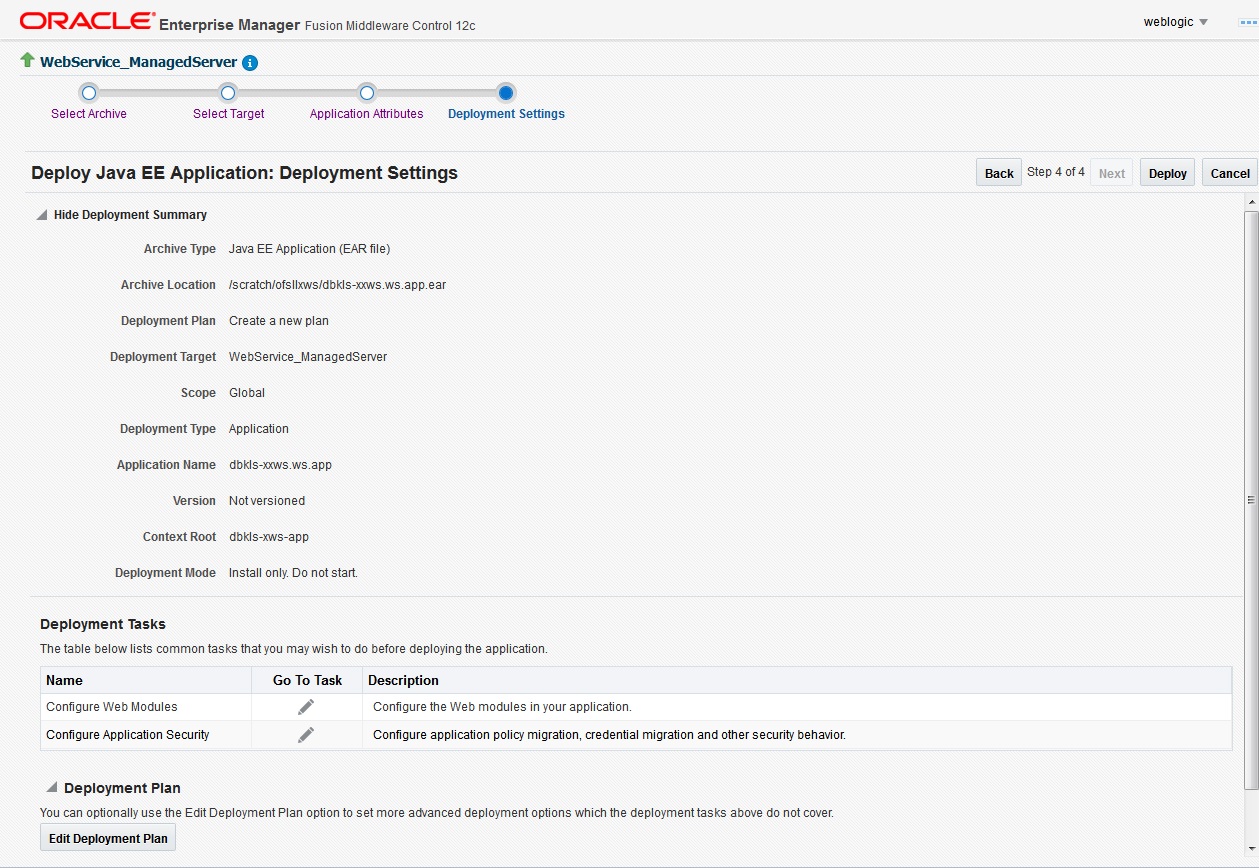

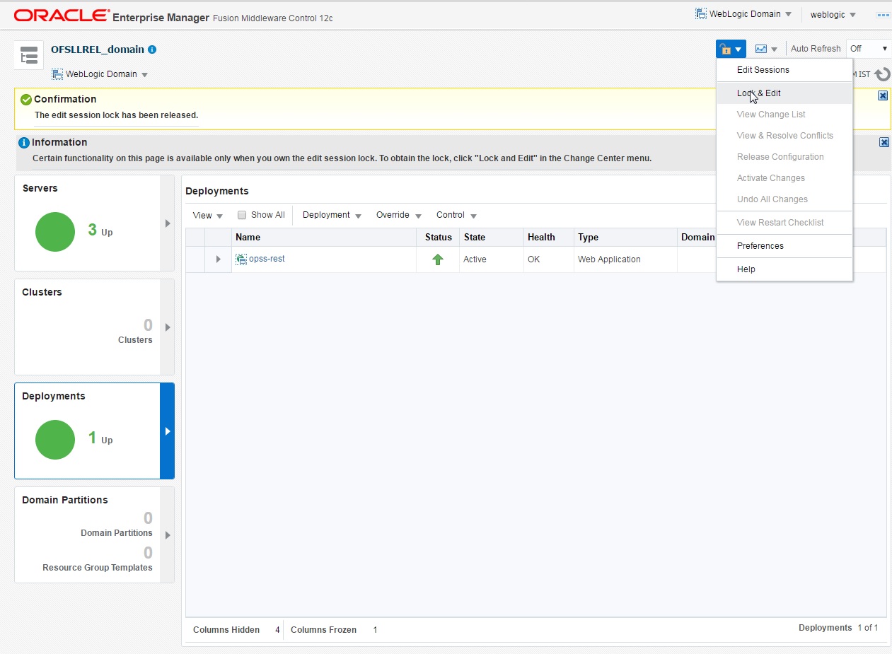

- Login to Web Logic application server enterprise manager
(e.g.: http://hostname:port/em)
- Enter valid login credentials. The following window is displayed.
- Expand the weblogic domain present in the left pane. The following
- Right click on WebService_ManagedServer in left panel, select
Application Deployment > Deploy.
- The following window is displayed.
- Browse to the folder containing the WebService.
Eg: /scratch/ofsllxws/dbkls-xxws.ws.app
Click ‘Next’.
- The following window is displayed. Select the server on
which the WebService needs to be deployed. Click ‘Next’.
- The following window is displayed. Check the context root
and click ‘Next’.
- The following window is displayed. Click ‘Deploy’.
- The following window is displayed. Click ‘Close’.
- If required, similarly deploy rest of the WebServices.
- In case the context root has to be changed for the WebServices,
it can be changed by editing the application.xml or through the console.
To change through console, login to WebLogic Server 12c console (http://hostname:port/console).
- Go to Deployments > <select the service deployment>
> Configuration General and modify the context root to the recommended
name as follows:
Service
Service EAR
Recommended Context
Remark
Webservices
dbkls-xws-app
If this the recommended
context name is not used, then the Service URLs in the configuration
files needs to be changed
Edocs Interface
dbkls-xws-app-ds
Dealer Track Interface
dbkls-xws-app-dt
Route One Interface
dbkls-xws-app-ro
- Ensure that the application status is ‘Active’.
