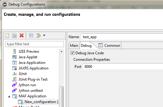

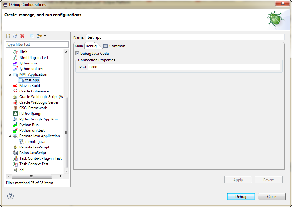

To create a new configuration or to modify an existing one, complete the Debug Configuration dialog as follows:
  1. From OEPE's main menu, click Run > Debug Configurations to open the Debug Configuration dialog.
  2. Create a new debug configuration by right-clicking MAF Application and choosing New.
  3. Complete the Main tab of the dialog as follows:
  4. In the Debug tab, select Debug Java Code and set the port to the appropriate port number, as shown in Figure 30-1.

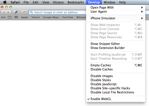

30.3.2.1 What You May Need to Know About Debugging of JavaScript Using an iOS-Powered Device Simulator on iOS 6 Platform
If you are working with the iOS 6 platform, you can use the Safari 6 browser to debug JavaScript. To do so, open the Safari preferences, select Advanced, and then enable the Develop menu in the browser by selecting Show Develop menu in menu bar, as shown in Figure 30-3.
Figure 30-3 Enabling Safari Browser Options
This image is described in the surrounding text
When the Develop menu is enabled, select either iPhone Simulator or iPad Simulator, as Figure 30-4 and Figure 30-5 show, and then select a UIWebView that you are planning to debug. Whether the Develop menu displays an iPhone Simulator or iPad Simulator option depends on which device simulator is launched.
Figure 30-4 Using Develop Menu on Safari Browser for Debugging on iPhone Simulator

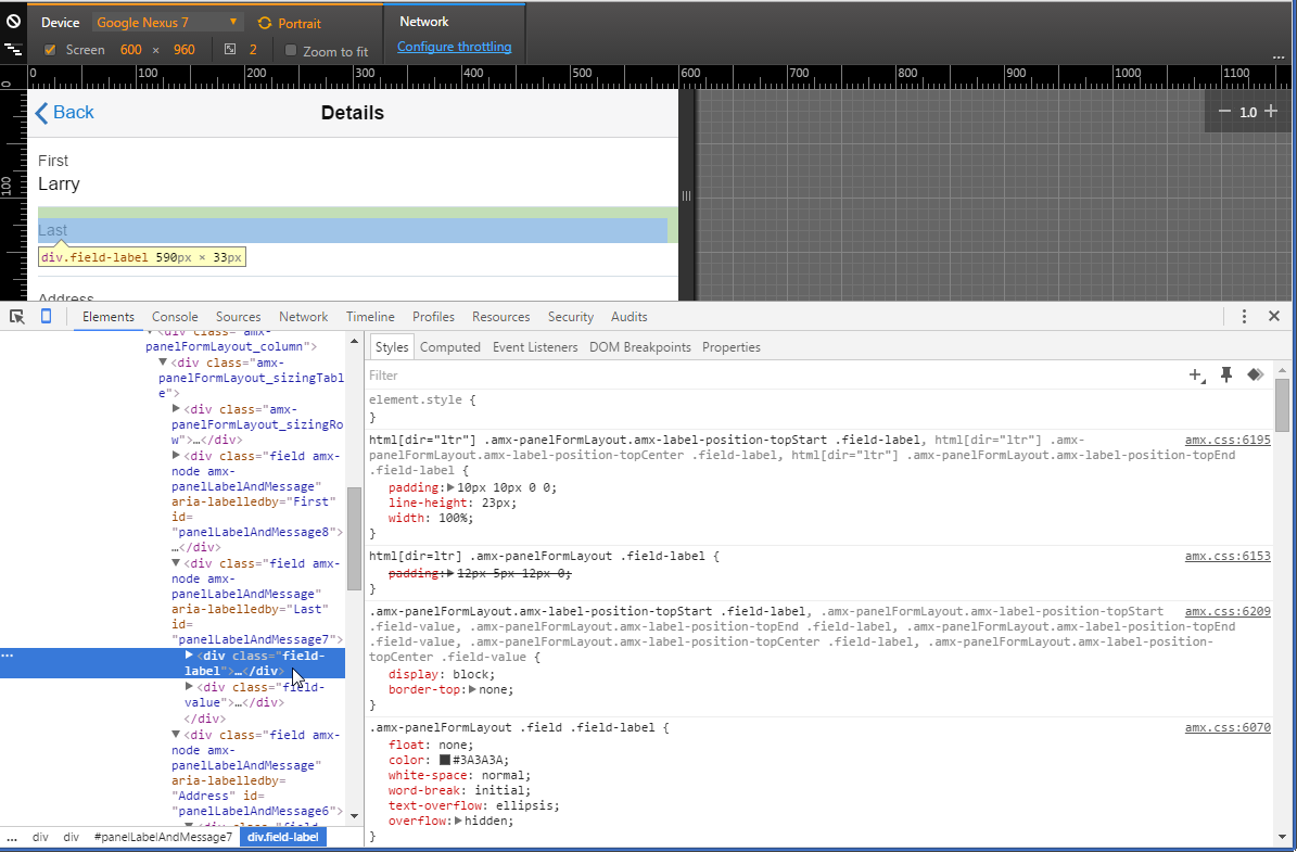

When developing a MAF application, you may need to debug code that renders the user interface (UI) of your application on an Android device. The code that renders the UI can include JavaScript, HTML, and CSS. You can debug this code using Google's Chrome DevTools when you deploy the MAF application from your development machine to the Android device. Figure 30-6 shows the Chrome DevTools inspecting an AMX page from a MAF application.
Figure 30-6 Chrome DevTools Inspecting an AMX Page from a MAF application
For more information on the Chrome DevTools, including the requirements to use it, see Remote Debugging on Android with Chrome DevTools on the Google Developers' site.

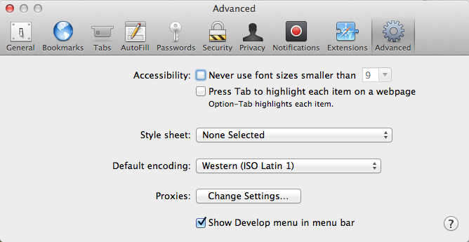

If you are working with the iOS platform, you can use the Safari browser to debug JavaScript. To do so, open the Safari preferences, select Advanced, and then enable the Develop menu in the browser by selecting Show Develop menu in menu bar.
When the Develop menu is enabled, select either iPhone Simulator or iPad Simulator, as Figure 30-3 and Figure 30-4 show, and then select a UIWebView that you are planning to debug, as Figure 30-5 shows.

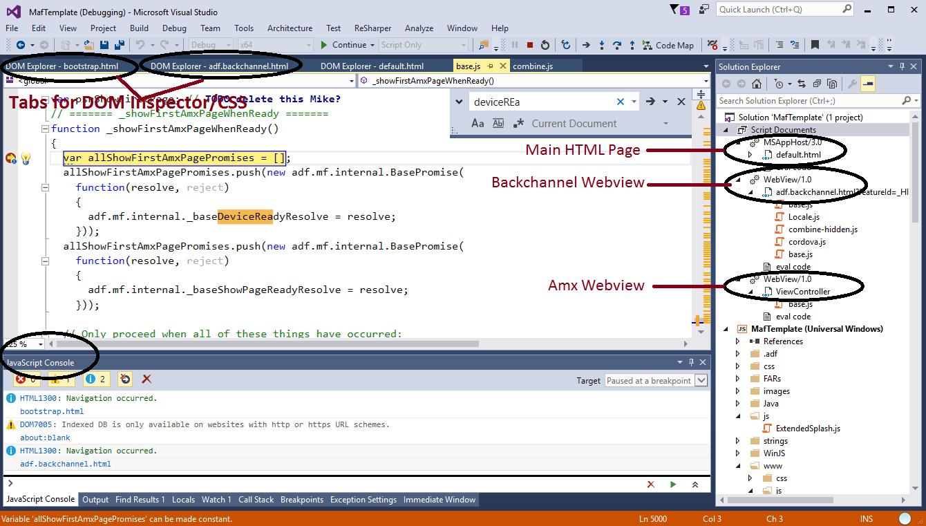

30.6 Debugging MAF Applications Deployed on the Universal Windows Platform
You can debug the Java code in MAF applications that you deploy to the UWP using OEPE's debugging tools. For more information, see How to Debug Java Code on the Universal Windows Platform.

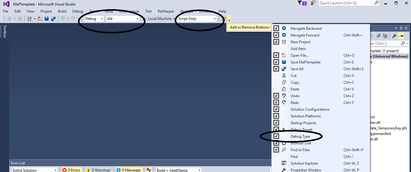

Use Visual Studio to debug the JavaScript, HTML, and CSS code in your MAF application, as described in How to Debug UI Code on the Universal Windows Platform.

To debug UI code in MAF applications deployed on the UWP:
  1. Deploy your MAF application in debug mode. For more information, see Deploying a MAF Application to the Universal Windows Platform.
  2. Once you deploy your application to your local machine, navigate to the following directory: c:\workspace\assembly_project\.main.windows\build\debug.
    main.windows may have a numerical suffix if more than one deployment target has been created for the application.
  3. Double-click the MafTemplate.sln template file that is configured with the application artifacts to open it in Visual Studio.
  4. In Visual Studio as shown in Figure 30-14, set the value of CPU to x64.
    Figure 30-14 Visual Studio IDE
  5. If Script Only option is selected, you should be able to debug the UI code of AMX as shown in Figure 29-14.
    Figure 30-15 Visual Studio Workspace

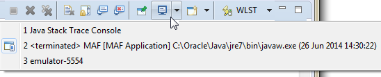

There are two consoles in OEPE available when running applications on devices: iOS Console and for each device (including emulator) additional console for Android. Both types of console can stream the logging and standard output, using two additional logging.properties file properties which allow you to filter the output to the OEPE console:
oepe.console.filter.android=<some string>
oepe.sonsole.filter.ios=<some string>
You switch from one console to another using the Display Selected Console button in the Console menubar. To cycle through the consoles available, click This image is described in the surrounding text. Alternatively, click the down arrow next to the button and choose from the list, as shown in Figure 30-16.
