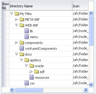

Screen Shot(s)
treeTable screenshot
TreeTable component.
