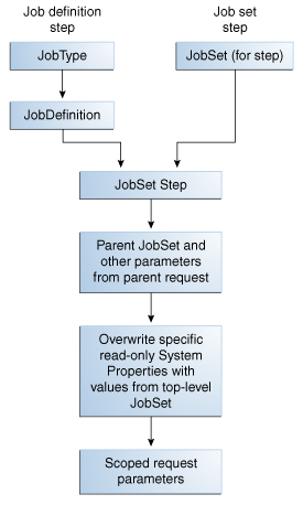

Properties for a job set step request are materialized during the processing of a job set when the step is reached. Properties for a job step request are materialized in the following order.
  1. Job type and job definition (if the step is a job definition) or job set (if the step is a job set).
  2. Job set step.
  3. Parent request properties and system properties (parent is step's parent job set).
  4. Scoped request properties.
Example 9-2 illustrates the parameter precedence for job set steps.
Figure 9-2 Parameter Precedence for Job Set Steps
Parameter precedence for job set steps
