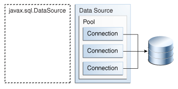

An Oracle Stream Analytics DataSource provides a JDBC data source connection pooling implementation that supports the JDBC 4.0 specification.
Applications reserve and release Connection objects from a data source with the standard DataSource.getConnection and Connection.close APIs respectively.
Figure 12-1 shows the relationship between data source, connection pool, and Connection instances.
Figure 12-1 Oracle Stream Analytics Data Source
Description of Figure 12-1 follows
Description of "Figure 12-1 Oracle Stream Analytics Data Source"
