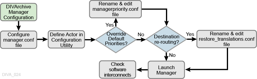

The following figure is the workflow for installing a DIVArchive Manager:
The static configuration file in new installations is initially named manager.conf.ini. You must remove the .ini extension for it to be recognized by the DIVArchive Manager.

Each request submitted to the DIVArchive Manager is placed in the Manager transfer queue. Request priorities enable DIVArchive to differentiate between important requests, such as Restore requests, over less important events. For example, tape repacks, and so on.
The request priority is a number from zero to one hundred with zero being the lowest priority and one hundred being the highest. The request priority is typically specified when you submit the request (either from the Control GUI or the DIVArchive Client API). You can also alter the priority after you submit the request using the Change Priority command.
The default request priority for each request type is preset within DIVArchive. You can override the default priorities (at your discretion) using the following procedure:
Navigate to the %DIVA_HOME%\Program\conf\manager folder.
Rename the managerpriority.conf.ini file to managerpriority.conf.
Edit the managerpriority.conf file using a plain text editor (for example, Notepad or Notepad++) to set the desired values for each request type.
You must reload the Manager configuration using the reload option or restart the Manager for the new settings to take effect.
Regardless of the configured request priority, the Manager will (by default) periodically increment the priority of every request already the request queue. This prevents a condition where a low request priority can be continually overridden by higher priority requests and never executed.
You can disable this feature by setting the DIVAMANAGER_UPDATE_PRIORITIES_PERIOD parameter in the Manager configuration file to 0. You must then reload the Manager configuration or restart the Manager.
restore_translations.conf)To simplify production workflows, you can configure DIVArchive to automatically override the original destination specified in a Restore, Partial File Restore, or N-restore request based on the object category and original destination. This is called Destination Rerouting. Typically, you use this function to enable selective transcoding based on an object category.
You configure Destination Rerouting by editing the restore_translations.conf file. The file is located in the %DIVA_HOME%\Program\conf\manager folder with the Manager configuration file.
The restore_translations.conf file is delivered with a .ini extension. You must remove the .ini extension for this file to be considered by the Manager.

You perform DIVArchive Manager control and management functions from a command prompt on Windows platforms using the manager.bat batch file, and from a terminal window using the manager.sh script file on Linux platforms. The executable is located in the %DIVA_HOME%\Program\Manager\bin folder in Windows, and in the /home/diva/DIVA/Program/Manager/bin directory in Linux.
You must first install the DIVArchive Manager as a system service on new systems. You can accomplished this using the install (or -i) and uninstall (or -u) command line switches as follows:
manager installThis (or manager -i) installs the DIVArchive Manager service set by the SERVICE_NAME parameter defined in manager.conf. If this parameter is undefined, the service is installed as DIVArchive Manager.
manager uninstallThis (or manager -u) removes the DIVArchive Manager service set by the SERVICE_NAME parameter defined in manager.conf.
In the Windows Services applet, confirm that the DIVArchive Manager service is installed correctly. If you must change the service name, uninstall the existing service before editing the manager.conf file. Then reinstall the service after changing the service name.
The default path to the m,anager.conf file is %DIVA_HOME%\Program\conf\manager.
You can identify a specific configuration in the command line if you require using an alternate file using the -conf or -f switch as follows:
manager install -conf [configuration file] manager uninstall -conf [configuration file]
The divaservice executable in the Manager /home/diva/DIVA/Program directory installs (or uninstalls) the DIVArchive Manager as a service from a Linux terminal. See Installing the DIVArchive Services for more information about using the divaservice command.
Use the following command sequence to install the Manager service:
cd/home/diva/DIVA/Program ./divaservice install manager /home/diva/DIVA/Program/conf/Manager/manager.conf
Use the following command sequence to uninstall the Manager service:
cd/home/diva/DIVA/Program ./divaservice uninstall manager /home/diva/DIVA/Program/conf/Manager/manager.conf
You can manage the Manager Service using the following command line switches after the service is installed:
manager startThis switch starts the Manager service (if stopped).
manager stopThis switch stops the Manager service (if running).
manager shutdownThis switch finishes currently running requests and stops accepting new requests, then it stops the DIVArchive Manager service (if running).
manager restartThis switch stops and subsequently starts the Manager service.
manager reloadSome changes in the Manager configuration files take effect after reloading the Manager. This switch reloads the manager.conf, managerpriority.conf, and restore_translations.conf files from the default path (%DIVA_HOME%\Program\conf\manager).
Use the following command to reload the Manager using a different configuration file:
manager reload -conf [configuration file]
manager statusThis switch displays the current status of the Manager service (running or not running).
manager dumpThis switch requests a system dump from the Manager service.
manager versionThis switch (or manager -v) displays the Manager service release information and then exits.
manager helpThis switch (or manager -h) display all command line options and then exits.
