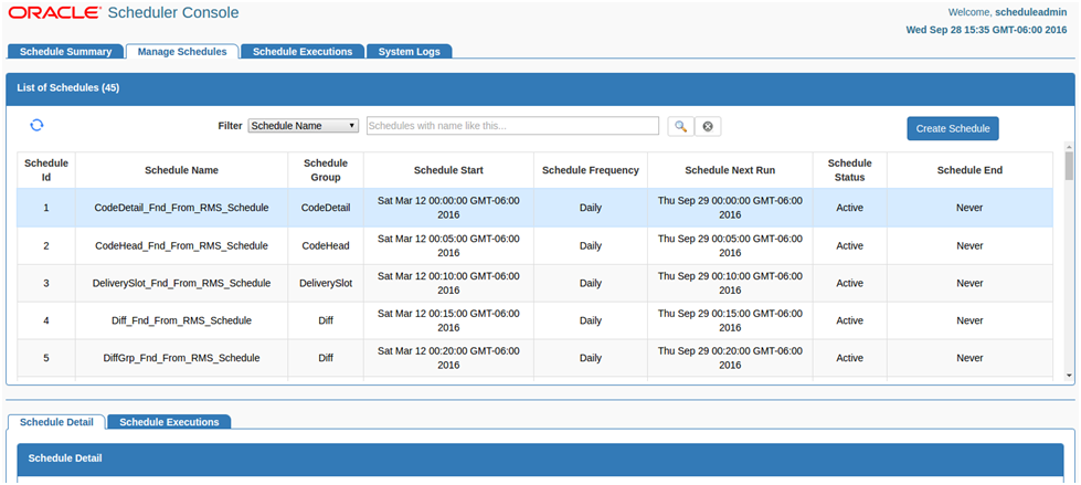

Launch the Scheduler admin app via the URL - http://<host>:<port>/bdi-scheduler/
Verify you are able to access the URL by logging in using the admin or operator role.
Verify that the list of schedules (created from seed data) is displayed in 'Manage Schedules' page of the app.
Ensure that all the schedules are in 'Active' status.
A schedule can be in 'Disabled' status if no schedule action is loaded for the corresponding schedule or if the schedule action contains any forbidden keyword. The user needs to correct the schedule action and enable the schedule. For more details on this, please refer to the Oracle Retail Bulk Data Integration Implementation Guide.
