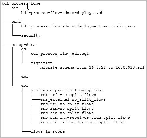

This command extracts the archive. The relevant directories for the installation are shown below (There are more directories than what is shown).

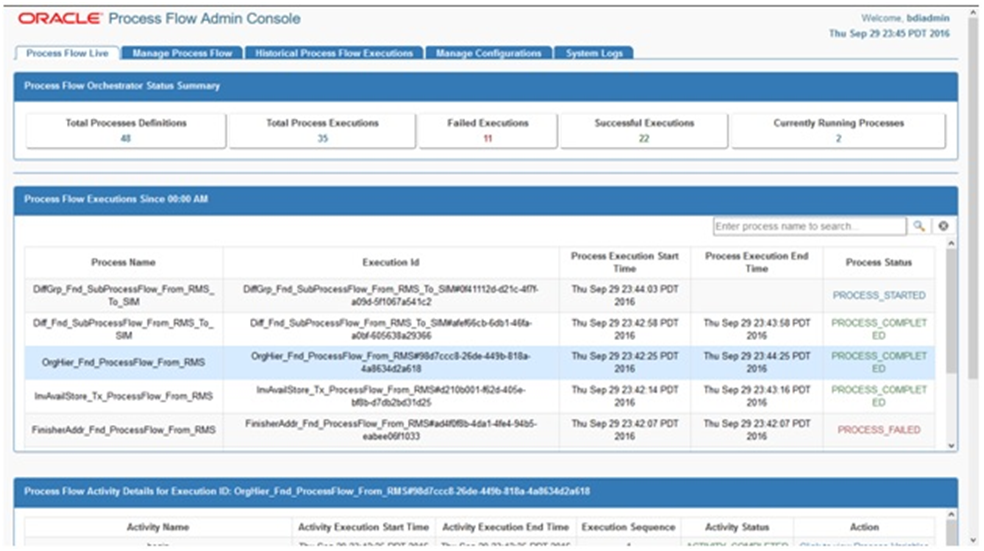

If the process flow app is successfully deployed, you should be able to access the application at the URL http://<host>:<port>/bdi-process-flow/. The following is a sample screenshot of the process flow application. Make sure all the tabs of the application are properly displayed.
