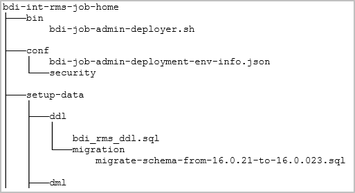

Download BdiIntJobAdminPak16.0.023ForRms16.0.023_eng_ga.zip to $BDI_HOME.
Unzip the downloaded archive.The Bdi Job home directory will be created under the current directory.
unzip BdiIntJobAdminPak16.0.023ForRms16.0.023_eng_ga.zip
This command extracts the archive. The relevant directories for the installation are shown (There are more directories than what is shown).

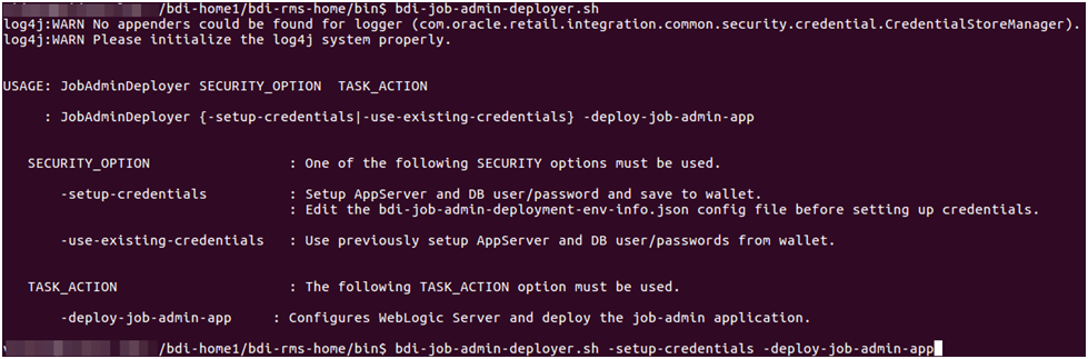

Run the deployer script to create the data sources and deploy BDI RMS Batch Job Admin.
cd bdi-int-rms-job-home/bin bdi-job-admin-deployer.sh -setup-credentials -deploy-job-admin-app
Enter the values prompted by the script for following credentials aliases. JobAdmin user has more privileges (e.g change configuration and run jobs from JobAdmin UI) than JobOperator user. JobOperator can run batch jobs where as JobMonitor has just read privileges.

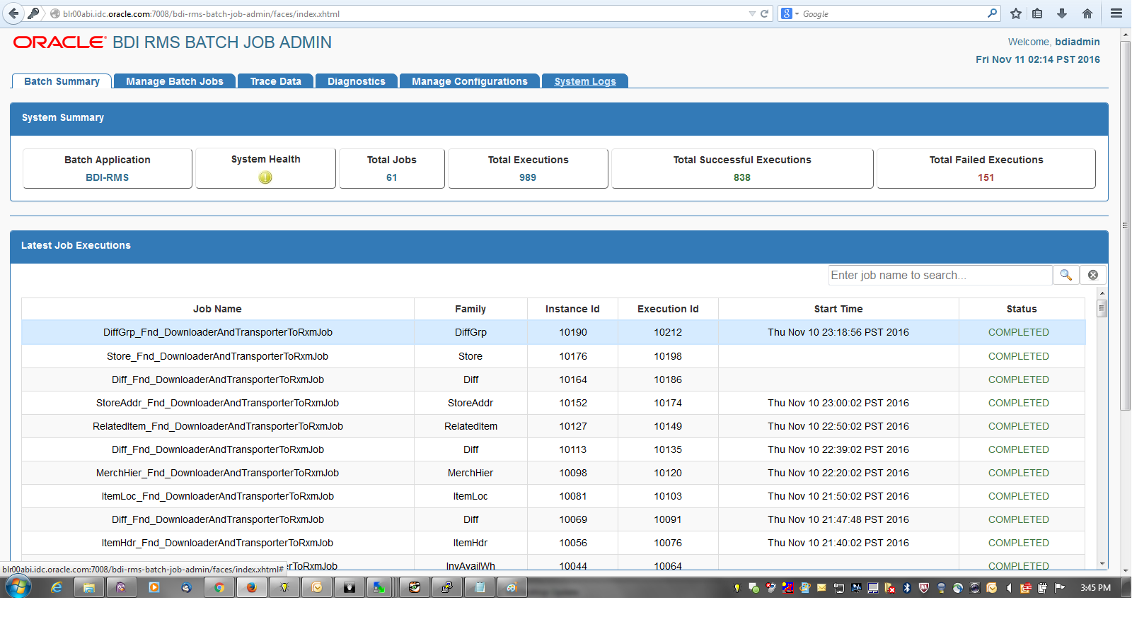

After you deploy to the server successfully, BDI RMS Batch Job Admin can be accessed using the following URL:
http://<server>:<port>/bdi-rms-batch-job-admin
Log in using credentials provided during the installation and verify that jobs are displayed in the Manage Batch Jobs tab and configuration is displayed in the Manage Configurations tab.

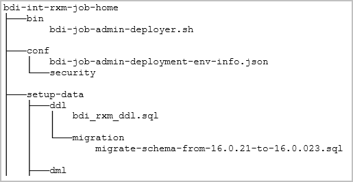

Download BdiIntJobAdminPak16.0.023ForRxm16.0.023_eng_ga.zip to $BDI_HOME.
Unzip the downloaded archive. The BDI Job home directory will be created under the current directory.
unzip BdiIntJobAdminPak16.0.023ForRxm16.0.023_eng_ga.zip

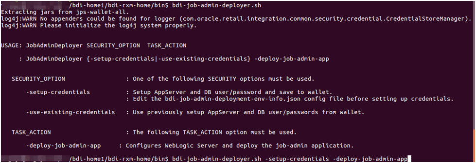

Run the deployer script to create the data sources and deploy BDI RXM Batch Job Admin.
cd bdi-int-rxm-job-home/bin bdi-job-admin-deployer.sh -setup-credentials -deploy-job-admin-app
Enter the values prompted by the script for the following credential aliases. JobAdmin user has more privileges(e.g change configuration and run jobs from JobAdmin UI) than JobOperator user. JobOperator can run batch jobs where as JobMonitor has just read privileges.

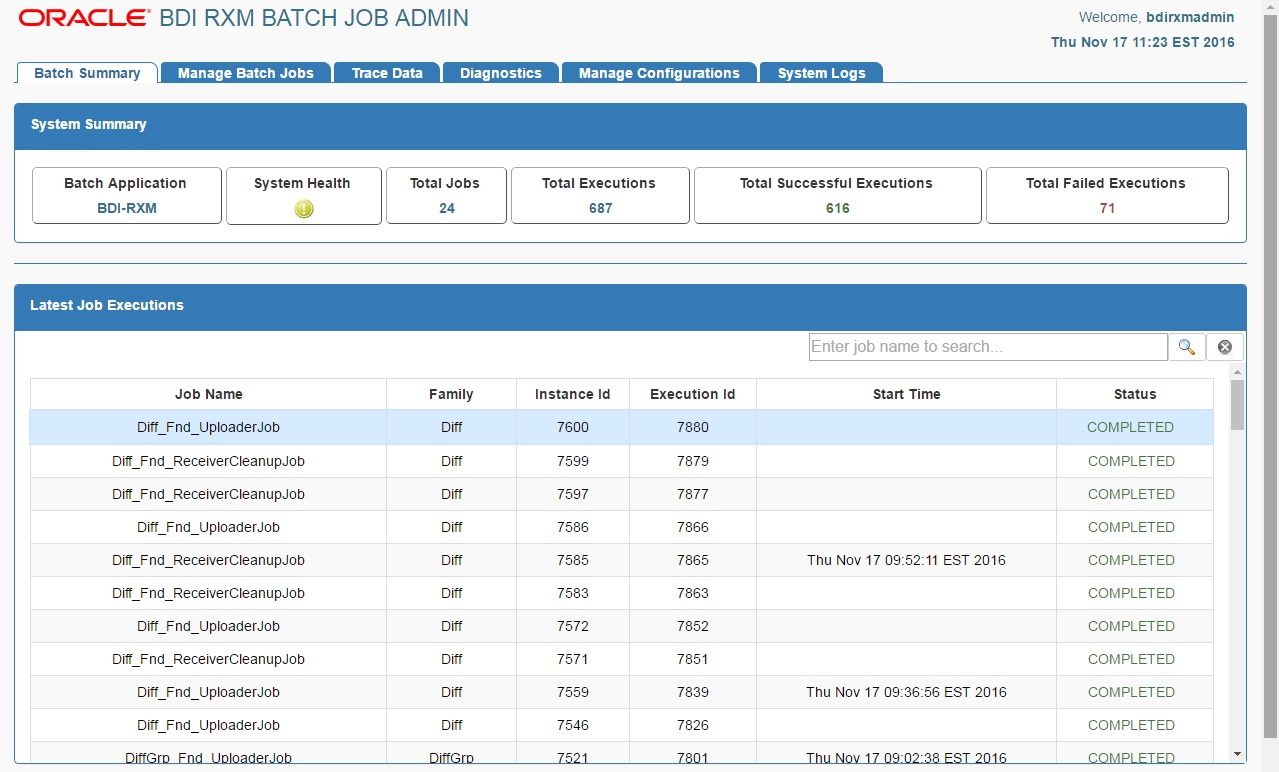

After you deploy to the server successfully, the BDI RXM Batch Job Admin can be accessed using the following URL:
http://<server>:<port>/bdi-rxm-batch-job-admin
