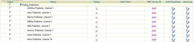

Support for Multiple JMS Servers Within a Single Deployment
Employing multiple JMS servers allows for the isolation of flows (for example, high volume versus low, custom versus base, and message families) for performance and operational QoS.

A new JMS server with jms-server-id="jms2" is added in rib-deployment-env-info.xml file as follows:

RIB-ADMIN-GUI
After deployment, check if the adapters configured point to the correct JMS server.
RIB GUI JMS server
