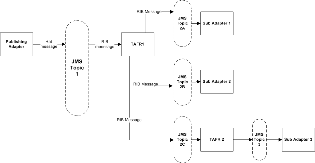

After initial publication, a message may require a series of transformation, filtering, or routing operations. The RIB component that implements these operations is known as a Transformation and Address Filter/Router (TAFR) component.
TAFR operation is specific to a message family and its set of subscribers. Multiple TAFRs may process a single message for a specific subscriber, and different specific TAFRs may be present for other subscribers. Separate sets of TAFRs are necessary for the various message families.
Multiple TAFRs may be needed, depending on the types of subscribers. The following diagram shows an example of the message flow with TAFR.
Surrounding text describes tafr_msgs.png.
TAFR Adapter Process
A Transformation Address Filter/Router (TAFR) adapter is used to perform operations on all messages from a single message family. The specific activities performed are dependent on the needs of its subscribers.
  • TAFRs in a message flow are an exception rather than the norm. (For example, a TAFR that does message transformation for only a single application is not recommended.) The subscribing application is responsible for filtering and transformation of the payload data.
  • Payload content based routing is not recommended as it degrades performance.
  • TAFR adapters take advantage of the RIB hospital.
  • Error messages are automatically retried by the hospital retry adapter.
  • The TAFR configuration makes most of the routing decision dynamic without requiring any configuration.
  • TAFRs are standard Java EE Message Driven Beans(MDB).
  • Custom TAFR business implementation can be easily plugged in by editing rib-tafr-adapters.xml.

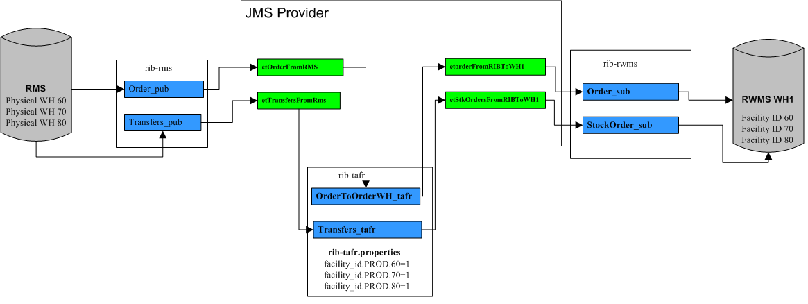

Single RWMS Configuration
RIB allows stock based transactions to be routed between different RWMS instances. An RWMS instance is assigned to a physical distribution center which may have one or more facilities assigned to it. A company may have one or more distribution centers.
By default the standard RIB configuration is set for a single RWMS instance. This means that all physical warehouses in RMS route directly to a single RWMS instance (in this case denoted as WH1) with each RMS physical warehouse directly correlating to a facility ID in RWMS.
Configuration Process
Complete the following steps.
  1. Modify the TAFR routing settings:
    • For each physical warehouse set up in RMS there should be a matching entry in the rib-tafr.properties file. This file resides in the $RIB_HOME/application-assembly-home/rib-tafr directory and is used by the TAFR adapters, amongst other things, to route messages by facility ID to the correct RWMS instances.
    • The file by default contains the following mappings:
      • facility_id.PROD.1=1
      • facility_id.PROD.2=1
      • facility_id.PROD.3=1
    • The routing properties are structured in the following way: facility_id.<FACILITY_TYPE>.<RMS_PHYSICAL_WH_ID>=<RWMS_INSTANCE_NAME>
      • <FACILITY_TYPE> - This should match the facility_type.default value in the rib-tafr.properties file. In most cases it is defaulted to PROD.
      • <RMS_PHYSICAL_WH_ID> - The physical warehouse ID from RMS.
      • <RWMS_INSTANCE_NAME> - The RWMS installation topic name identifier to which the warehouses messages is routed.
    • These mappings must be edited so that each physical warehouse in RMS has its own entry. The physical warehouses can be found by running the following query in the RMS schema:
      • SELECT wh FROM wh
        WHERE wh.wh = wh.physical_wh;
    • For the example in the diagram below, the query returns physical warehouse IDs 60, 70, and 80 .
    • There is only one RWMS instance (WH1) in this example, and the RWMS installation topic name identifier is 1. This corresponds to the name of the topics that RIB routes the messages to. It also is the default name suffix of the RWMS topics in the rib-integration-flows.xml file.
      Surrounding text describes single.png.
    • Therefore, mapping in the rib-tafr.properties file should read as follows:
      • facility_id.PROD.60=1
      • facility_id.PROD.70=1
      • facility_id.PROD.80=1

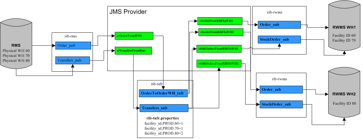

Two RWMS Configuration
Surrounding text describes jms_provider.png.
Description
RIB can be configured to route stock based transactions between multiple distribution centers, each with their own RWMS instance. The purpose of this is to only send stock transactions that are shipped to or from a certain warehouse to the distribution center that contains that warehouse (facility).
From RMS the user only has visibility to the warehouse that they are performing a stock shipment to or from. RIB TAFRs route the messages to the separate RWMS instances, based on the configuration stated in the rib-tafr.properties file. In the above example, RMS physical warehouses 60 and 70 are assigned to the RWMS instance called WH1, while RMS physical warehouse 80 is assigned to another RWMS instance called WH2.
    • For each physical warehouse set up in RMS there should be a matching entry in the rib-tafr.properties file. This file resides in the $RIB_HOME/application-assembly-home/rib-tafr directory and is used by the TAFR adapters, among other things, to route messages by facility ID to the correct RWMS instances.
      • <FACILITY_TYPE> - This should match the facility_type.default value in the rib-tafr.properties file (in most cases, PROD).
      • <RWMS_INSTANCE_NAME> - The RWMS installation topic name identifier to which the warehouses messages are routed.
      • SELECT wh FROM wh
    • Before editing the file for multiple RWMS instance routing, the user should know which RMS physical warehouses are to be routed to the particular RWMS instances and the RWMS installation topic name identifiers.
    • For the example, in the diagram above, physical warehouse IDs 60 and 70 are routed to RWMS instance WH1, where the RWMS installation topic name identifier is 1 and RMS physical warehouse ID 80 are routed to RWMS instance WH2, where the RWMS installation topic name identifier is 2. To support this, the mapping in the rib-tafr.properties file should read:
      • facility_id.PROD.80=2
  2. Modify the rib-integration-flows.xml file:
    • RIB requires information on how to route the messages between the two RWMS instances. This is done by adding new entries to the rib-integration-flows.xml file.
    • By default the file contains entries for the RWMS instance "rib-rwms" and all appropriate warehouse based adapter mappings point to the et<TOPIC_NAME>WH1 topics. When adding multiple RWMS instances all the entries for RWMS need to be duplicated for the second instance "rib-rwms2" and all adapter mappings for the new instance need to point to et<TOPIC_NAME>WH2 topics.
    • The entire RWMS PUBLISHERS section in the integration-flows.xml file needs to be duplicated and all new entries need to be changed to the second RWMS instance name of "rib-rwms2" for example:
      • <node id="rib-rwms2.ASNIn_pub" app-name="rib-rwms2" adapter-class-def="ASNIn_pub" type="DbToJms"><in-db>default</in-db><out-topic>etASNIn</out-topic></node>
    • Each RWMS adapter mapping in the file that follows the et<TOPIC_NAME>WH1 format needs to be duplicated as well but needs to point to et<TOPIC_NAME>WH2. With the original adapter mapping and the new adapter mapping to route to the second RWMS instance, for the Stock Order adapter, the entry should be similar to the following example:
      • <node id="rib-rwms.StockOrder_sub" app-name="rib-rwms" adapter-class-def="StockOrder_sub" type="JmsToDb"><in-topic>etStkOrdersFromRIBToWH1</in-topic><out-db>default</out-db></node>
      • <node id="rib-rwms2.StockOrder_sub" app-name="rib-rwms2" adapter-class-def="StockOrder_sub" type="JmsToDb"><in-topic>etStkOrdersFromRIBToWH2</in-topic><out-db>default</out-db></node>
    • The rib-integration-flows.xml file can be edited and then deployed in the following way:
      • cd $RIB_HOME/application-assembly-home/rib-func-artifacts
      • jar -xvf rib-func-artifact.war
      • cd integration
      • vi rib-integration-flows.xml
      • Make the changes specified above.
      • jar -uvf rib-func-artifact.war integration/rib-integration-flows.xml
  3. Deploy the settings to the rib-tafr instance:
    The new TAFR routing settings need to be migrated to the rib-tafr instance, to do this run the following script found in the $RIB_HOME/deployment-home/bin directory.
    rib-app-deployer.sh -deploy-rib-app-ear rib-tafr
  4. Deploy the settings to the functional artifact:
    The new integration flow settings need to be migrated to the rib-func-artifact instance, to do this run the following script found in the $RIB_HOME/deployment-home/bin directory.
    rib-app-deployer.sh -deploy-rib-func-artifact-war
Configuration should now be complete.
For every new physical warehouse added to RMS the rib-tafr.properties will require a new entry and the new settings will need to be deployed to the instance.
Multiple RWMS instances can be added as per the instructions above.
