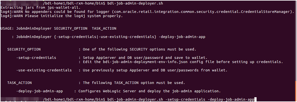

  5. Run the deployer script to create the data sources and deploy BDI RMS Batch Job Admin.
    cd bdi-edge-rms-job-home/bin
    bdi-job-admin-deployer.sh -setup-credentials -deploy-job-admin-app
    Surrounding text describes bdi-deploy.png.

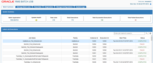

Testing the Deployment
After you deploy to the server successfully, BDI RMS Batch Job Admin can be accessed using the following URL:
http://<server>:<port>/rms-batch-job-admin
Log in using credentials provided during the installation and verify that jobs are displayed in the Manage Batch Jobs tab and configuration is displayed in the Manage Configurations tab.

  5. Run the deployer script to create the data sources and deploy BDI RXM Batch Job Admin.
    cd bdi-edge-sim-job-home/bin
    Surrounding text describes deployer.png.

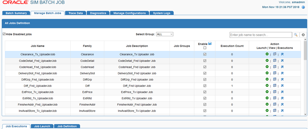

After you deploy to the server successfully, the BDI SIM Batch Job Admin can be accessed using the following URL:
http://<server>:<port>/sim-batch-job-admin
