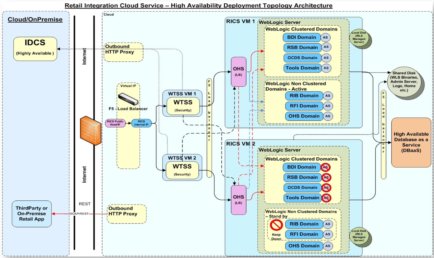

RIB is usually considered a high availability (HA) requirement, so an architecture and operations plan to handle this need is developed.
To fulfill the HA requirement for RIB, a useful feature was added to RIB that allows using single rib-home for multiple environments. There is a new script added in rib-home for setting up multiple environment from same rib-home. This script must be run before rib-app compilation. There will be different deployment file for each environment. For example, there are two WebLogic domains available: say node1 in RICS VM1 and node2 in RICS VM2. To deploy RIB on these two servers, rename the specific deployment file for that with an extension sample below.

Note: See the Oracle Retail Integration Bus Installation Guide: RIB High Availability Installation InstructionsSee the Oracle Retail Integration Bus Installation Guide: The RIB and Oracle Database Cluster (RAC) Oracle® WebLogic Application Server High Availability Guide Oracle® Database Administrator's Guide 12c Release 1 |
