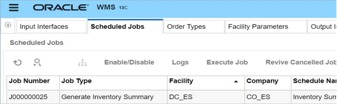

  1. Schedule a cycle count in WMS Cloud.
  2. Schedule a corresponding stock count in RMFCS for the same date/facility including all departments.
  3. Export the results of the count from WMS Cloud by scheduling an Inventory Summary export (see below for more information on scheduling jobs).
    Figure 4-1 WMS Scheduled Jobs
    WMS Scheduled Jobs

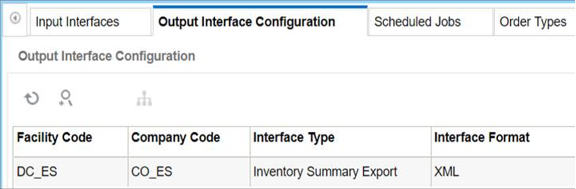

  4. Configure the output interface.
    Figure 4-2 WMS Output Interface Configuration
