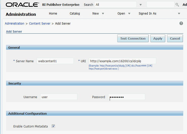

To set up a connection to a content server as a delivery destination:
