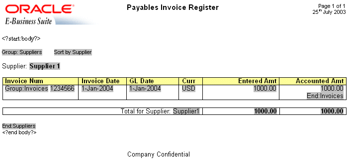

If the template requires multiple headers and footers, then create them by using BI Publisher tags to define the body area of the report. You may also want to use this method if the header and footer contain complex objects that you want to place in form fields. When you define the body area, the elements occurring before the beginning of the body area compose the header. The elements occurring after the body area compose the footer.
Use the following tags to enclose the body area of the report:
<?start:body?>
<?end body?>
Use the tags either directly in the template, or in form fields.
The Payables Invoice Register contains a simple header and footer and therefore does not require the start body/end body tags. However, if you wanted to add another header to the template, define the body area.
To define the body area:
  1. Insert <?start:body?> before the Suppliers group tag:
    <?for-each:G_VENDOR_NAME?>
  2. Insert <?end body?> after the Suppliers group closing tag:
    <?end for-each?>
The following figure shows the Payables Invoice Register with the start body/end body tags inserted:
