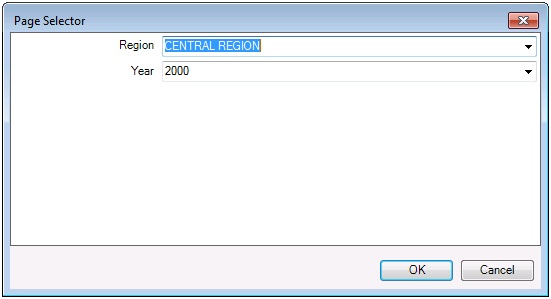

pageSelections: The order of the page selection stored in the string array should be same as the order the page selections appear in the Page Selector dialog box. For example, to specify the page selections shown in Figure 16-2, use the sample code that follows the figure.
Figure 16-2 Page Selector Dialog Box with Selections for Region and Year
Dim pageSelections(0 To 1) As String pageSelections (0) = "CENTRAL REGION" pageSelections (1) = "2000"
