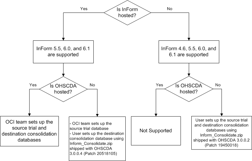

2.1 Adding InForm Studies to the OHSCDA Warehouse
You must perform the tasks in this section only if:
  • You have InForm as a source
  • It is a fresh installation of OHSCDA
Figure 2-1 displays the OHSCDA InForm consolidation installation scenarios.
Figure 2-1 OHSCDA InForm Consolidation Installation Scenarios
Description of Figure 2-1 follows
Description of ''Figure 2-1 OHSCDA InForm Consolidation Installation Scenarios''
You can download the OHSCDA patch from My Oracle Support (https://support.oracle.com).

This section describes the steps to create the Consolidation Schema. As part of the process, it enrolls an initial InForm study as a source to be consolidated.
  • If you are using the OHSCDA 3.0.0.2 patch, you must set up both the source trial and destination consolidation databases.
  • If you are using the OHSCDA 3.0.0.4 patch, you must only set up the destination consolidation database.
