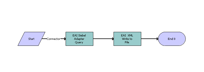

Siebel Automotive Guide > Managing End of Lease and Remarketing Activities > Workflow Process Reference for Vehicle Remarketing > eAuto CF Lease End Comm2 XML Generation Workflow ProcessThis workflow process generates an XML file that includes all the financial account records for the second lease-end communication. It is triggered by scheduling job with Workflow Process Manager. Schedule Start should be set to a time that allows time to complete the batch job set for eAuto CF Lease End Communication Workflow Process. This workflow process is shown in Figure 11. Workflow Process Description. This workflow process performs the following actions: |
