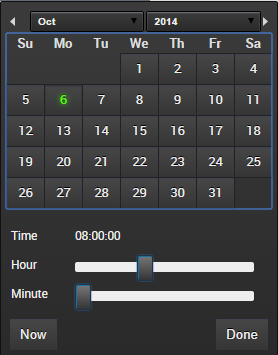

You use the calendar control to select date and time information for a field. You access the calendar control by clicking the calendar select button in a date field or a date and time field.
Figure 4-6 shows an example of the calendar control.
Note: The current date is not assumed as the default when using the calendar control. An explicit click is required to make a selection. |
Table 4-2 describes each element of the calendar control.
Table 4-2 Description of Calendar Control Elements
| Element | Description |
Month and Year |
Shows the month and year. Use the navigation arrows to go to the next and previous month. Use the drop-down arrow next to the month to select a different month, and use the drop-down arrow next to the year to select a different year. |
Calendar |
Shows the calendar for the month. Use the calendar to select a date by clicking the date in the calendar. |
Time field |
Shows the time. This field appears only if you access the calendar control for a field that requires a time. |
Hour slide bar |
Sets the hour in the Time field. This field appears only if you access the calendar control for a field that requires a time. |
Minute slide bar |
Sets the minute in the Time field. This field appears only if you access the calendar control for a field that requires a time. |
Now button |
Sets the value for a date field to the current date and the value for a date and time field to the current date and time. |
Done button |
Saves your selections. If you do not want to save your selections, then click outside of the control to cancel your selections. |
