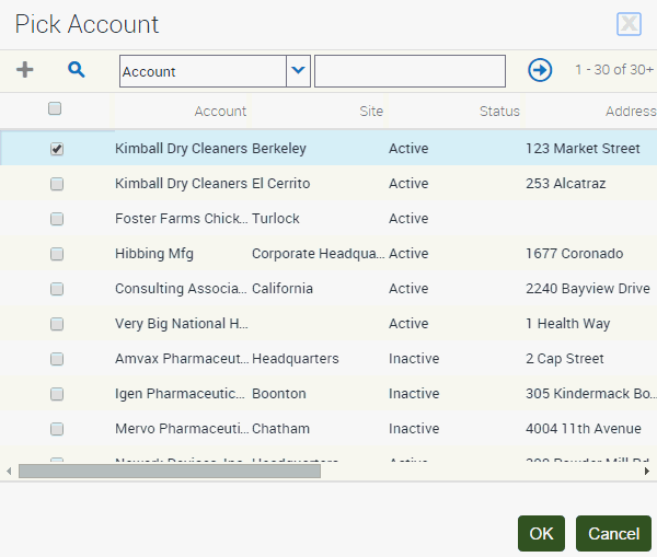

On different screens in the application, you can associate a record with an existing record in a single selection dialog box and with a new record in a single selection dialog box.
Figure 5-1 shows an example of a single selection dialog box.
Complete the procedure in this topic to associate a record with an existing record in a single selection dialog box.
To associate a record with an existing record in a single selection dialog box
Navigate to the appropriate screen.
Select the record you want to associate with another record.
Click the single select button in the appropriate field.
A single selection dialog box appears.
In the dialog box, locate and select the record you want to associate with the existing record.
Click OK.
Complete the procedure in this topic to associate a record with a new record in a single selection dialog box.
Note: In some situations, you cannot add new records in single selection dialog boxes. |
To associate a record with a new record in a single selection dialog box
Select the record you want to associate with a new record.
Click New (the plus (+) icon).
The form for the new record appears.
In the form, enter the information for the new record, and click Save.
The new record appears in the single selection dialog box, and this new record is selected.
Click OK.
