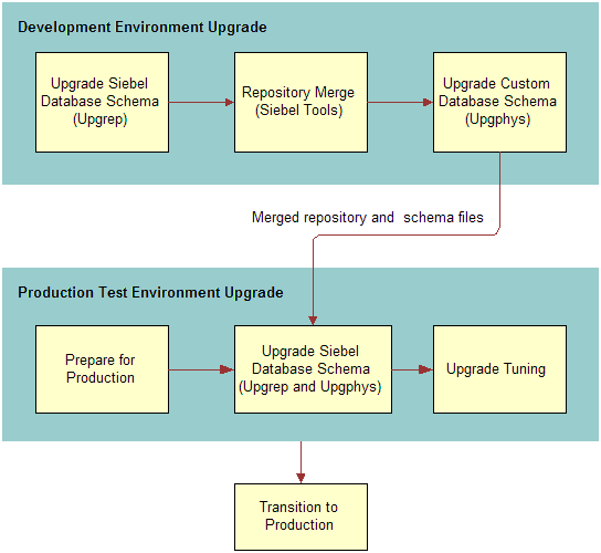

Figure 1 shows how the Database Configuration Wizard (and Upgrade Wizard) work together with the Siebel Tools repository merge to upgrade your environments.
Figure 1. Upgrade Flow
Development Environment Upgrades
For a development environment upgrade, you run the utility twice, once in each of the following modes:
  • upgrep. This mode makes the following changes:
    • Removes interface tables and database triggers.
    • Populates columns that must change from NULL to NOT NULL.
    • Creates new tables. Merges existing tables.
    • Prepares for index creation. Verifies that there are no unique key violations.
    • Creates indexes.
      NOTE:  Indexes that have been previously deactivated will be recreated during the upgrep phase. Check to determine whether these indexes are required following the development upgrade. If they are not, then they might be deactivated again. To deactivate indexes, contact your Oracle sales representative for Oracle Advanced Customer Services to request assistance from Oracle's Application Expert Services.
    • Imports seed data.
    • Imports the Prior Siebel Repository, New Siebel Repository, and New Customer Repository.
    • Makes modifications to repository objects to prepare for the repository merge.
    • Updates primary children foreign key references.
    • Performs miscellaneous file actions.
  • upgphys. This mode makes the following changes:
    • Synchronizes the Siebel database schema to the logical schema definition in the merged repository.
    • Deduplicates intersection tables.
    • Exports repository object definitions to a file, custrep.dat.
    • Exports the logical schema definition to a file, schema.ddl.
      These two files are used as input to the production test environment and production environment upgrades.
    • Renames the New Customer Repository to Siebel Repository.
    • Updates the schema version in S_APP_VER.
Production Test Environment Upgrades
For a production test environment upgrade, you run the utility three times:
  • Prepare for production.
    NOTE:  This topic is only applicable for upgrades from Siebel CRM release 7.5.3. For upgrades from later releases, you do not have to perform this step.
    This mode does the following in the production test database:
    • Examines the development environment database and generates SQL that deduplicates intersection tables and sets up support for database aggregation.
      In the production test environment, you must define an ODBC connection to the development environment database before performing this upgrade step.
    • Compares the repository schema and the physical database schema. Generates a file that lists indexes present in the physical schema that are not present in the repository schema. You can decide whether to remove these indexes.
    • Uses the custrep.dat and schema.ddl files from the development environment upgrade to create new tables and merge existing tables
    • Creates indexes
    • Imports seed data
    • The upgphys portion runs automatically. It makes several administrative changes to table data, including updating the schema version in S_APP_VER.
  • Upgrade Tuning. These steps are optional. You can use the Logparse utility to tune the SQL generated for the upgrade. Logparse identifies SQL commands that are not used, or that can be run in parallel. This reduces the time required to perform the production database upgrade.
    You can also test the Additive Schema Changes script to verify that it does not adversely affect the operation of the application. Additive Schema Changes allows you to run part of the schema upgrade without taking the database offline. This reduces production database downtime.
Production Environment Upgrades
After you have completed testing applications and have tuned the upgrade SQL commands, you perform the production upgrade. The production upgrade uses the SQL commands generated in the production test environment. In the production test environment, you perform the following steps to upgrade your production environment Siebel database:
  • Define an ODBC connection to the production environment Siebel database
  • Apply Additive Schema Changes. This step is optional and is run in the production environment. You can run this mode of the Database Configuration Utilities without taking the database offline. This mode makes schema changes that do not affect the operation of the application. This reduces the amount of time the production database must be offline to perform the upgrade.
  • Prepare for Production. This step is not required. You ran it as part of the production test environment upgrade. The required changes have already been made to the upgrade SQL commands.
  • upgrep. Run the Database Configuration Utilities in the production test environment. Enter information for the production environment (not the production test environment), including the new ODBC definition.
    The Database Configuration Utilities update the upgrade configuration file with production environment information. A lock file that was set when you ran the utility previously, prevents new SQL from being generated. This preserves the SQL you have revised and tuned.
    When you run the Upgrade Wizard, it reads the production environment information from the configuration file and uses the production test environment SQL commands to upgrade the production environment Siebel database.
    The upgrep step makes the same changes as when it ran in the production test environment. This includes automatically running the production upgphys portion of the upgrade.
