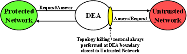

Diameter Edge Agent (DEA) Topology Hiding procedures are always invoked on the interface closest to an Untrusted Network, as illustrated in Figure 10-1.
Figure 10-1 Diameter Topology Hiding Boundary

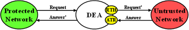

The high level logical locations of the RTH and ATR TH Trigger Points for Protected-to-Untrusted Network Diameter transactions are shown in Figure 10-2.
Figure 10-2 Diameter Topology Hiding Trigger Points: Protected-to-Untrusted Transactions

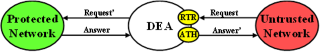

The high level logical locations of the RTR and ATH TH Trigger Points for Untrusted-to-Protected Diameter transactions are shown in Figure 10-3.
Figure 10-3 Diameter Topology Hiding Trigger Points: Untrusted-to-Protected Transactions
