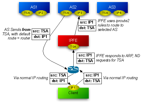

When the IPFE routes packets to application servers, it does not perform any rewriting of the packet. Figure 3-2 shows that neither the source IP address nor the destination IP address changes as it passes through the IPFE. The IPFE behaves as an IP router and does not act as a network address translator (NAT).
Figure 3-2 Packet Routing Through and Around the IPFE
