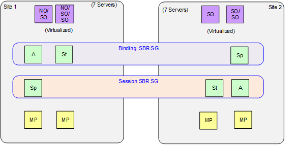

The smallest supported Mated Pair of PCA DSRs, illustrated in Figure 3-9, has certain characteristics:
  • The NOAM servers are deployed at Site 1 using Active/Standby redundancy.
  • The Site 1 SOAM servers are deployed at Site 1, virtualized on the same servers with the NOAM servers. They, however, use the Active/Standby/Spare redundancy model, with the Spare server deployed at Site 2 and virtualized on the same server with one of the Site 2 SOAM servers.
  • The Site 2 SOAM servers are deployed at Site 2 using the Active/Standby/Spare redundancy model. The Spare Site 2 SOAM server is virtualized at Site 1 on one of the servers already hosting an NOAM and a Site 1 SOAM server.
  • A Binding SBR triplet is deployed with two servers at Site 1 and one server at Site 2.
  • A Session SBR triplet is deployed with 1 server at Site 1 and two at Site 2
  • Two DA-MPs are deployed at each site to support server redundancy at each site.
Figure 3-9 Smallest Supported PCA Mated Pair

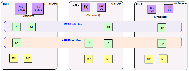

The smallest supported mated triplets of PCA DSRs, illustrated in , has certain characteristics:
  • The Site 1 SOAM server are deployed at Site 1, virtualized on the same servers with the NOAM servers. However, the use the Active/Standby/Spare/Spare redundancy model, with the spare server deployed at Site 2 and Site 3 and virtualized on the same server with one of the Site 2 SOAM servers.
  • The Site 2 (and Site 3) SOAM servers are deployed at Site 2 (and Site 3) using the Active/Standby/Spare/Spare redundancy model. The spare Site 2 SOAM server is virtualized at Site 1 on one of the servers already hosting an NOAM and a Site 1 SOAM server.
  • A binding SBR triplet is deployed with two servers at Site 1 and one server each at Site 2 and Site 2 respectively.
  • A session SBR triplet is deployed with two servers at Site 2 and one server each at Site 1 and Site 3 respectively.
  • Two DA-MP servers are deployed at each site to support server redundancy at each site.
Figure 3-10 Smallest Supported PCA Mated Triplets
