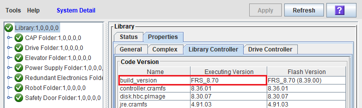

On SLC (SL500, SL3000, and SL85000)
In the Tools menu, select System Detail.
In the navigation tree, select Library.
Select the Properties tab, then select the Library Controller tab.
