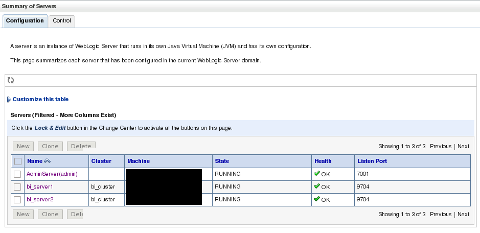

Migrate JMS Service on BIP Cluster
In a BIP cluster, scheduled reports will fail if the active server is down. If the server running the JMS service fails, migrate the JMS service to restore BIP scheduling.
The following
examples assume BI Publisher has been installed as a cluster using the
Enterprise Install option on the first node and the Scale Out option on
subsequent nodes.
WARNING:
The JMS must not be running during this migration.
