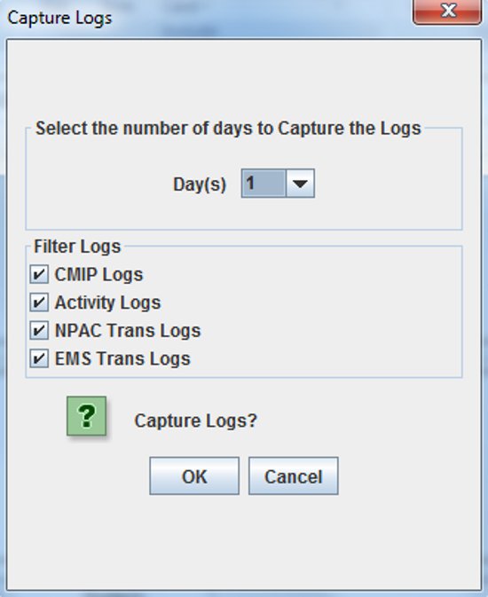

  2. From the menu, select Logs>Capture Logs.
  3. Select the number of days for which you want to capture the logs, as well as the specific logs, and click OK.
