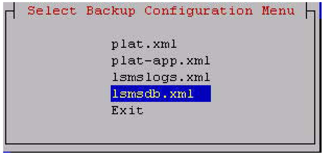

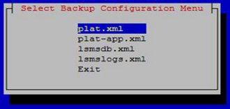

  5. From the Main Menu on the active server, select Maintenance > Backup and Restore > Network Backup.
    The Select Backup Configuration Menu is displayed.
    Figure 1. Select Backup Configuration Menu
    • plat.xml is provided by TPD and is used to back up all platform files (such as log, pkg, and rcs files) from LSMS to NAS.
    • plat-app.xml is provided by LSMS and is used to back up all platform files (such as log, pkg, and rcs files) from LSMS to NAS.
    • lsmsdb.xml is used to back up the LSMS database on NAS.
    • lsmslogs.xml is used to back up the LSMS logs on NAS.
    • Exit returns control to the Backup and Restore menu.
    Select plat.xml as shown.

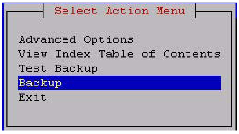

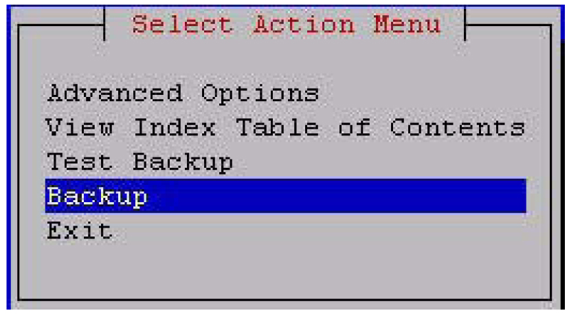

  6. Press Enter and the Select Action Menu is displayed.
    Figure 2. Select Backup on Active Server
    • Advanced Options enables specification of backup host details, the archive directory, the repository, and other options. For example:
      Backup Host: backupserver
      Backup Host user: root
      Archive directory: /Volumes/LVstorage
      Repository: logs (automatically selected based on the type of backup selected previously)
      Depth: 5 (numerical value, use of 1-5 is suggested)
      Prune: (*)Yes or ()No
    • View Index Table of Contents lists the data to be backed up.
    • Test Backup performs a test backup.
    • Backup performs backup of LSMS data on NAS.
    Select Backup as shown.

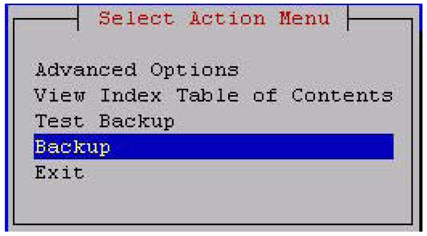

  9. Select plat.xml on the standby server, and press Enter.
    Figure 4. Select plat.xml on Standby Server
  10. Select Backup.

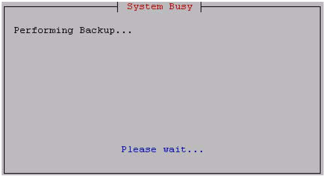

    Figure 6. Performing Backup Screen

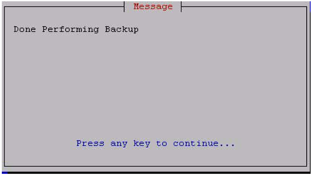

  11. When the backup is complete, press any key to continue.
    Figure 7. Backup Complete on Standby Server

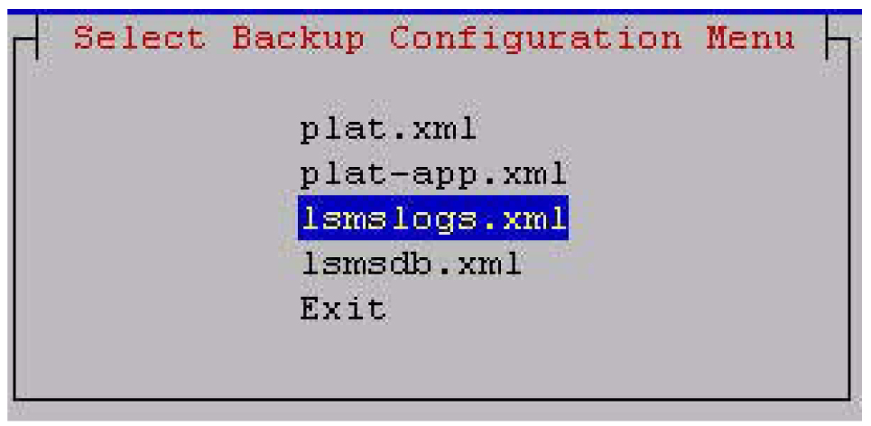

  12. Select lsmslogs.xml on the standby server, and press Enter.
    Figure 8. Select lsmslogs.xml on Standby Server

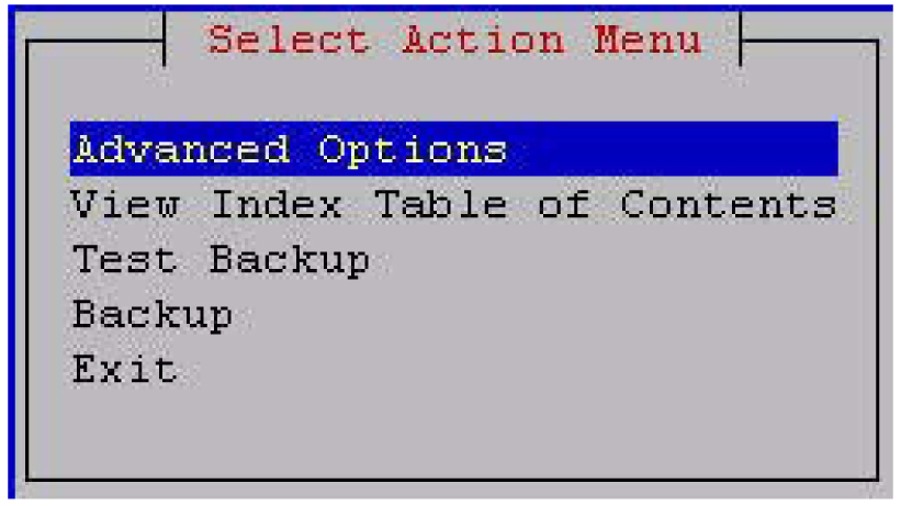

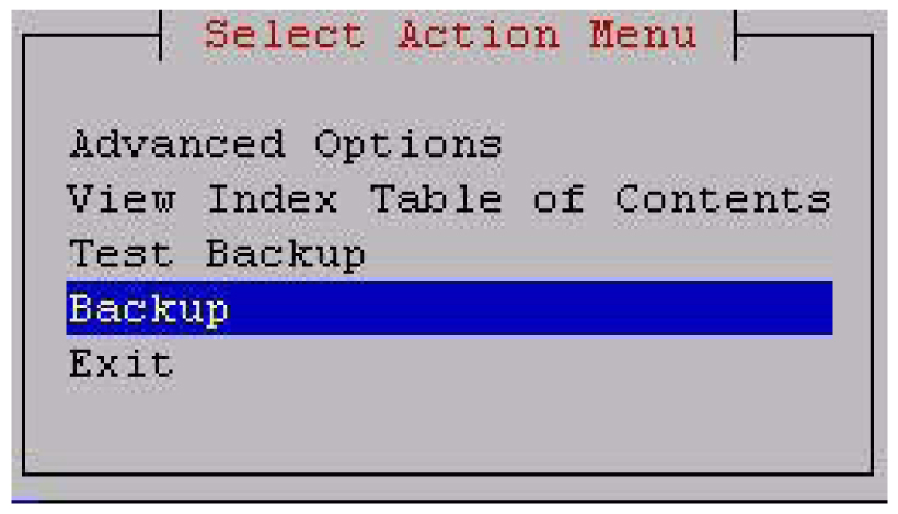

  16. When the server has completed loading the Select Action Menu displays.
    Figure 12. Select Action Menu
  17. Select Backup, and press Enter.
    Figure 13. Backup
