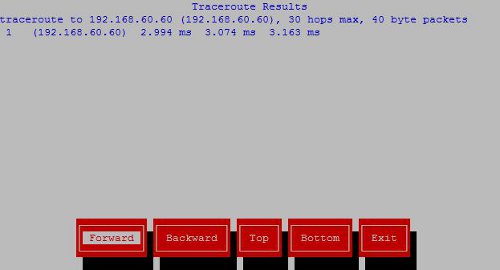

    The results display in a window similar to the following.
    Figure 2. TraceRoute Results
  4. The output depends on how many hops exist between the server you logged into and the IP address you entered.
    To interpret output similar to the following example, see Table 1.
    traceroute to 198.89.34.19 (198.89.34.19), 30 hops max, 40 byte packets
     1  192.168.51.250 (192.168.51.250)  2 ms  2 ms  2 ms
     2  198.89.39.250 (198.89.39.250)  3 ms  4 ms  1 ms
     3  198.89.34.19 (198.89.34.19)  5 ms *  4 ms
