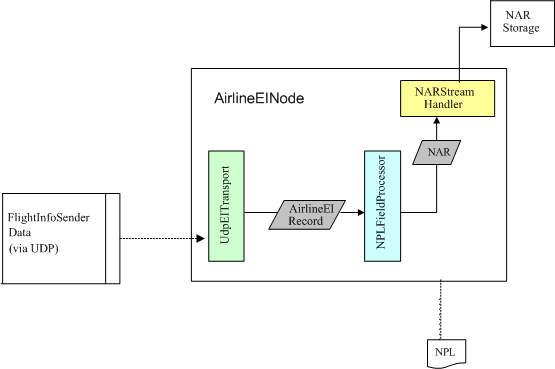

Now we will implement the AirlineEINode itself. We have a template, EINodeTmpl.java, which can be used to start creating the AirlineEINode.
AirlineEINode will implement a warm restart capability, which means that this node must implement startup() and reconfigure() these two methods.Construct AirlineEINode with warm restart implemented.
Construct the node with no operation.
public AirlineEINode( String[] args ) throws NodeStartException {
super(args);
Override method warmRestartImplemented() to return true.
Implement startup() method.
Get all the config information of this node.
Construct the UdpEITransport as described in step 2, which will utilize the record factory created in Step 3 in "Create AirlineEINode (CC Node)".
// Create record factory
String nid = getNodeId();
recordFactory = new AirlineRecordFactory(nid, this);
// Create the Transport
UdpEITransport eiTransport = new UdpEITransport(this,
recordFactory,
udpListenPort,
maxPacketSize,
queueSize);
setTransport(eiTransport);
Construct an NPLFieldProcessor.
// Set the FieldProcessor
Class NARClass = (new NAR()).getClass();
try {
setFieldProcessor(new NPLFieldProcessor(NARClass, this,
scratchDir.getAbsolutePath(), NPLFile)
catch (NodeProcessingException npex)
throw new NodeStartException(npex.getMessage());
Set up appropriate receivers and providers relationship.
UdpEITransport requires a ”pull” data transfer model.getFieldProcessor().setDataProvider(getTransport()); getFieldProcessor().setDataReceiver(getDCStreamHandler());
Start the appropriate components.
// Start the threads setTransportThread(getTransport()); getTransportThread().start(); setFieldProcessorThread(getFieldProcessor()); getFieldProcessorThread().start();

Write the NPL file for this node. In a CC node this should be primarily mapping to NAR attribute. Following is the NPL file, airline.npl, for AirlineEINode:
InputRec {
Integer Passenger_ID;
Integer Flight_Number;
Integer Depart_Airport_ID;
Integer Arrive_Airport_ID;
TimeInSecs Depart_TIS;
TimeInSecs Arrive_TIS;
Integer Number_Bags;
} in;
OutputRec {
Integer 0;
Integer 1;
Integer 2;
Integer 3;
TimeInSecs 4;
TimeInSecs 5;
Integer 6;
} out;
out.0 = in.Passenger_ID;
out.1 = in.Flight_Number;
out.2 = in.Depart_Airport_ID;
out.3 = in.Arrive_Airport_ID;
out.4 = in.Depart_TIS;
out.5 = in.Arrive_TIS;
out.6 = in.Number_Bags;
write(out);

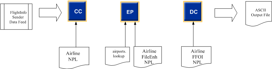

Now AirlineEINode is finished. We need to work on EP nodes and DC nodes. When all the nodes are created, we will modify/create the appropriate property files. So we can create those nodes with Node Creation Wizard.
You have finished creating the AirlineEINode. You still need to create EP node and DC nodes to set up a node chain to process the airline passenger data.
The EP node will read information from a file to add two additional attributes to each NAR:
Departure Airport Name
Arrival Airport Name
These values will be read from a ”airports.lookup” file which maps the (integer) Airport ID to the Airport Name. The EP node will be FileEnhancer node, which is included in CDK.
airports.lookup file contents:
1000=Logan International Airport
1001=O'Hare International Airport
1002=John F. Kennedy International Airport
1003=Orlando International Airport
1004=Baltimore/Washington International Airport
1005=Bangor International Airport
1006=Portland International Airport
1007=St. Louis Regional Airport
1008=Honolulu International Airport
1009=Austin-Bergstrom International Airport
1010=Dallas/Fort Worth International Airport
1011=LaGuardia International Airport
1012=Los Angeles International Airport
1013=San Francisco International Airport
1014=Manchester Airport
1015=Seattle-Tacoma International Airport
1016=Juneau International Airport
The DC node will simply output all the records to an ASCII file. The DC node will be FFOINode, which is also included in CDK.
In this case, we only need to write NPL rules files for both EP and DC nodes.

Write NPL file, ffoi_airline.npl, for the DC node that simply maps all of the NAR attributes from the input record (total of 9) to the output record.
Now, it is time to modify/create the node template definitions.
First we will add the new Airline nodes to the nodeTemplateDef.xml file in the customization directory (OMC_Home/customization/nodeTemplateDef.xml, where OMC_Home is the directory in which you installed Offline Mediation Controller.)
<nodetemplate id="Airline#EI#AirlineEINode">
<name>Airline CC</name>
<property name="Solution">cartridgekit</property>
<rule id="airline.npl">
<name>Airline Passenger</name>
<nplfile>airline.npl</nplfile>
</rule>
<nodeclass>com.nt.udc.ei.node.airline.AirlineEINode</nodeclass>
</nodetemplate>
<nodetemplate id="Airline#EP#AirlineEPNode">
<name>Airport Name EP</name>
<property id="Solution">cartridgekit</property>
<rule id="AirportEnh.npl">
<name>Airport Name</name>
<nplfile>AirportEnh.npl</nplfile>
</rule>
<nodeclass>com.nt.udc.processor.FileEnhancer.FileEnhancerNode</nodeclass>
</nodetemplate>
<nodetemplate id="Airline#OI#AirlineOINode">
<name>ASCII DC</name>
<rule id="ffoi_airline.npl">
<name>Airline</name>
<nplfile>ffoi_airline.npl</nplfile>
</rule>
<nodeclass>com.nt.udc.oi.node.flatfile.FFOINode</nodeclass>
</nodetemplate>
Next we will add the node templates to the GUI using the nodeGroupDef.xml file in the customization directory (OMC_Home/customization/nodeGroupDef.xml, where OMC_Home is the directory in which you installed Offline Mediation Controller.)
<nodetemplategroup>
<name>Airline Example</name>
<nodetemplategroup>
<name>Collection Cartridge (CC)</name>
<nodetemplate id="Airline#EI#AirlineEINode"/>
</nodetemplategroup>
<nodetemplategroup>
<name>Enhancement Processor (EP)</name>
<nodetemplate id="Airline#EP#AirlineEPNode"/>
<nodetemplategroup>
<name>Distribution Cartridge (DC)</name>
<nodetemplate id="Airline#OI#AirlineOINode"/>
Finally add the NPL rule files
Create directory OMC_Home/rules/Airline/EI/Airline and copy airline.npl to this directory.
Create directory OMC_Home/rules/Airline/Processor/FileEnhancer and copy AirPortEnh.npl to this directory.
Create directory OMC_Home/rules/Airline/OI/FlatFile and copy ffoi_airline.npl to this directory.
Where OMC_Home is the directory in which you installed Offline Mediation Controller
At this point, we have finished creating/modifying the appropriate node template files. We are able to start the client GUI and use Node Creation Wizard to create our Airline Flight node chain.
Before we can start our Airline Flight node chain, we need to start the FlightInfoSender simulator, which will send the simulated airline passenger data via UDP.
