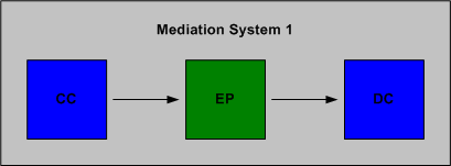

In Scenario 1, System 1 is the original Offline Mediation Controller system that exists in the customer environment, as shown in Figure 5-1. The core nodes are shown in blue and a custom node is shown in green.
Figure 5-1 Original Offline Mediation System 1
Description of Figure 5-1 follows
Description of ''Figure 5-1 Original Offline Mediation System 1''

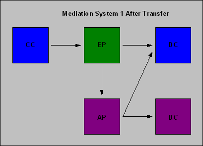

  6. Import the configuration from System 2.
    System 1 now appears as in the following diagram.
Description of cdk_system_aftertransfer.gif follows
Description of the illustration ''cdk_system_aftertransfer.gif''

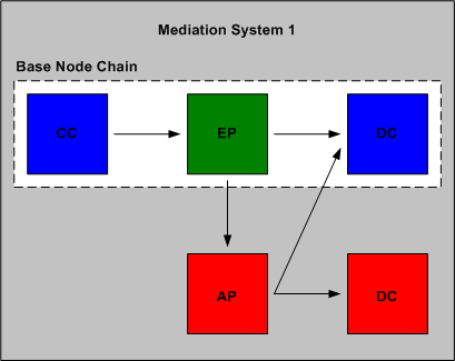

In Scenario 2, System 1 has a base node chain and a secondary node chain that contains custom nodes, shown in red in Figure 5-3.
Figure 5-3 Offline Mediation System 1
Description of Figure 5-3 follows
Description of ''Figure 5-3 Offline Mediation System 1''

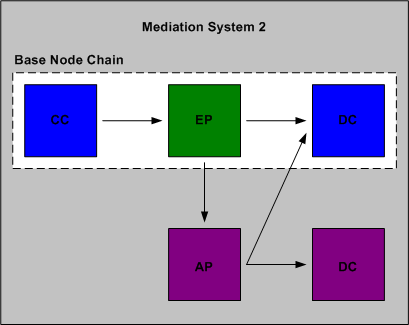

System 2 has the same base node chain as System 1 but with a secondary node chain that contains custom code, shown in purple in Figure 5-4.
Figure 5-4 Offline Mediation System 2
Description of Figure 5-4 follows
Description of ''Figure 5-4 Offline Mediation System 2''

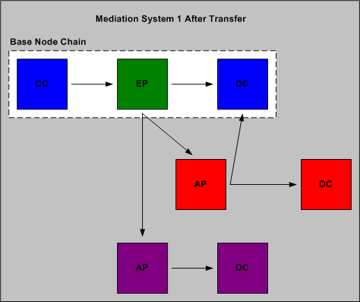

On System 1
  1. Ensure all data in the node chain has been processed, then delete the routing link between the EP node on the base node chain and the AP node on the secondary node chain.
  2. Delete the base node chain.
  3. Stop the Node Manager, Administration Server, and GUI.
  4. On System 1, untar the following directories into the following locations:
    • OMC_Home_2/cartridges into OMC_Home_1/cartridges
    • OMC_Home_2/customization into OMC_Home_1/customization
  5. Start the Node Manager, Administration Server and GUI.
    After the update, there is no routing link between the EP node of the base node chain and the AP node of the secondary node chain. You must manually restore this link via the Administration GUI.
Description of cdk_system1_aftertransfer2.gif follows
Description of the illustration ''cdk_system1_aftertransfer2.gif''
