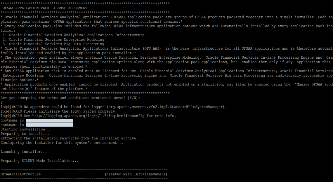

·        Install the OFS MRMM Application Pack

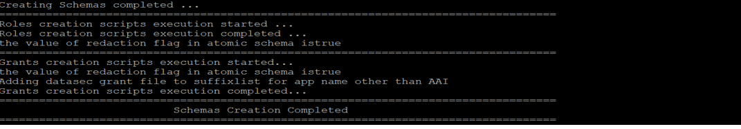

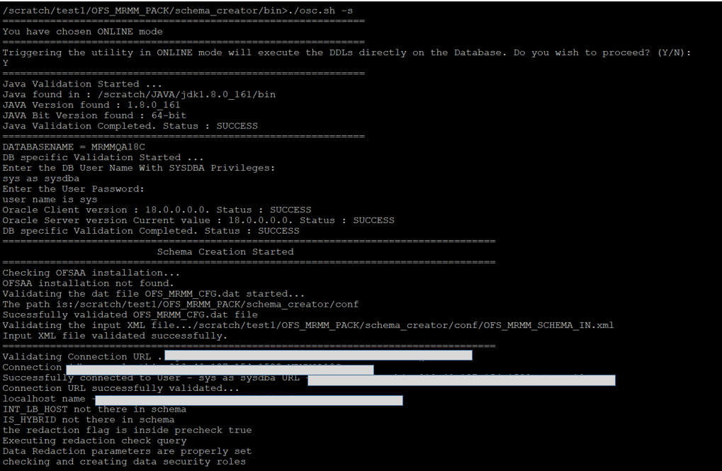

Execute the Schema Creator Utility in Online, Offline modes and verify the log file.

Configure the OFSAAI_InstallConfig.xml file.
6
Trigger the application installation.

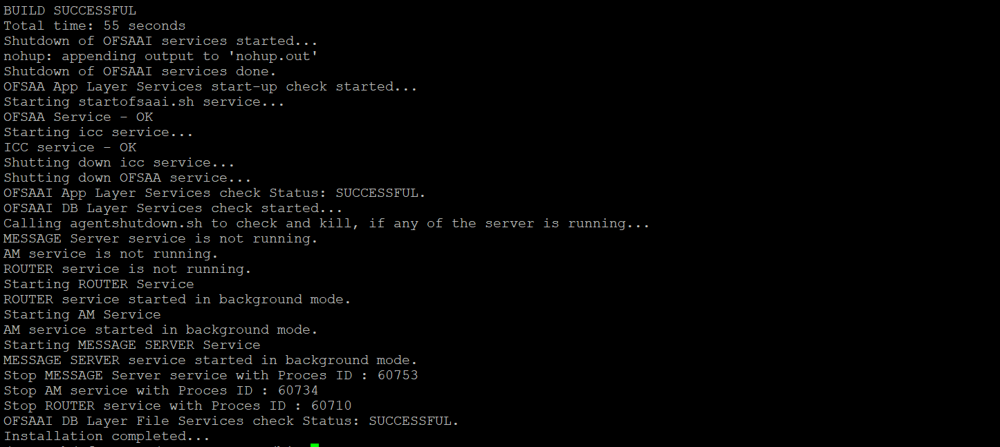

7
Verify the installation logs.

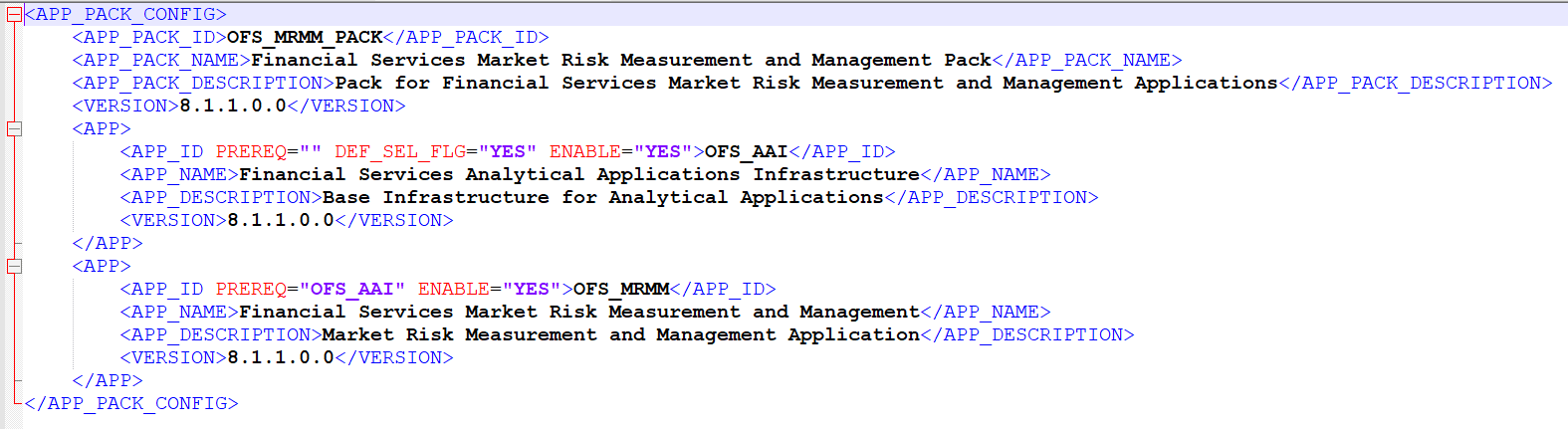

Configure the OFS_MRMM_PACK.xml File
The OFS_MRMM_PACK.xml file contains details on the various products that are packaged in the MRMM Application Pack. This section details the various tags and parameters available in the file and the values that must be updated. Before installing the MRMM Application Pack, it is mandatory to update this file.
To configure the OFS_MRMM_PACK.xml file, follow these steps:
1.     Navigate to the OFS_MRMM_PACK/conf directory.
2.     Open the OFS_MRMM_PACK.xml file in a text editor.
Figure 5: Sample OFS_MRMM_PACK.xml File
Description of Sample OFS_MRMM_PACK.xml File follows This illustration shows a sample of the OFS_MRMM_Pack.xml file.
3.     Configure the OFS_MRMM_PACK.xml file as mentioned in the following table.
Table 19: OFS_MRMM_PACK.xml File Parameters
Tag Name or Attribute Name
Description
Mandatory (Y or N)
Comments
APP_PACK_ID
Unique Application Pack Identifier
Y
Unique Seeded Value. Do not modify this value.
IS_OPT_INSTALL VALUE="TRUE"
Unique Application Entry
Y
APP_PACK_NAME
Unique Application Pack Name
Y
APP_PACK_DESCRIPTION
Unique Application Pack Description
Y
VERSION
Unique release version
Y
APP
Unique Application Entries
Y
APP_ID
Unique Application Identifier
Y
APP_ID/ PREREQ
Prerequisite Application/ Product
Y
Unique Seeded Value. For most applications, the prerequisite that is set is OFSAAAI. For all other applications, the default Application ID is set to none.
You can set it for the applications you want to install.
APP_ID/ DEF_SEL_FLAG
Default Selected Flag
Y
In all Application Packs, Infrastructure requires this value to be set to YES.
APP_ID/ ENABLE
Enable Application or Product
Y
·        Default YES for Infrastructure
·        NO for Others
Set this attribute-value to YES against every APP_ID which is licensed and must be enabled for use.
NOTE: The Application or Product cannot be disabled once enabled. Only Applications/Products which are enabled are installed. In order to enable other licensed Applications/Products, you need to reinstall by making the flag as Y for the App_ID. However, in case of reinstallation to enable the other Applications/Products, execution of the schema creation utility must be skipped if it does not include any additional sandboxes to be created.
APP_NAME
Unique Application or Product Name
Y
APP_DESCRIPTION
Y
VERSION
Y

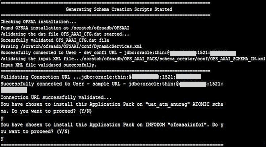

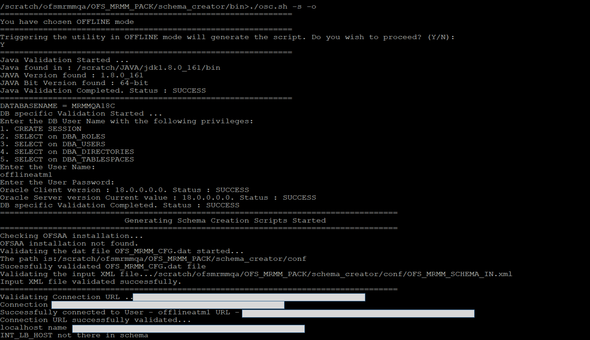

Configure the Schema Creator Utility
Creating database users or schemas (RDBMS) is one of the primary steps in the complete OFS MRMM installation process. The Schema Creator utility enables you to quickly get started with the installation by creating Database User (or Users) or Schema (or Schemas) (RDBMS), assigning the necessary GRANT (or GRANTs), creating the required entities in the schemas and so on.
NOTE:
The Schema creator job needs to be run first, if you are doing MRMM fresh installation in a different infodom. It will append the new artifacts in the existing instance.
Configure and execute the schema creator utility before installing the OFSAA Application Pack.
Topics:
·        Prerequisites
·        Configure Schema Creator Utility for RDBMS Installation
Prerequisites
Ensure you have the following before configuring the Schema Creator Utility:
·        Oracle User ID and Password with SYSDBA privileges
·        JDBC Connection URL for RAC or Non-RAC database
·        The HOSTNAME or IP of the server on which OFSAA is being installed.
·        It is recommended to set the PGA_AGGREGATE_LIMIT database-parameter value sufficiently when Oracle 18c or 19c is installed.
·        You must add a TNS entry before the installation.
·        You must create a directory named ftpshare.

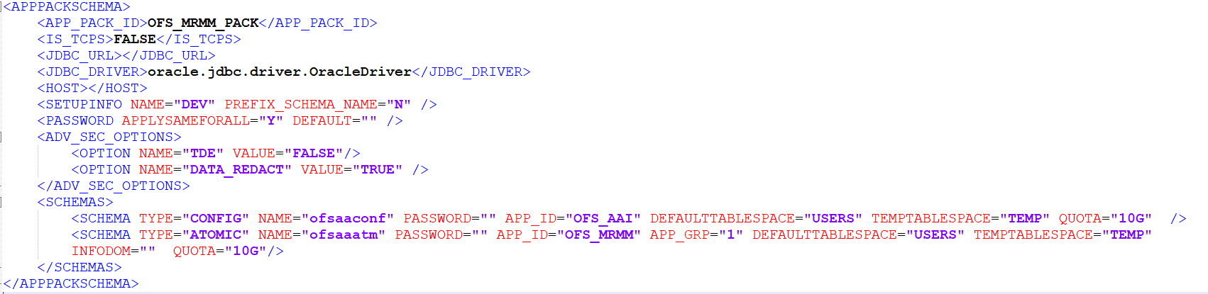

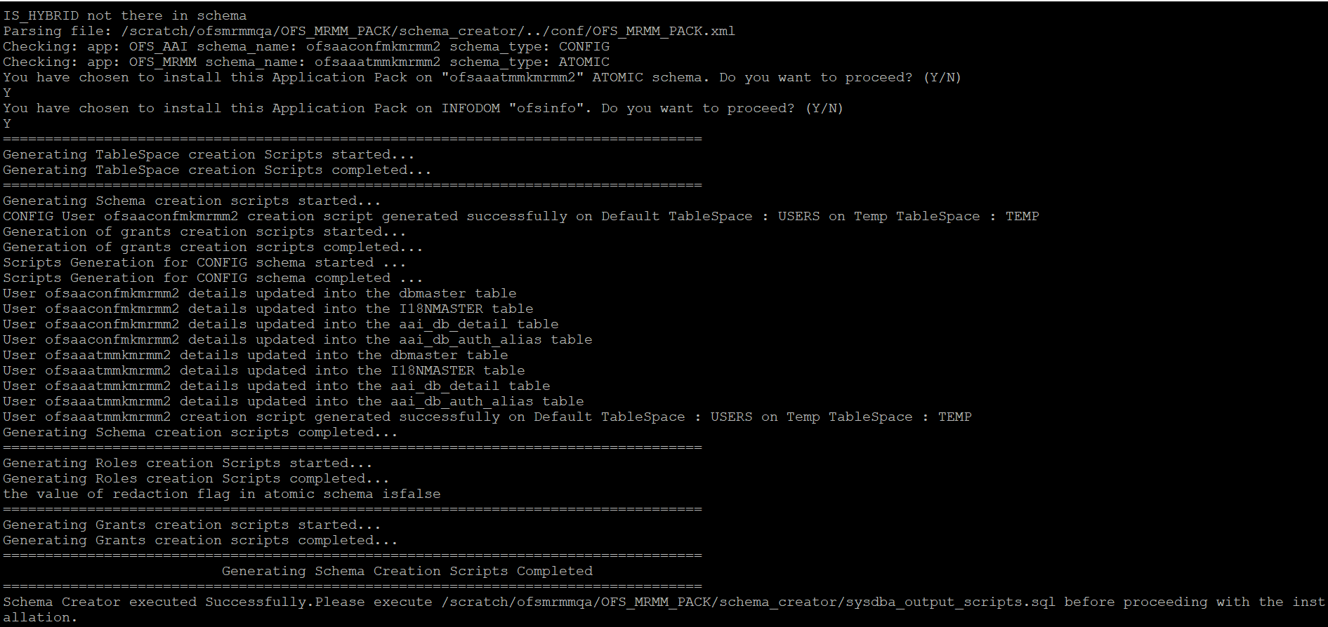

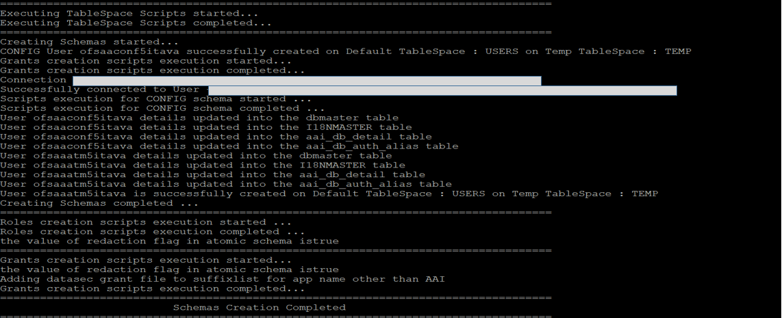

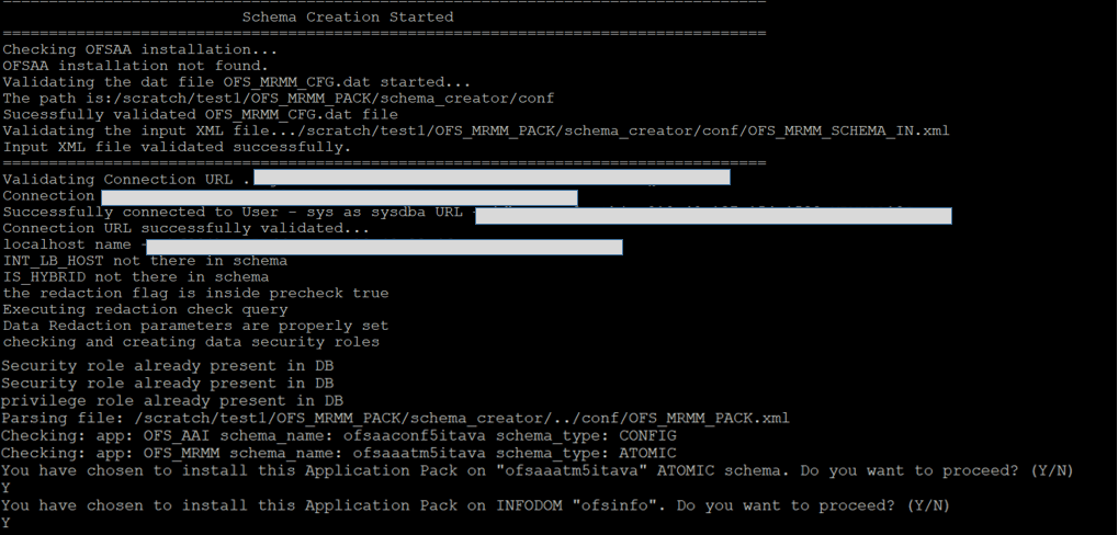

Configure the OFS_MRMM_SCHEMA_IN.xml File
This section describes how to create database schemas, objects within schemas, and assigning appropriate grants.
Specify the database schemas required for the installation in the OFS_MRMM_SCHEMA_IN.xml file. Update the values of the various tags and parameters available in this file before executing the schema creator utility.
This file must be configured only if the database is RDBMS.
To configure the MRMM_SCHEMA_IN.xml file, follow these steps:
1.     Log in to the system as a non-root user.
2.     Navigate to the OFS_MRMM_PACK/schema_creator/conf directory.
Figure 6: Sample OFS_MRMM_SCHEMA_IN.xml File
Description of Sample OFS_MRMM_SCHEMA_IN.xml File follows This illustration shows a sample of the OFS_MRMM_SCHEMA_IN.xml file.
3.     Edit the OFS_MRMM_SCHEMA_IN.xml file using a text editor and configure the values as mentioned in the following table.
4.     Save the file.

Table 20: OFS_MRMM_SCHEMA_IN.xml file Parameters
Description
Mandatory (Y or N)
Default Value or Permissible Value
Comments
<APP_PACK_ID>
Seeded unique ID for the OFSSAA Application Pack
Y
OFS_MRMM_PACK
<IS_TCPS>
Enter if the TCPS configuration is required.
Y
Seeded, with FALSE as the default value.
<JDBC_URL>
Enter the JDBC URL.
NOTE:
You can enter the following JDBC URL type:
1.     RAC or NON-RAC enabled database connectivity URL.
Y
Example:
jdbc:oracle:thin:@< DBSERVER IP/ HOST/ IP>:<PORT>:<SID>
or
jdbc:oracle:thin:@//[HOS T][:PORT]/ SERVICE
or
jdbc:oracle:thin:@(DESCRI PTION=(ADDRESS_ LIST=(ADDRESS=(PROT OCOL=TCP)(HOST=[HO ST])(port=[PORT]))(ADD RESS=(PROTOCOL=TCP) (HOST=[HOST])(PORT=[ PORT]))(LOAD_ BALANCE=yes)(FAILOV ER=yes))(CONNECT_ DATA=(SERVICE_ NAME=[SERVICE])))
For example:
jdbc:oracle:thin:@//dbhos t.server.com:1521/service 1
or
jdbc:oracle:thin:@//dbsho st.server.com:1521/scan-1
or
jdbc:oracle:thin:@(DESCRI PTION=(ADDRESS_ LIST=(ADDRESS=(PROT OCOL=TCP)(HOST=dbhost1.server.com) (port=1521))(ADDRESS=(PROTOCOL=TCP)(HOST=dbhost2.s erver.com)(PORT=1521))( LOAD_BALANCE=yes)(FAILOV ER=yes))(CONNECT_ DATA=(SERVICE_NAME=service1)))
or
jdbc:oracle:thin:/@
Ensure that you add an entry (with SID or SERVICE NAME) in the tnsnames.ora file on the OFSAA server. The entry must match the SID or SERVICE NAME used in the JDBC URL.
Ensure that you have configured the JDBC URL as follows:
jdbc:oracle:thin:/@
<JDBC_DRIVER>
The name of the driver is seeded.
Y
Example: oracle.jdbc.driver.OracleDriver
Only JDBC Thin Driver is supported.
<HOST>
Enter the Hostname or IP Address of the system on which you are installing the OFSAA components.
Y
<SETUPINFO>/PREFIX_SCHEMA_NAME
Identifies whether the value specified in <SETUPINFO>/NAME attribute must be prefixed to the schema name.
N
YES or NO
The default value is YES.
<SETUPINFO>/NAME
Enter the acronym for the type of implementation. This information is displayed in the OFSAA Home Page.
On executing the schema creator utility, this value is prefixed with each schema name. For example: dev_ofsaaconf, uat_ofsaatm.
Y
Seeded, with REG
PREFIX_SCHEMA_NAME="N
Accepts strings with a minimum length of two and a maximum of four.
Example: DEV, SIT, PROD
This message appears in the OFSAA Landing Page as Connected To: xxxx.
The schemas that are created get this prefix. For example, dev_ofsaaconf, uat_ofsaaconf, and so on.
<PASSWORD>/ DEFAULT*
Enter the password if you want to set a default password for all schemas.
You also must set the APPLYSAMEFORALL attribute as Y to apply the default password for all the schemas.
N
The maximum length allowed is 30 characters. Special characters are not allowed.
On successful execution of the utility, the entered password in the OFS_<APP PACK>_SCHEMA_IN.xml file is cleared.
<PASSWORD>/ APPLYSAMEFORALL
If you have entered Y in APPLYSAMEFORALL attribute and also have specified individual passwords for all the schemas, then the specified individual passwords will take precedence.
Y
Default N Permissible: Y or N.
Enter Y if you want to apply the password specified in the DEFAULT attribute for all the schemas.
If you enter N, provide individual passwords for all schemas.
Setting this attribute value is mandatory if the DEFAULT attribute is set.
<SCHEMA>/TYPE
The types of schemas supported in this release are ATOMIC, CONFIG, SANDBOX, and ADDON.
By default, the schemas types are seeded based on the Application Pack.
Y
ATOMIC or CONFIG
Only One CONFIG schema can exist in the file.
Do not edit this attribute value.
This schema identifies as the CONFIGURATION schema that holds the OFSAA setup details and other Metadata information.
Multiple ATOMIC schemas can exist in the file.
<SCHEMA>/NAME
The schemas’ names are seeded based on the Application Pack by default.
You can edit the schema names if required.
The Schema Name will have a prefix of the SETUPINFO/ NAME attribute.
SCHEMA NAME must be the same for all the ATOMIC Schemas of the applications within an Application Pack.
Y
Seeded, with OFSAACONF and OFSAAATM as the default value.
The permissible length is 15 characters and only alphanumeric characters are allowed. No special characters allowed except underscore '_'.
SETUPOINFO/NAME attribute value is prefixed to the schema name being created.
For example, if a name is set as 'ofsaatm' and setupinfo as 'uat', then schema created is 'uat_ofsaatm'.
NAME must be the same where APP_GRP=1 for all SCHEMA tags (Not applicable for this Application Pack).
<SCHEMA>/PASSWORD
Enter the password of the schema to be created.
If this attribute is left blank, then the password specified in the <PASSWORD>/DEFAULT attribute is taken as the Schema Password.
N
It is mandatory to enter the password if you have set the <PASSWORD>/ APPLYSAMEFORALL attribute as N.
<SCHEMA>/APP_ID
The Application ID is seeded based on the Application Pack.
Y
Unique seeded values are:
OFS_AAI
OFS_MRMM
Identifies the Application or Product for which the schema is being created. Do not modify this attribute value.
<SCHEMA>/DEFAULTTABLESPACE
Enter the available default tablespace for DB User.
If this attribute is left blank, then USERS is set as the default tablespace.
N
Seeded, with USERS as the default value.
Any existing valid tablespace name is Permissible.
Modify this value to associate any valid tablespace with the schema.
<SCHEMA>/TEMPTABLESPACE
Enter the available temporary tablespace for DB User.
If this attribute is left bank, TEMP is set as the default tablespace.
N
Seeded, with TEMP as the default value.

Example: The following snippet shows that TDE is enabled and hence the tablespace is shown with encryption ON.
<ADV_SEC_OPTIONS>
<OPTION NAME="TDE" VALUE="FALSE"/>
<OPTION NAME="DATA_REDACT" VALUE="FALSE" />
</ADV_SEC_OPTIONS>
<TABLESPACES>
<TABLESPACE NAME="OFS_AAI_TBSP_1" VALUE="TS_USERS1" DATAFILE="/
scratch/ora19c/app/oracle/oradata/OFSPQA19cDB/ts_users1.dbf" SIZE="500M" AUTOEXTEND="ON" ENCRYPT="ON" />
<TABLESPACE NAME="OFS_AAI_TBSP_2" VALUE="TS_USERS2" DATAFILE="/
scratch/ora19c/app/oracle/oradata/OFSPQA19cDB/ts_users2.dbf" SIZE="500M" AUTOEXTEND="ON" ENCRYPT="ON" />
</TABLESPACES>
<SCHEMAS>
<SCHEMA TYPE="CONFIG" NAME="ofsaaconf" PASSWORD="" APP_ID="OFS_AAI" DEFAULTTABLESPACE="##OFS_AAI_TBSP_1##" TEMPTABLESPACE="TEMP"
QUOTA="unlimited"/>
<SCHEMA TYPE="ATOMIC" NAME="ofsaaatm" PASSWORD="" APP_ID="OFS_AAAI" DEFAULTTABLESPACE="##OFS_AAI_TBSP_2##" TEMPTABLESPACE="TEMP" QUOTA="unlimited" INFODOM="OFSAAAIINFO"/>
</SCHEMAS>

Execute the Schema Creator Utility in Offline Mode
In the Offline mode, the utility generates an SQL script with all the required DDLs for Users, Objects, and Grants. This script must be executed by the DBA on the appropriate database identified for OFSAA usage. If you do not have the SYSDBA privileges, you can execute the Schema Creator Utility in Offline mode and generate the script file that contains the Schemas, Objects, and Grants information. Subsequently, an SYSDBA user can execute the script file manually. To run the OFSAA Application Pack installer in Silent mode, it is mandatory to execute the schema creator utility with -s option.
To execute the utility in Offline mode, you must have a database user with the following GRANTS (alternatively, you can also connect as a user with SYSDBA privileges):
·        SELECT ON DBA_ROLES
·        SELECT ON DBA_USERS
·        SELECT ON DBA_DIRECTORIES
·        SELECT ON DBA_TABLESPACES
·        CREATE SESSION
NOTE:
Explicit Grants to the user are required. Grants assigned through Roles are not supported.
To execute the schema creator utility in the offline mode, follow these steps:
2.     Navigate to the following path: OFS_MRMM_PACK/schema_creator/bin.
3.     Execute the osc.sh file using the following command:
./osc.sh -s -o
4.     The following message is displayed:
You have chosen OFFLINE mode. Triggering the utility in OFFLINE mode will generate the script. Do you wish to proceed? (Y/y or N/n).
5.     Enter Y to proceed.
6.     Enter the DB Username with SELECT privileges.
7.     Enter the User Password.
Figure 7: Schema Creation in Offline Mode
Description of Schema Creation in Offline Mode follows This illustration shows the schema creation triggering in offline mode.
8.     The console runs the initial validation checks and displays the following message:
You have chosen to install this Application Pack on <Name of the Atomic Schema> ATOMIC schema. Do you want to proceed? (Y/N).
Figure 8: Schema Creation in Offline Mode Script Generation
Description of Schema Creation in Offline Mode Script Generation follows This illustration shows the script generation during schema creation in offline mode.
9.     Enter Y to start the script generation. The following message is displayed:
You have chosen to install this Application Pack on <Name of the Infodom>. Do you want to proceed? (Y/N).
Figure 9: Schema Creation in Offline Mode Successful
Description of Schema Creation in Offline Mode Successful follows This illustration shows the successful completion of schema creation in offline mode.
On successful execution of the schema creator utility, the console displays the following status message:
Schema Creator executed successfully. Execute the scratch/ofsaaapp/OFS_MRMM/schema_creator/sysdba_output_scripts.sql file before proceeding with the installation.

Execute the Schema Creator Utility in Online Mode
In Online mode, the utility connects to the database and executes the DDLs for Users, Objects, and Grants. If you have SYSDBA privileges you can execute the Schema Creator Utility in Online mode and thereby create the Users, Objects, and Grants during the execution process. To execute the utility in the Online mode, you must connect as <User> AS SYSDBA.
If you want to run the OFSAA Application Pack Installer in Online mode, it is mandatory to execute the schema creator utility with -s option.
To execute the utility with -s option in online mode, follow these steps:

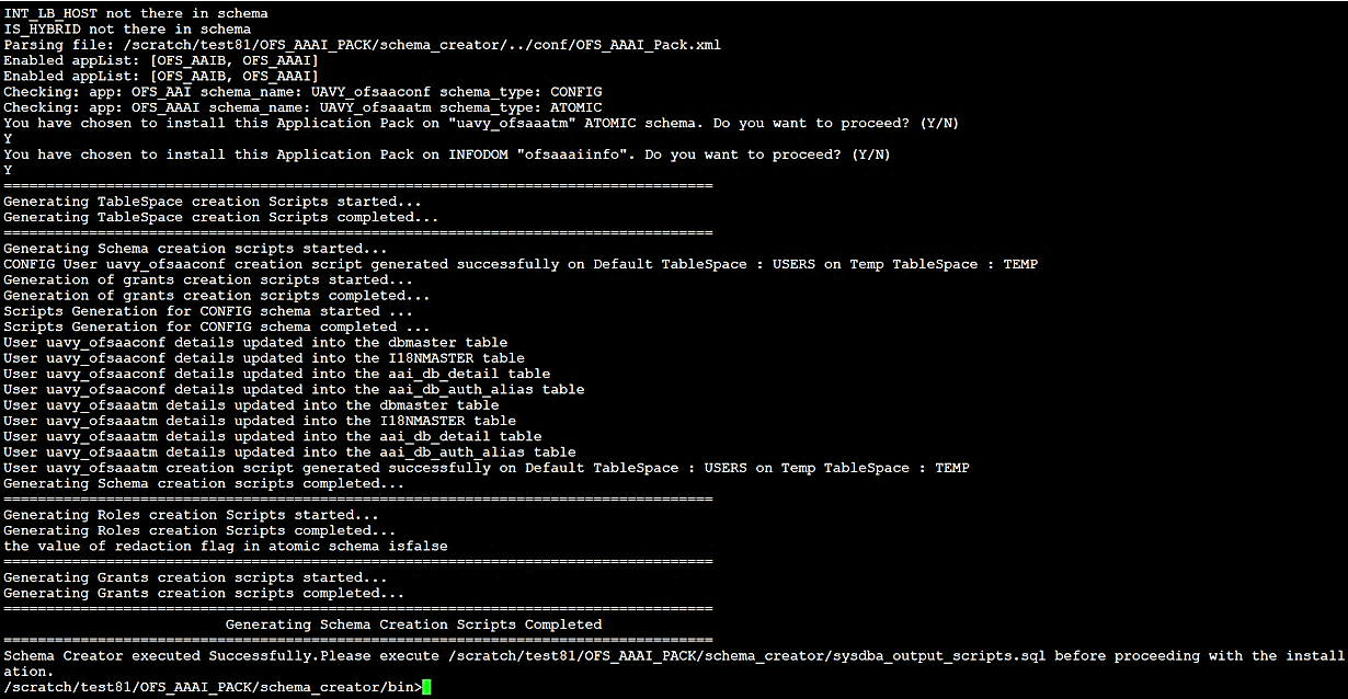

1.     Edit the file OFS_MRMM_PACK/schema_creator/conf/OFS_MRMM_SCHEMA_IN.xml in a text editor. See Configure the OFS_MRMM_SCHEMA_IN.xml File section for values to modify in the XML file.
2.     Execute the utility with -s option. For Example: ./osc.sh -s
3.     Make a TNS entry for the new users created. See Add the TNS entries in TNSNAMES.ORA file. section for details.
Figure 10: Schema Creation in Online Mode
Description of Schema Creation in Online Mode follows This illustration shows triggering of the schema creation in online mode.
You have chosen ONLINE mode. Triggering the utility in ONLINE mode will execute the DDLs directly on the Database. Do you wish to proceed? (Y/y or N/n).
Figure 11: Schema Creation in Online Mode - DDL Execution
Description of Schema Creation in Online Mode - DDL Execution follows This illustration shows DDL execution during the schema creation in online mode.
6.     The following message is displayed:
You have chosen to install this application pack on INFODOM “<INFODOM_NAME>”. Do you wish to proceed? (Y/y or N/n).
7.     Enter Y to proceed.
Figure 12: Schema Creation in Online Mode - Infodom Confirmation
Description of Schema Creation in Online Mode - Infodom Confirmation follows This illustration shows infodom confirmation during the schema creation in online mode.
8.     After Schema creation is successful, proceed to Configure the OFSAAI_InstallConfig.xml File section.
Figure 13: Schema Creation in Online Mode -Successful
The result of this task is that the OFS_MRMM_SCHEMA_OUTPUT.XML file is generated. Do not modify this file.

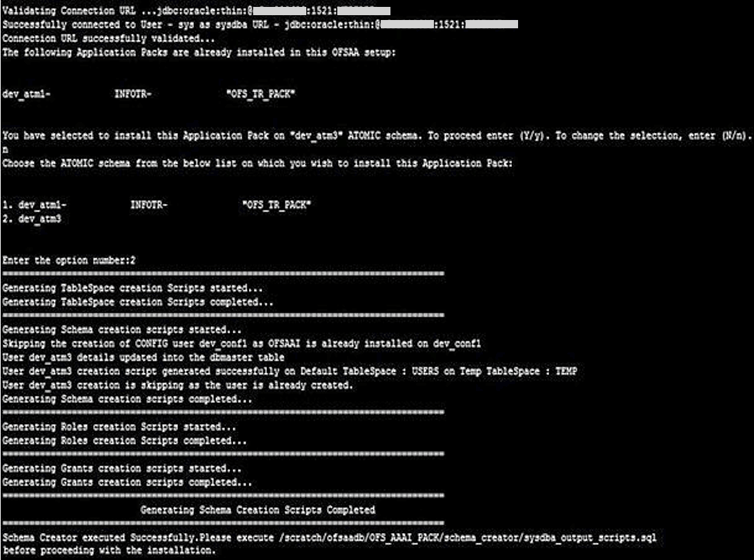

4.     The utility identifies the Application Packs that are already installed on the current OFSAA setup and displays the following on the console:
§       Atomic schema of the existing Application Pack
§       Information Domain Name of the existing Pack
§       List of Installed Application Packs
Figure 16: Install Subsequent Applications Pack- Select Atomic Schema and Infodom
Description of Install Subsequent Applications Pack- Select Atomic Schema and Infodom follows This illustration shows selection of the Atomic schema and infodom during the schema creation to install subsequent applications packs.
5.     Enter Y or y to start the schema creation.
6.     If you enter N or n, the list of Atomic Users is displayed.
7.     Select the Atomic User on which you want to install the Application Pack.
8.     Make a TNS entry for the new users created. For details, see Add TNS entries in tnsnames.ora File section.
Figure 17: Install Subsequent Applications Pack- Select Atomic Schema and Infodom
On successful execution of schema creator utility, the console displays the following status message:
Success. Please proceed with the installation.

7.     Navigate to the path OFS_MRMM_PACK/conf/OFS_MRMM_PACK.xml, and enter YES in the enable tag for OFS_MRMM, OFS_AAI, and OFS_AAAI.
8.     Edit the OFS_MRMM_PACK/schema_creator/conf/OFS_MRMM_SCHEMA_IN.xml file to set the appropriate attribute values. Include INFODOM = “<Infodom Name>” in OFS_MRMM_SCHEMA_IN.xml file
9.     Execute the schema creator utility with -s option. This step is mandatory and should be executed before every OFS MRMM Application Pack installation.

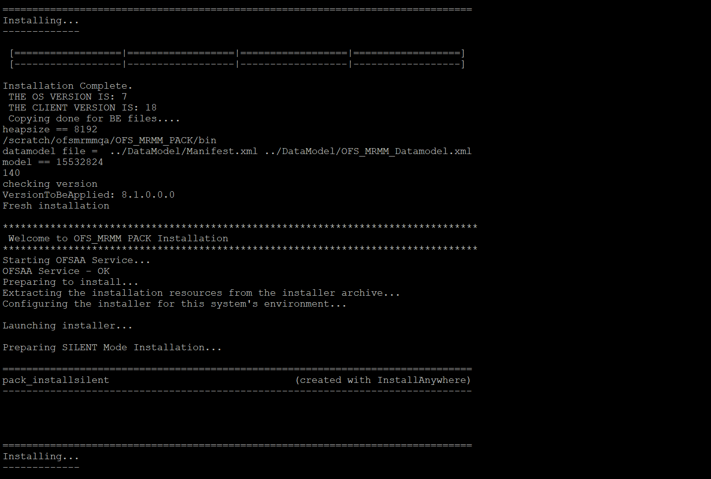

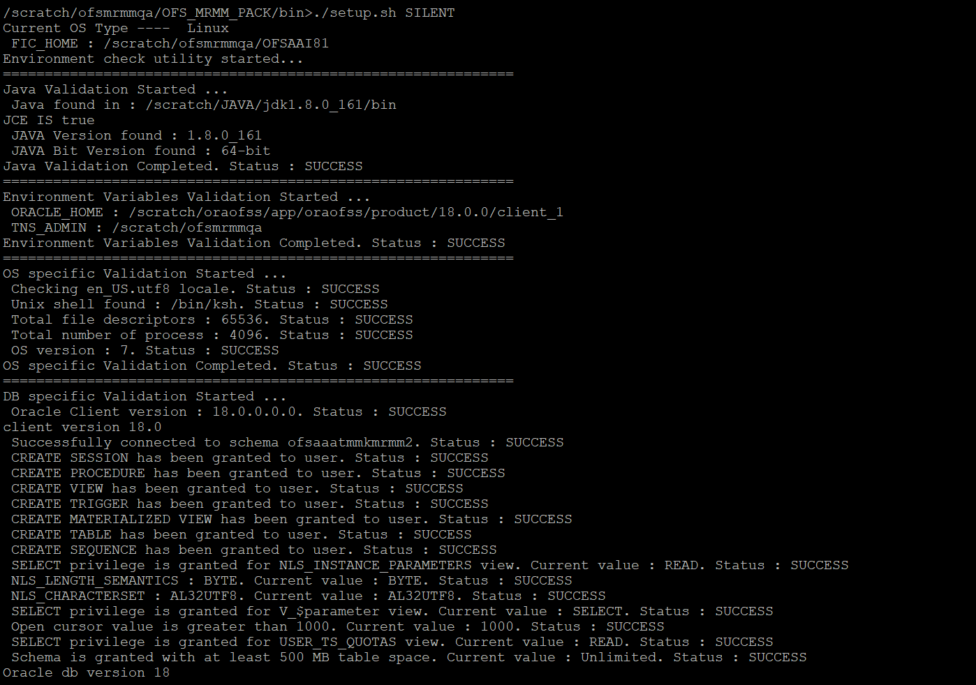

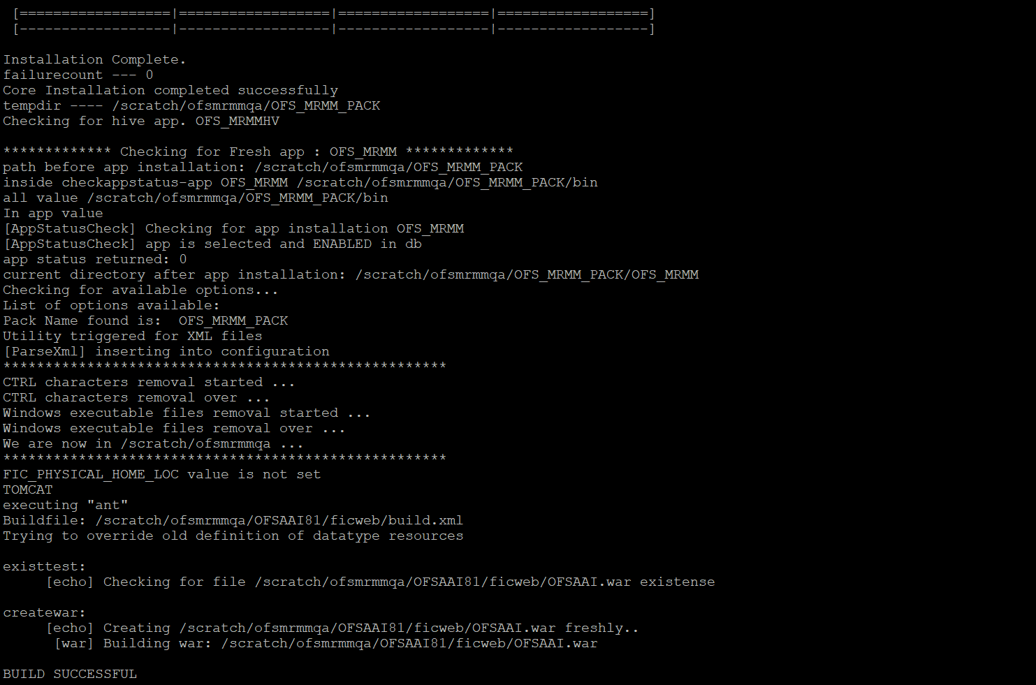

12.  Enter the following command in the console to execute the application pack installer with the Silent option.
./setup.sh SILENT

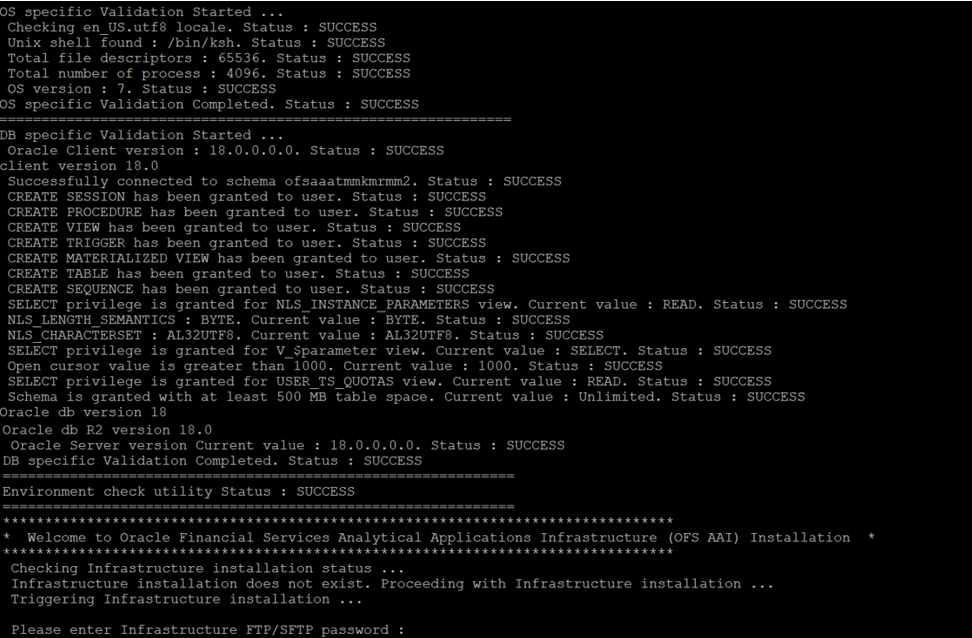

13.  The installer proceeds with Pre-Installation Checks.
Figure 18: Silent Mode of Installation
Description of Silent Mode of Installation follows This illustration shows triggering of the installation in silent mode.
14.  Enter the OFSAA Processing Tier FTP/SFTP password value and proceed, when prompted in the command prompt.

15.  The process displays the OFSAA License. Enter Y and proceed.
Figure 20: Accept the OFSAA License Agreement
Description of Accept the OFSAA License Agreement follows This illustration shows the OFSAA License Agreement prompt during the installation.
16.  The installer installs the OFSAAI application.
Figure 21: OFSAA Silent Mode Installation
Description of OFSAA Silent Mode Installation follows This illustration shows the OFSAA silent mode installation.
17.  After the platform is installed, the OFS MRMM installation begins.
NOTE:
SYSADMN and SYSAUTH are the two default OFSAAI administrative users created.
Figure 22: MRMM Silent Mode Installation
Description of MRMM Silent Mode Installation follows This illustration shows the OFS MRMM installation.
18.  After Data Model Upload is complete, verify the installation logs in the locations mentioned in the Verifying the Log File Information section.
Figure 23: Silent Mode Installation in Progress
Description of Silent Mode Installation In Progress follows This illustration shows the OFS MRMM installation.
Figure 24: Silent Mode Installation Complete
This illustration shows successful completion of the OFS MRMM installation.
19.  After successful MRMM pack installation, the WAR file is generated, and all the servers are verified and the installation complete message is displayed.
20.  The OFSAA Infrastructure installation performs a post-install health check automatically on the successful installation of the product.
Congratulations! Your installation is complete.
21.  On completion of the installation, verify the installation log files. For more information, see the Verifying the Log File Information section.
