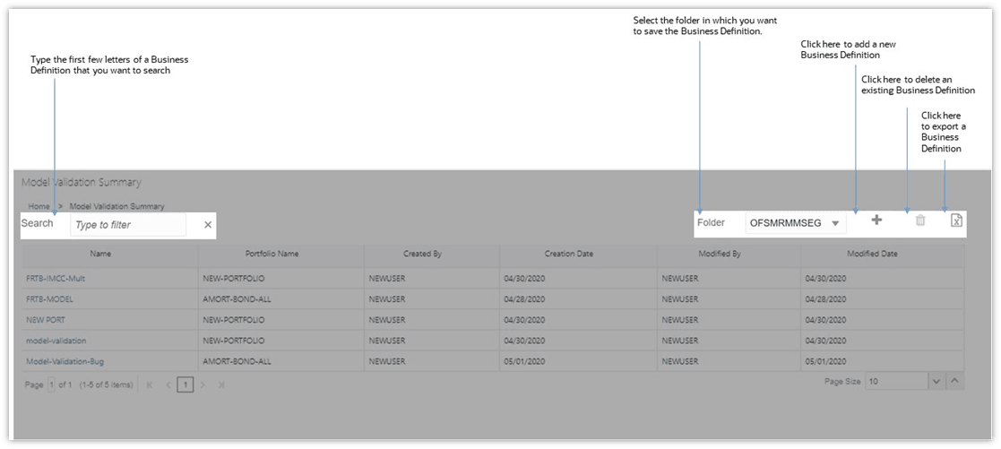

From the MRMM Home page, select Market Risk Measurement and Management, click Navigation Menu
, select Model Validation.
Figure 47: Model Validation Summary Window
In the Search field, type the first few letters of the business definition name that you want to search. The summaries whose names consist of your search string are displayed in a tabular format.
Figure 48: Model Validation Summary Window - Search Box
From the breadcrumb on top, click the Model Validation Summary link to return to the summary window after viewing details of the business definition.

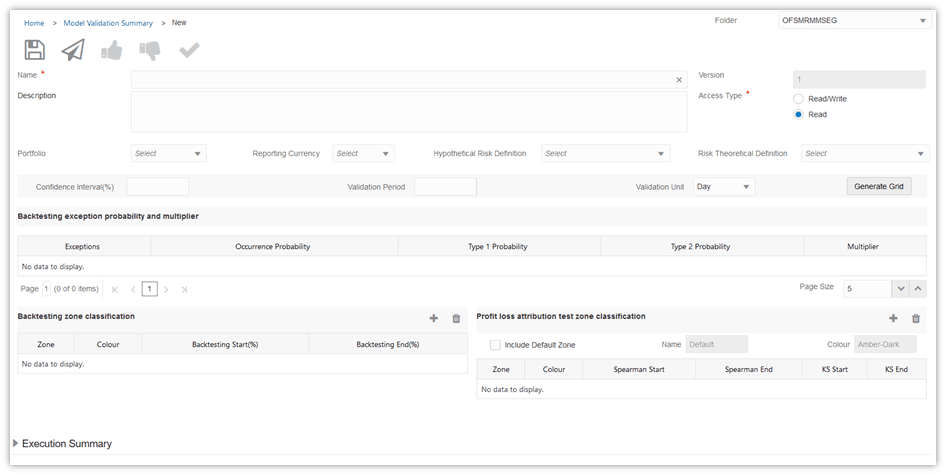

To define a new Model Validation - business definition, follow these steps:
1. In the Model Validation Summary window, click Add
. The definition window is displayed.
Figure 49: Model Validation Definition Window
2. Populate the details mentioned in the following table. Fields marked in red asterisk (*) are mandatory.
Fields |
Description |
Name* |
Enter the name of the business definition. |
Description |
Provide a description of the business definition. |
Version |
Displays the workflow version of the business definition. |
Access Type |
Specify the access type |
Folder |
Select the folder. |
Portfolio |
Select the Portfolio from the drop-down list. |
Reporting Currency* |
The currency in which all the output for a given definition will be computed. Select the currency code from the drop-down list. |
Hypothetical* |
Select the business definition created in the module Market Risk - Historical Simulation, to be considered for Hypothetical from the drop-down list. Actual and Hypothetical P&L are computed using business definitions selected for Hypothetical. Actual P&L is the difference in portfolio value as of time t and time t-1, where t is any specified historical date. Additionally, Actual P&L incorporates the change in instrument data for calculating P&L. Actual P&L is available as a download in this release. Populate data into the stage table STG_MR_PORTFLO_ACT_PNL_VALUE. Hypothetical P&L for time t is the difference in portfolio value computed with market data as of time t and instrument data as of time t, and, portfolio value computed with market data as off time t+1 and Instrument data as of time t. Hypothetical P&L is available as a download in this release. Follow the below process to upload portfolio values to be considered for model validation: Populate data into the Fact table FCT_MR_PORTFOLIO_VALUE. NOTE: During execution, in the Date editor if you select the option Load Data from Stage Tables, then input is taken from these two tables. See the OFS MRMM Download specification document available in OHC Documentation Library for the column details in the FCT_MR_PORTFOLIO_VALUE table. |
Risk Theoretical* |
Select the definition to be considered for Risk Theoretical from the drop-down list. Populate data into the Fact table FCT_MR_PORTFOLIO_VALUE table. NOTE: During execution, in the Date editor if you select the option Load Data from Stage Tables, then input is taken from these two tables. This is the P&L calculated by the risk factors generated from the pricing models of the trading desk. Risk Theoretical P&L is available as a download in this release. |
Confidence Interval |
Confidence is the percentage value that you need to define the VaR numbers. Specify the confidence value required for calculating the output. |
Validation Period |
Specify the period of validation. |
Validation Unit |
Specify the validation unit from the drop-down list, whether Day, Month, or Year. |

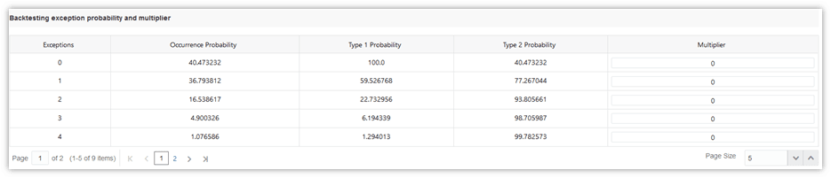

3. Click Generate Grid. A table is generated with the field columns mentioned in the following table.
Figure 50: Backtesting Exception Probability and Multiplier
Fields |
Description |
Exception |
Displays the exceptions. This is the auto-populated number of exceptions starting with 0 and will keep on increasing |
Occurrence Probability |
Displays the exact probability of obtaining the corresponding number of exceptions. |
Type 1 Probability |
Probability of rejecting model (Type 1): This is a system computed column. Type 1 is the probability that using a given number of exceptions as the cut-off for rejecting a model will imply the rejection of an accurate model. Column is reverse-cumulative of Probability of occurrence (Column 2) starting with 100%. |
Type 2 Probability |
Probability of accepting model (Type 2): This is a system computed column. Type 2 is the probability that using a given number of exceptions as the cut-off for rejecting a model will imply acceptance of an inaccurate model Column is cumulative of Probability of occurrence (Column 2) starting from 0%. |
Multiplier |
Displays the multiplier value/multiplication factor for the capital which is sufficient to return the model to a 99th percentile standard. |

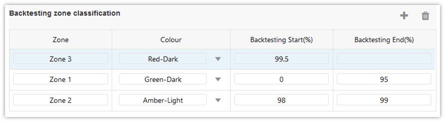

4. In the Backtesting Zone Classification pane, follow these steps:
a. Click Add
Figure 51: Backtesting Zone Classification
b. Specify details for the fields Zone, Color, Backtesting Start percentage, and Backtesting End percentage, as explained in the following table.
c. Click Delete
to remove an entry.
