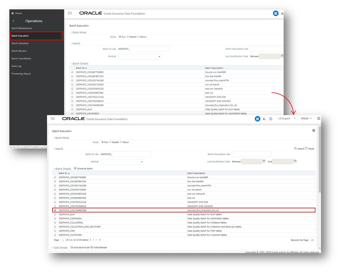

To execute the batch for T2T in the Batch Execution page.
1.      Navigate to the Batch Execution page and select the required Batch ID:
§        <INFODOM>_EXE_RUN for the Result table that consists of Run SKey.
§        <INFODOM>_SOURCED_RUN for the Result table that does not consist of Run SKey.
NOTE
For a detailed procedure, see Execute the SCD batch.

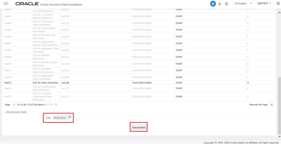

2.      Exclude/Include tasks from/into the T2T batch.
A summary of the steps is shown in the following screenshots. For a detailed procedure, see Exclude/Include tasks from/into the SCD batch.
3.      Select the FIC_MIS date. To execute the T2T batch, click Execute Batch.
