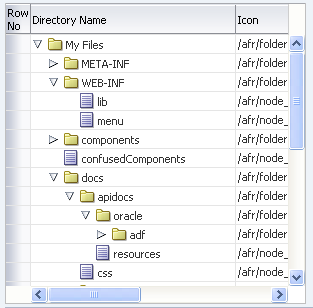

The TreeTable is used to display data that is structured in a hierarchical format. This component displays a hierarchy in a UI similar to a Table, and is more elaborate than the Tree component. TreeTable supports displaying columns of data per tree node in the hierarchy. The features of the TreeTable include mechanisms for focusing in on subtrees (within the main tree), as well as expanding and collapsing elements in the hierarchy.
Because of this stamping behavior, some components may not work inside the treeTable. Most components will work without problems, for example any input and output components. If you need to use multiple components inside a cell, you can wrap them inside a panelGroupLayout component. Components that themselves support stamping are not supported, such as treeTables within a treeTable or region within a treeTable.
The TreeTable component uses a model to access the underlying hierarchical data. The specific model class is org.apache.myfaces.trinidad.model.TreeModel. There is a utility class available that wraps a Java List of beans or maps in an implementation of the org.apache.myfaces.trinidad.model.TreeModel (See org.apache.myfaces.trinidad.model.ChildPropertyTreeModel).
Like the Table, the TreeTable's children must be Column components (see Table Columns). Like the Tree, the TreeTable has a "nodeStamp" facet which renders the "Object Name" Column. The "Object Name" Column contains the primary identifier of an element in the hierarchy. For example, in an organization chart of employees, the "Object Name" Column might be the employee name.
