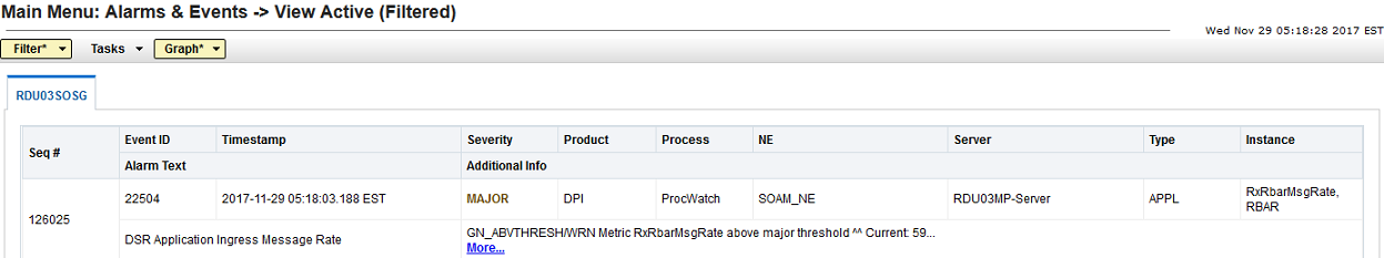

  1. Examine the alarm log from Main Menu > Alarms & Events on Active SOAM Server.
  2. Average Ingress Message rate utilization on a MP Server of the DSR Application is exceeding or approaching engineering traffic handling capacity.
