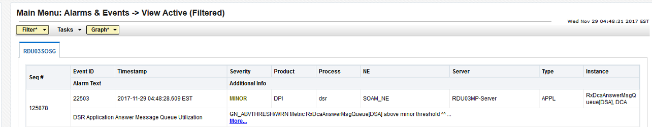

  1. Examine the alarm log from Main Menu > Alarms & Events on the active SOAM server.
  2. This alarm should not occur when no other congestion alarms are asserted.
