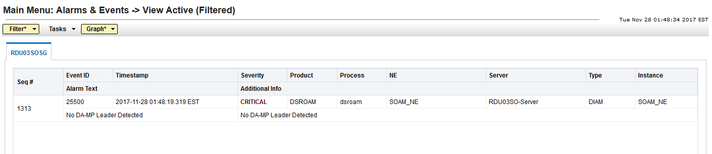

  1. Examine the alarm log from Main Menu > Alarms & Events on Active SOAM Server.
  2. This alarm is raised against the Network Element when no DA-MPs report themselves as Leader.
