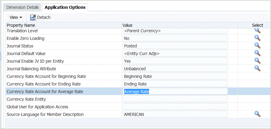

  3. After defining the application details in Application Detail, select the Application Options tab.
  4. Specify the account names in the following fields:
    • Currency Rate Account for Beginning Rate
    For information about working with other application options, see Registering Target Applications.
    Image shows Application Option screen
