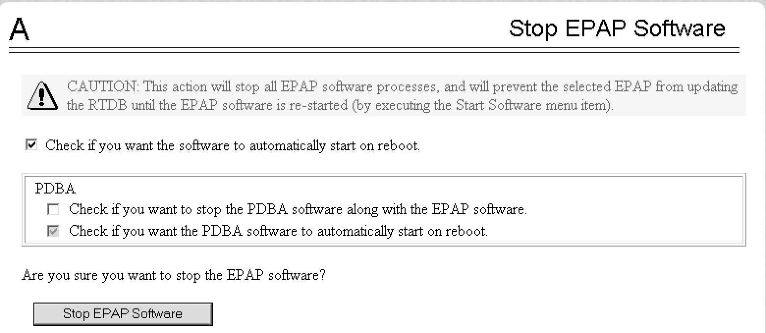

  3. From the EPAP Menu, select Process Control>Stop Software.
  4. In the Stop EPAP Software screen as shown in Figure 3-1, click Stop EPAP Software.
    DO NOT select the option to stop the PDB along with the EPAP software.
    Figure 3-1 Stop EPAP Software
    Stop EPAP Software

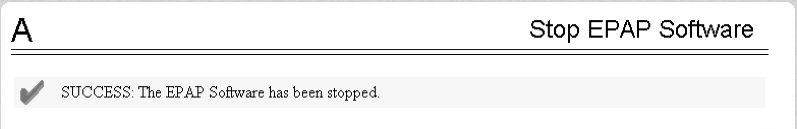

    After the EPAP software has stopped successfully, the screen shown in Figure 3-2 is displayed.
    Figure 3-2 EPAP Software Successfully Stopped

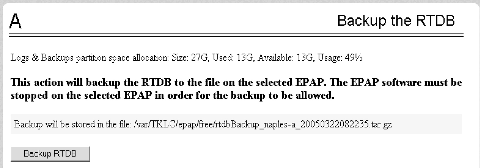

  5. From the EPAP menu, select RTDB>Maintenance>Backup RTDB.
    The screen shown in Figure 3-3 is displayed.
    Figure 3-3 Backup the RTDB
    Backup the RTDB
  6. Record the file name as shown in this example:
    /var/TKLC/epap/free/rtdbBackup_naples-a20050322082516.tar.gz
  7. Click Backup RTDB.

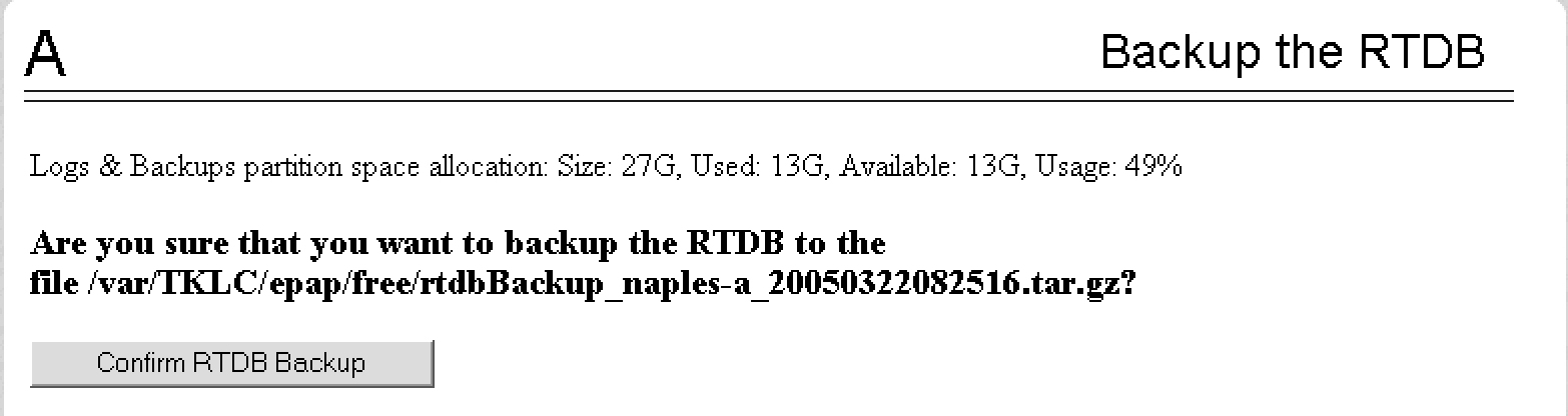

    The screen shown in Figure 3-4 displays a request for confirmation.
    Figure 3-4 Backup the RTDB Confirmation
  8. Click Confirm RTDB Backup.

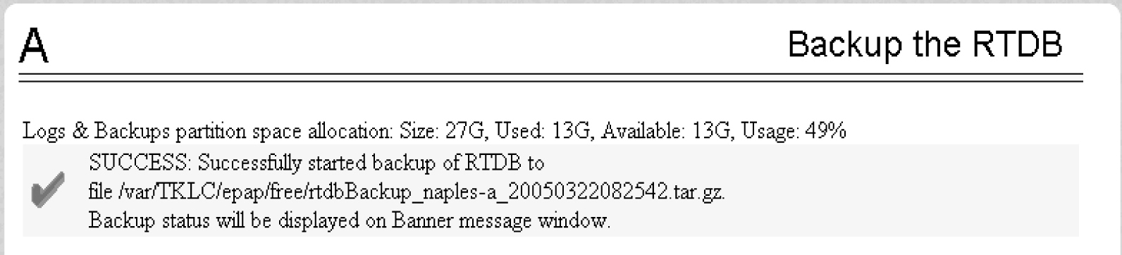

    After the backup completes successfully, the screen shown in Figure 3-5 is displayed.
    Figure 3-5 Backup the RTDB - Success

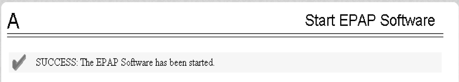

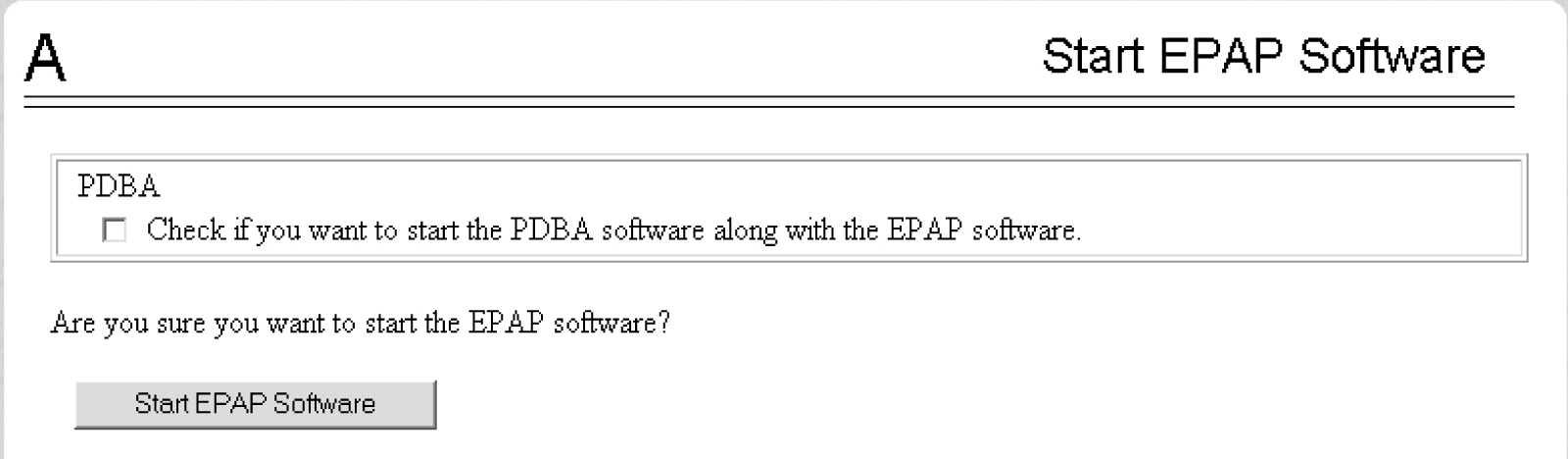

  9. Select Process Control>Start Software from the EPAP Menu.
  10. On the Start EPAP Software screen shown in Figure 3-6, click Start EPAP Software.
    Figure 3-6 Start EPAP Software
    Start EPAP Software
    After the EPAP software has started successfully, the screen in Figure 3-7 is displayed.
    Figure 3-7 Start EPAP Software - Success
