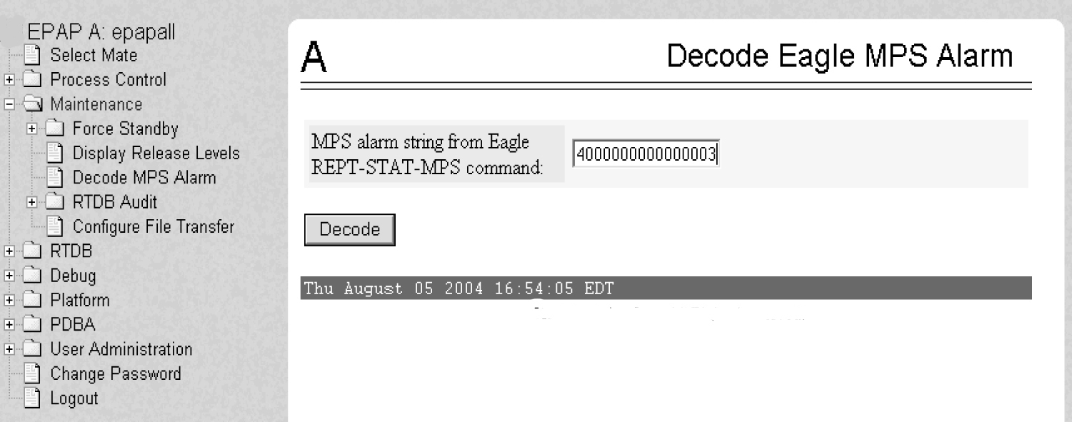

  1. Log in to the User Interface screen of the EPAP GUI (see Accessing the EPAP GUI).
  2. After logging in to the EPAP, select Maintenance>Decode MPS Alarm from the menu.
  3. Enter the 16-digit alarm string into the window on the Decode MPS Alarm screen, as shown in Figure 3-21.
    Figure 3-21 Decode MPS Alarm Screen
  4. Click the Decode button.

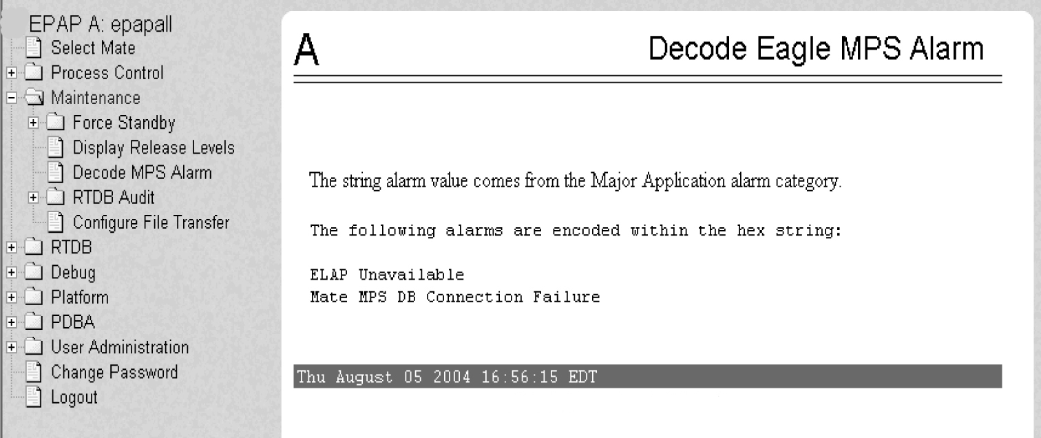

    The system returns information on the Alarm Category (Critical Application, Major Platform) and error text, as shown in Figure 3-22.
    Figure 3-22 Decoded MPS Alarm Information
  5. Find the alarm text string shown on the GUI in Alarm Categories. Note the corresponding alarm number change. Perform procedure Determine Alarm Cause.
